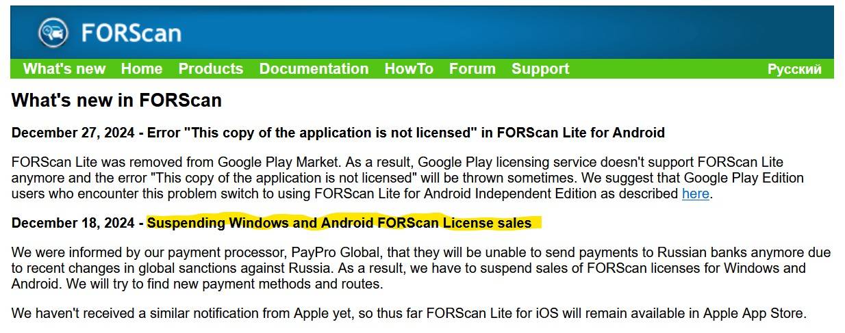

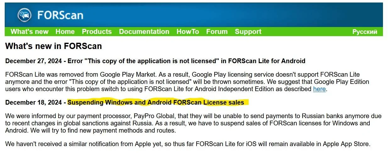

Can I use FRDS to tweak settings like WAL etc without having to use FORScan? I know FRDS has $50 2 day license fee, does FORscan also need license?
With FORScan you have a 2-month trial period.
You cannot currently purchase a license, and it's all there on their website.
https://forscan.org/
Just guessing, but them getting out of Ukraine would resolve this.

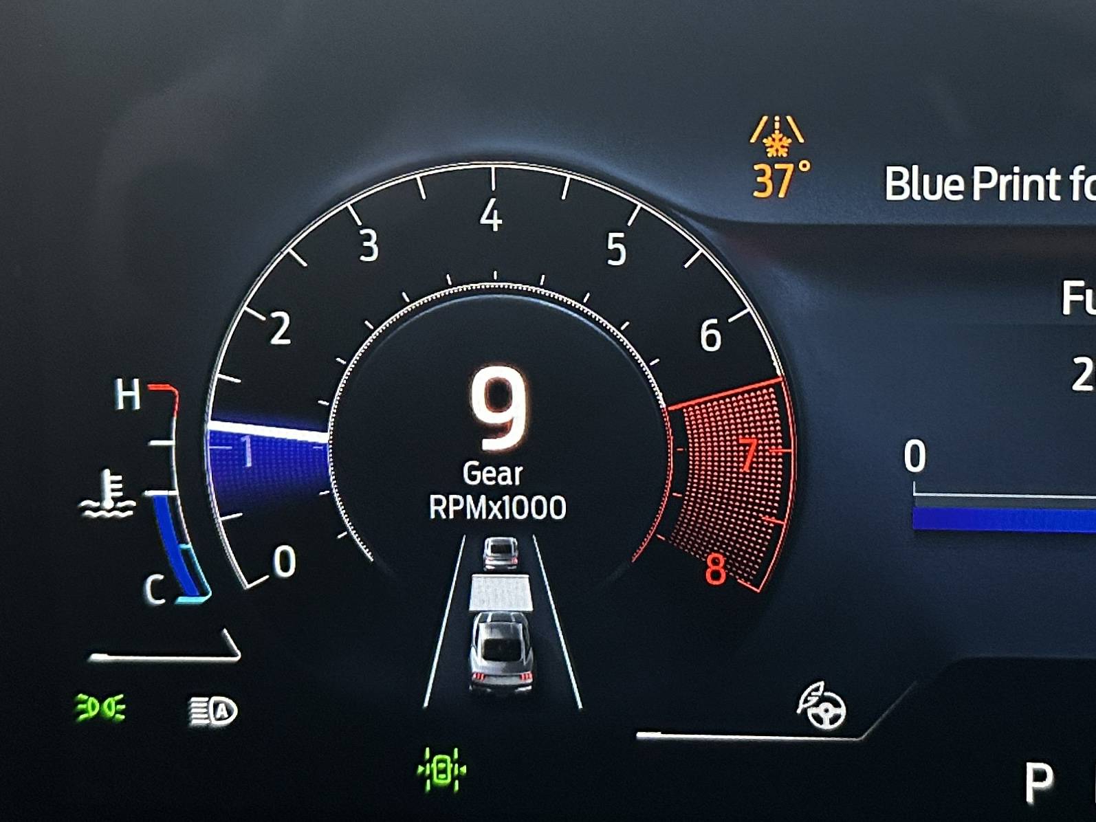

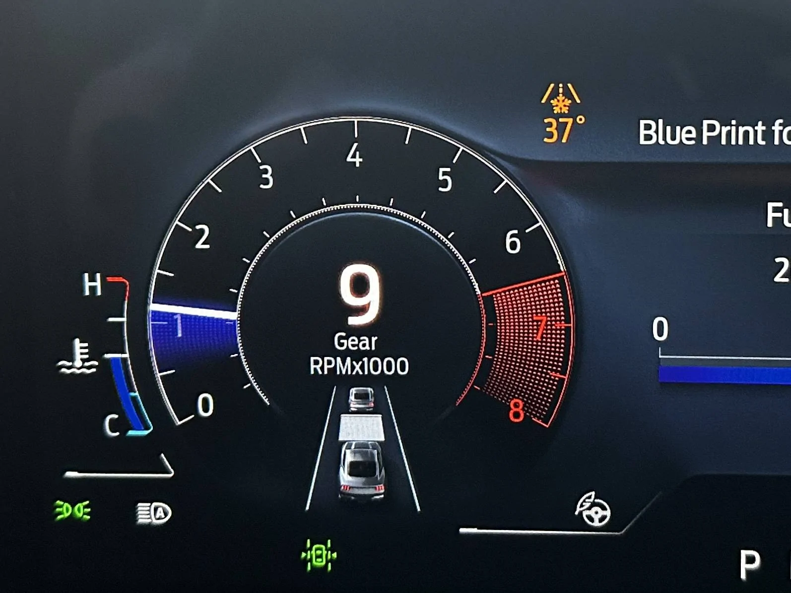

i want to sanity check something here. i enabled "frost telltale" on my Mustang with FORScan, and this morning on the way to autocross i finally saw it in action. but im not sure if what i did actually enabled it or not. to those in colder climates, can you comment on whether or not you have seen this icon when its below 40F/4C?
I can confirm that frost telltale works after enabling it. It’s a nice little feature, don’t know why it’s disabled by default. It comes on below 40°F, there’s no audible alarm, just this unobtrusive yellow symbol. I think it’s great!
