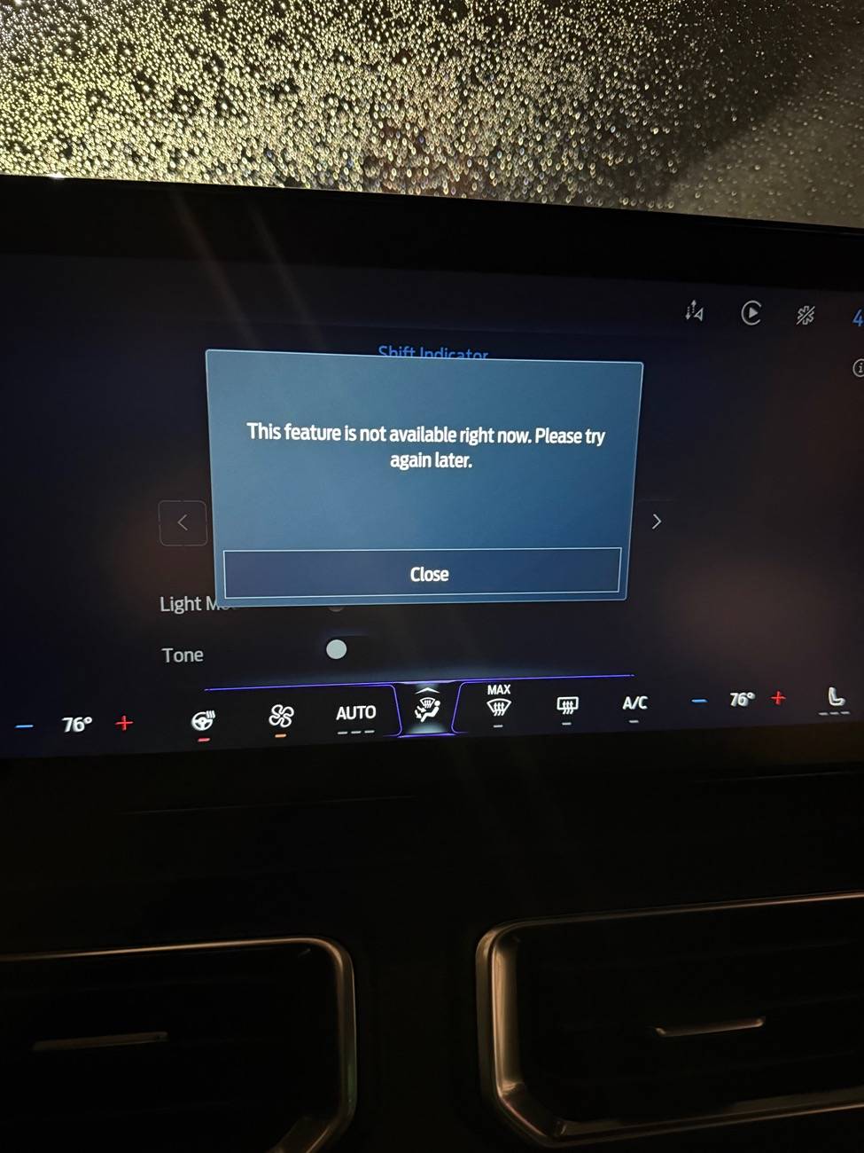

Hey @roket , I did the performance shift indicator in forscan. Like you said, IPC and APIM, shift indicators. The ones that said “upshift” and “downshift” for manual only I obviously didn’t touch, and now it’s on my screen, but when I go to use it, it says feature is unavailable, any help?

looks like you did not enable the correct stuff in the IPC. try doing it the standard way through the as-built data. in the IPC page of the spreadsheet, activate the two entries that respond to the search "performance shift"

Honestly, there’s so many things in there and it’s very rough to see which number it is that needs to be changed. I’m sure I can figure it out but, if you have a chance, provide screenshots of your APIM and IPC that you changed for it. I looked it up in IPC And there’s 3 options. “Shift indicator, upshift indicator (MANUAL ONLY), downshift indicator (MANUAL ONLY)”. I changed the ones that don’t say manual only. Unless I was supposed to do them all, not sure.

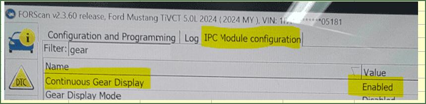

Looking for some help on the Continuous Gear Display option on my base EcoBoost (101A).
Added a steering wheel with paddle shifters since mine did not have them from the factory. Was able to turn on "Select Shift" and get the paddles working (L mode now does not highlight when selected, and it behaves like M mode would), but have not been able to get the continuous gear display working.
Interestingly enough, when I went to edit the IPC Module my As-Built already had CGD "Enabled," but nothing is showing on the dash. I tried disabling and then enabling in "easy mode," and have likewise tried editing the HEX value back and forth from C to E. Neither process is working. Any suggestions?
