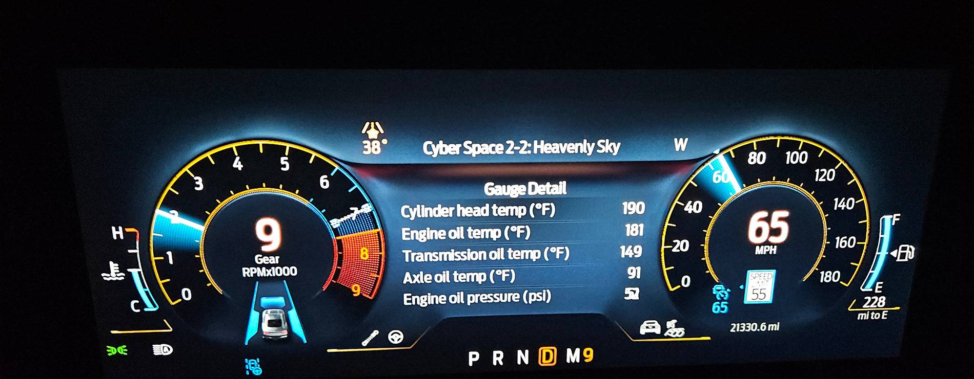

if you go into the easy mode IPC editor, just search for "frost telltale"

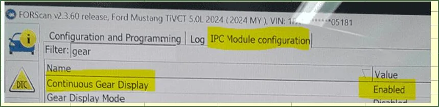

Is there a way to see what might be available in the Easy Mode without connecting to the car ? I had a friend add Gear Disp to Tach, but trying to decide to use Forscan for more.
2,716
4,123
not really. most things are in easy mode, but not all of them. continuous gear display is in there i know

Yes, that's why I was asking, just a simple answer: enable or disable, and no spread sheet with multiple codes.
then yes, its in there. and yes, it is a simple on or off setting. however, some things in the easy menu have multiple options that are like "range 1", "range 2", "range 3", "range 4" such as the tachometer
