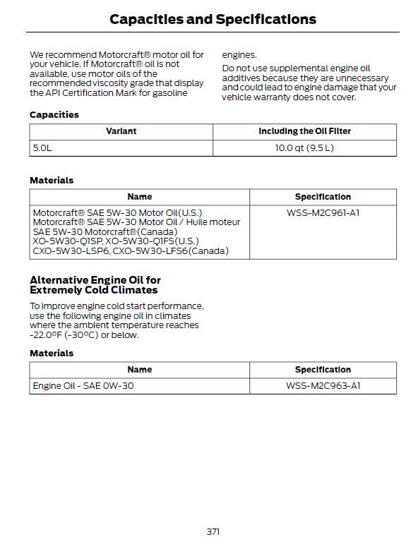

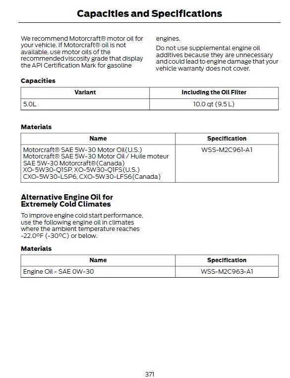

These are the API specifications supporting WSS-M2C961-A1 (from the 2024 Owners Manual). While these standards list the tests and requirements, they do not specify the type of oil (dino, blend, synth) to be used, only its properties.

From page 371 in the owners manual...

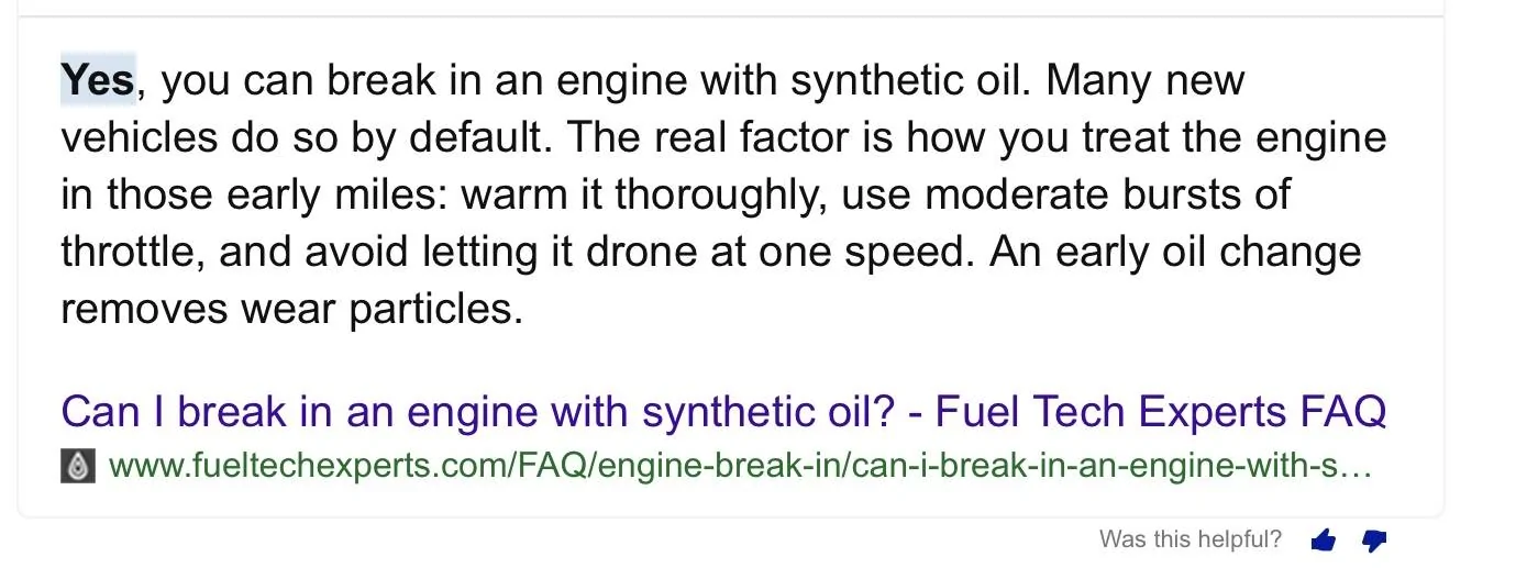

I looked this thread up because I was curious what OEM fill was in case I had to add before first oil change.
I always thought that full synthetic isn’t used in many cases for break-in, because it doesn’t allow the necessary wear on a microscopic level that break-in needs.
Turns out that is a myth and supposedly many cars come with synth from the factory???

I don’t know. Like I said, I always thought synthetic oil was not recommended for break-in. I tried to find actual examples of which car manufacturer puts synthetic in at the factory. I couldn’t find an example. So if there is, it would take too long to find out.
These ā€œexpertā€ websites are a dime a dozen and most are probably AI created. It’s really hard to wade through all the BS the internet provides. I guess either it’s true but not able to be easily verified, or I got suckered into a BS Google answer.
