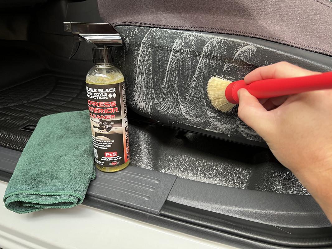

A couple of products to get you started.......................
Interior Cleaner - I'd dare say most who have a Mustang never get to the point where a full-on interior cleaner is needed, other than periodic leather cleaning. Still worth having though. P&S Xpress and Griots Interior Cleaner leave no residue after use, and certainly don't leave a glossy finish as they are pure cleaners.
Interior Cleaner - Safe & Effective - Griot's Garage (griotsgarage.com)
P&S Detail Products - Xpress Interior Cleaner | The Rag Company
S650 Mustang What cleaners (chemicals) are you folks using to clean the interior of your Mustang? IMG-1289

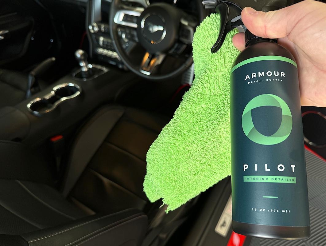

Interior Detailer - this is what you would use the most, great for a quick wipe over between more serious cleaning and can be used on leather, plastic, vinyl, screens, or any hard surface. These are what I use after every wash applied into a towel, then wiped over the surfaces I want to refresh. They then flash away leaving no residue, streaking or greasiness, just a matte OEM look.
These also contain some UV protection, so you eliminate having another product to buy and apply such as 303. I've actually stopping using a dedicated interior protectant for this reason. Carpro InnerQD and Armour Detail Supply Pilot are my favorites, but the Megs Quick Interior Detailer is great too. If I was buying right now, it would 100% be Pilot, its so lush.
ARMOUR DETAIL | Pilot - Interior Detailer – Car Supplies Warehouse
CARPRO | Inner QD Interior Quick Detailer – Car Supplies Warehouse
S650 Mustang What cleaners (chemicals) are you folks using to clean the interior of your Mustang? IMG_0985

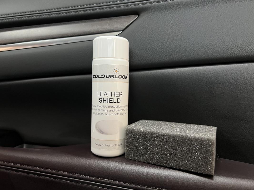

Leather - I'm pretty anal when it comes to leather because I absolutely detest slick, shiny leather. Clean and protected leather should be matte in finish, dirty leather is in fact shiny, so why people slather leather with oils and greasy lotions is beyond me. You also need products that can actually penetrate the PU (basically clear coat for leather) coating they use on automotive leather and vinyl.
Anyway, this is what I'm using.....................
In your case, clean using P&S Xpress, which is pH neutral and completely safe on leather. I love how it lathers up with agitation, then wipes away clean and clear. Considering you are dealing with brand new leather, I would then treat it with ColourLock Leather Shield. This is used to protect the leather from dye transfer and abrasion while the leather is still "young". After the 3-year mark, you then transition to ColourLock Leather Protector. Even if these two look shiny when first applied, what I love about these products is how the dry to a soft, dry and matte finish. You would reapply either every 6 months or so. Then just maintain with the interior detailer. ColourLock only deal with leather, so they are well honed on the subject. Expensive, but a little goes a long way.
COLOURLOCK Leather Shield (carpro-us.com)
Leather Shield | 150 ml | 11012-us (colourlock.com)
Leather Protector | 150 ml | 11010-us (colourlock.com)
COLOURLOCK Leather Protector (carpro-us.com)
S650 Mustang What cleaners (chemicals) are you folks using to clean the interior of your Mustang? IMG_4205

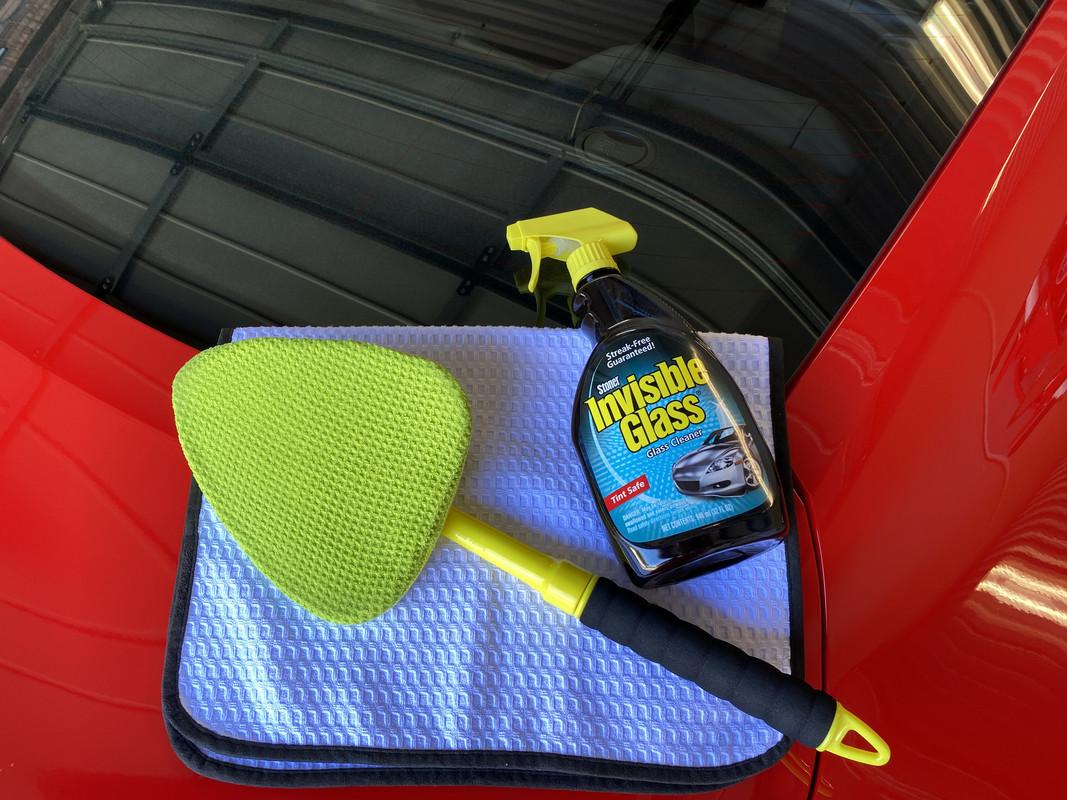

Glass - so many glass cleaners to chose from, Gyeon Q2M Glass Cleaner, Stoner Invisible Glass or P&S True Vue are my picks. All safe for tint. Considering the steep angle of the rear windscreen, you definitely need the Reach and Clean Tool.
P&S Detail Products - True Vue Glass Cleaner - RTU | The Rag Company
Gyeon Q2M Glass | Car Supplies Warehouse – Car Supplies Warehouse
Invisible Glass Trigger
Stoner Invisible Glass Quick Change Reach & Clean Tool | Car Supplies Warehouse – Car Supplies Warehouse
S650 Mustang What cleaners (chemicals) are you folks using to clean the interior of your Mustang? feb2192
