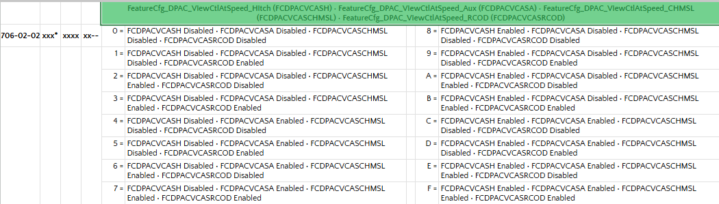

If you ever try it, you will need to enable RCOD view at speed here in the IPMA:
appreciate it! I definitely plan on it. Id just need to find where to wire it cause I have zero idea at the moment 🤣

I don't see why not. Below is what he told me when I asked about it:
"Its basically a ground.. All they need to do is ground that pin.. it doesnt have to be the factory camera button.. any momentary switch would work."
I am trying to get more clarity on which PIN he is referring to, because when I look up the wiring schematics in PTS for these cars, the only cable I can find that goes to the camera is a coax cable that interestingly enough, seems to go right into the APIM and does not go through the IPMA at all.
This is what he said:
"The pin at the IPMA needs to be grounded...momentary switch will go to ground and it will trigger the IPMA to turn on the camera. You can use any switch to do this."
There is a guy on the Mach E forum that did something similar. The thread he made about it is linked below:
https://www.macheforum.com/site/threads/adding-a-direct-camera-switch-diy-how-to-instructions.23728/
