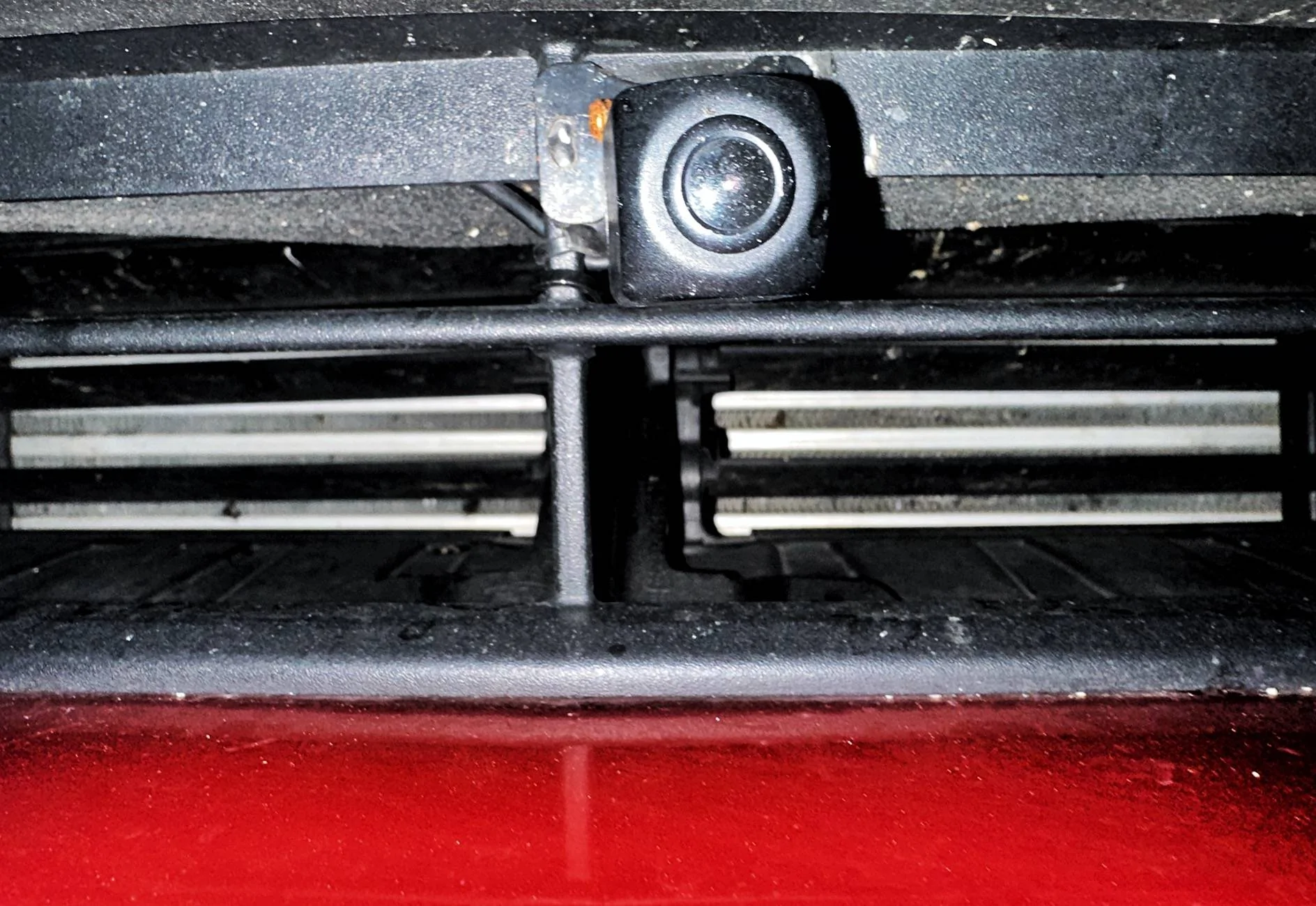

-I mounted it low and pretty hidden in the opening below the bumper and above the splitter.

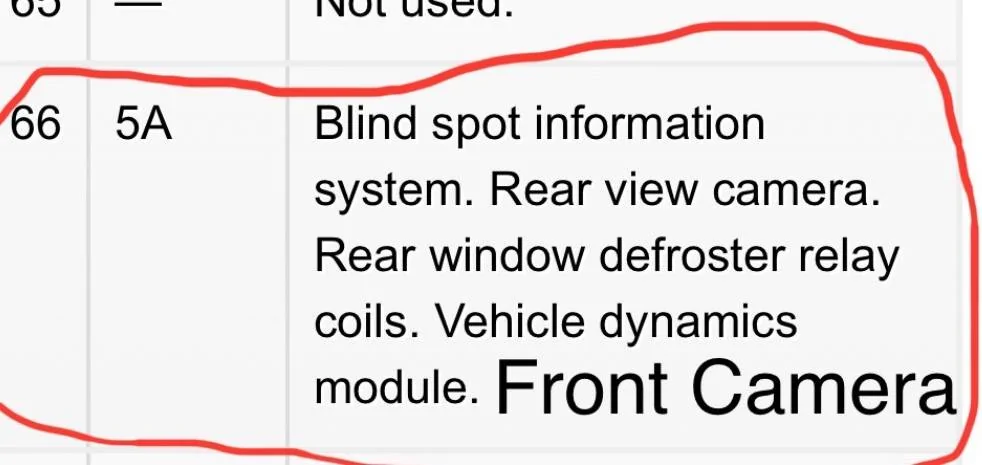

-It is powered up when I start the car and is on all the time until I shut off the car. I pulled the on/off power in the power distribution fuse box under the hood. See attached image.

-It works fine, but…. The camera is almost too low where I have it mounted, but it does work. I’ve even recorded video driving on a mountain road, but it is best for seeing that which is immediately in front of and close to the car, like a curb or parking block.

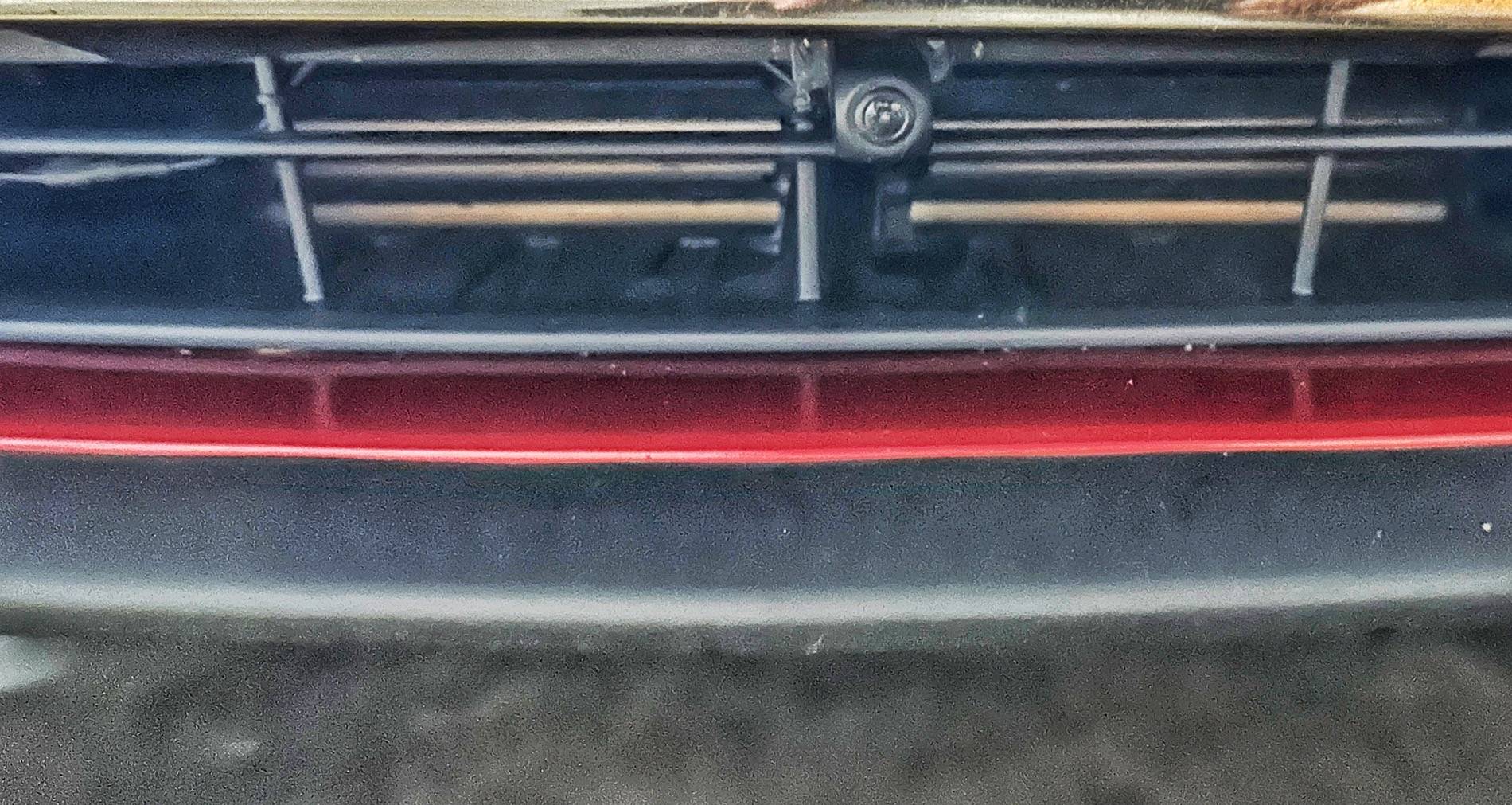

And this shows the camera mounted below the bumper. I’m on a trip so a little dirty.

BTW, I installed the camera there with really strong double sided tape, but also put a very small screw as I did not want it coming loose. About 44k miles and it remains firm. Will do an image capture from it tomorrow so that you can see what you think. It’s not that much money, but I’m pretty anal in positioning and running wires, etc. plus I’m an old man and it takes me two hours to do a 15?minute job….or so it seems!

He said to use one of those piggyback fuse on number 125 or 140. And where I plan on putting the camera is up high under the lip to be able to point down and forward

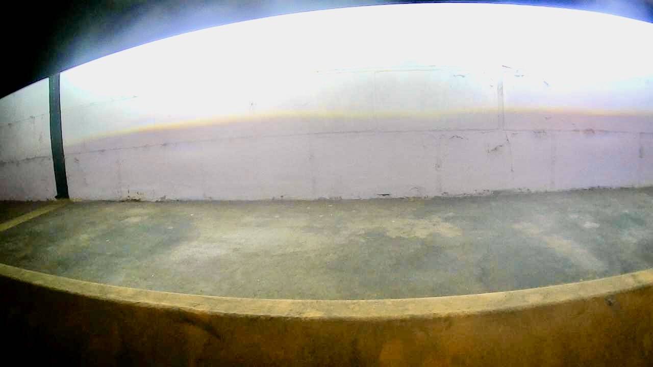

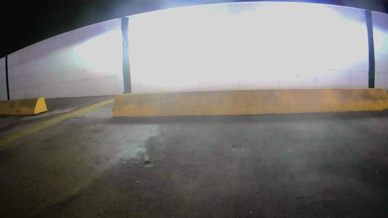

I was in a dark parking garage with my headlights on when I took these pictures.
S650 Mustang Forward Facing Camera 2025-03-05-10-53-35-097
S650 Mustang Forward Facing Camera 2025-03-05-10-53-56-040

Matter of fact just had played around with it just now. The camera does a very good job of showing infront of car and down close. But to connect is not as simple as I was hoping for. In order to use it you have to go into WiFi on phone and connect to camera. Then instantly connects and shows the camera view which is extremely clear and bright. Was hoping it worked a little simpler.

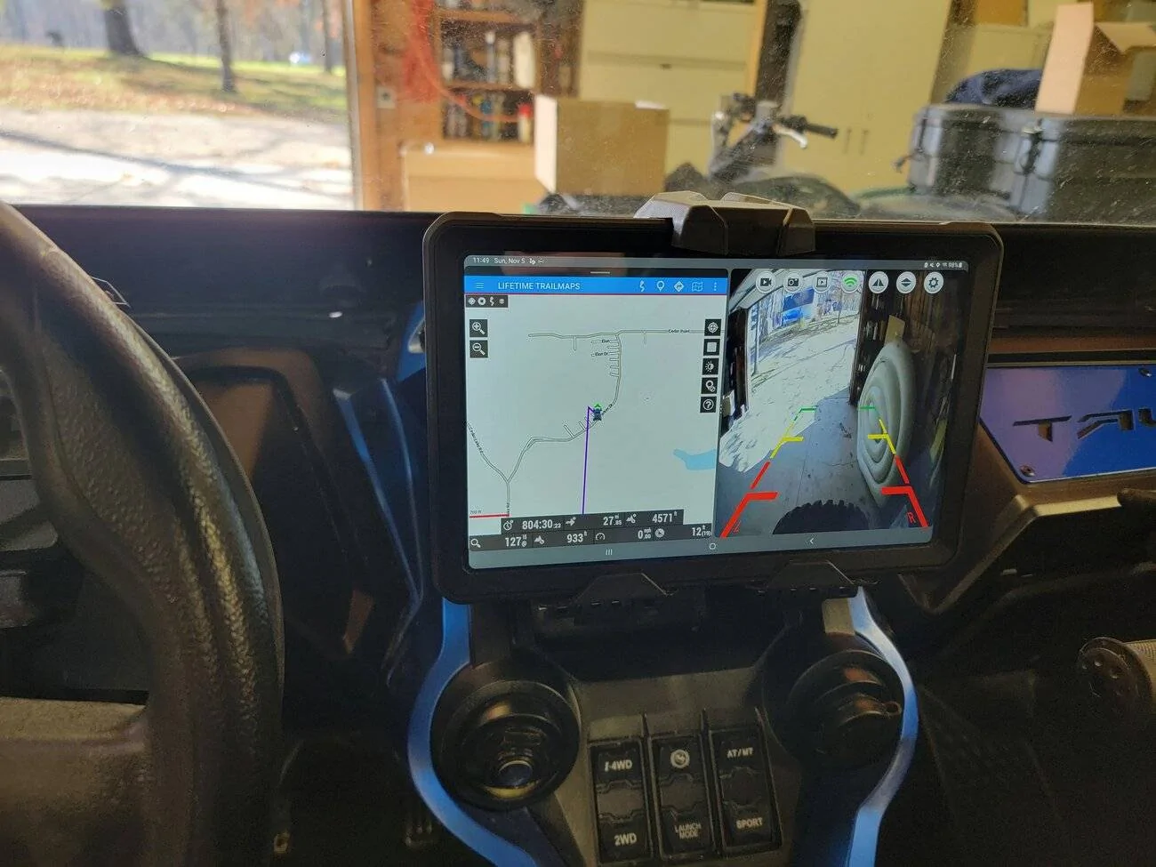

Been using these cheapo cams on the SXSs for years. I put a rocker switch on the dash (or an open button on the Auxbeam). Turn it on ~10 seconds in advance, then just hit the cam app shortcut from the tablet when ready (Agama Car Launcher).
The tablet is set to auto-connect to the WiFi SSID that the camera broadcasts, so I don't have to connect manually each time - it is connected prior to starting the cam app . Not so with your phone that you've typically already connected to Sync with when you're driving - you have manually to disconnect from Sync and connect to the cam SSID each time.
Here's a pic of a split screen - trail map software on the left, backup cam on the right. You can, of course, run apps, including the cam app, full screen.
S650 Mustang Forward Facing Camera 2023-11-05_11.49.49

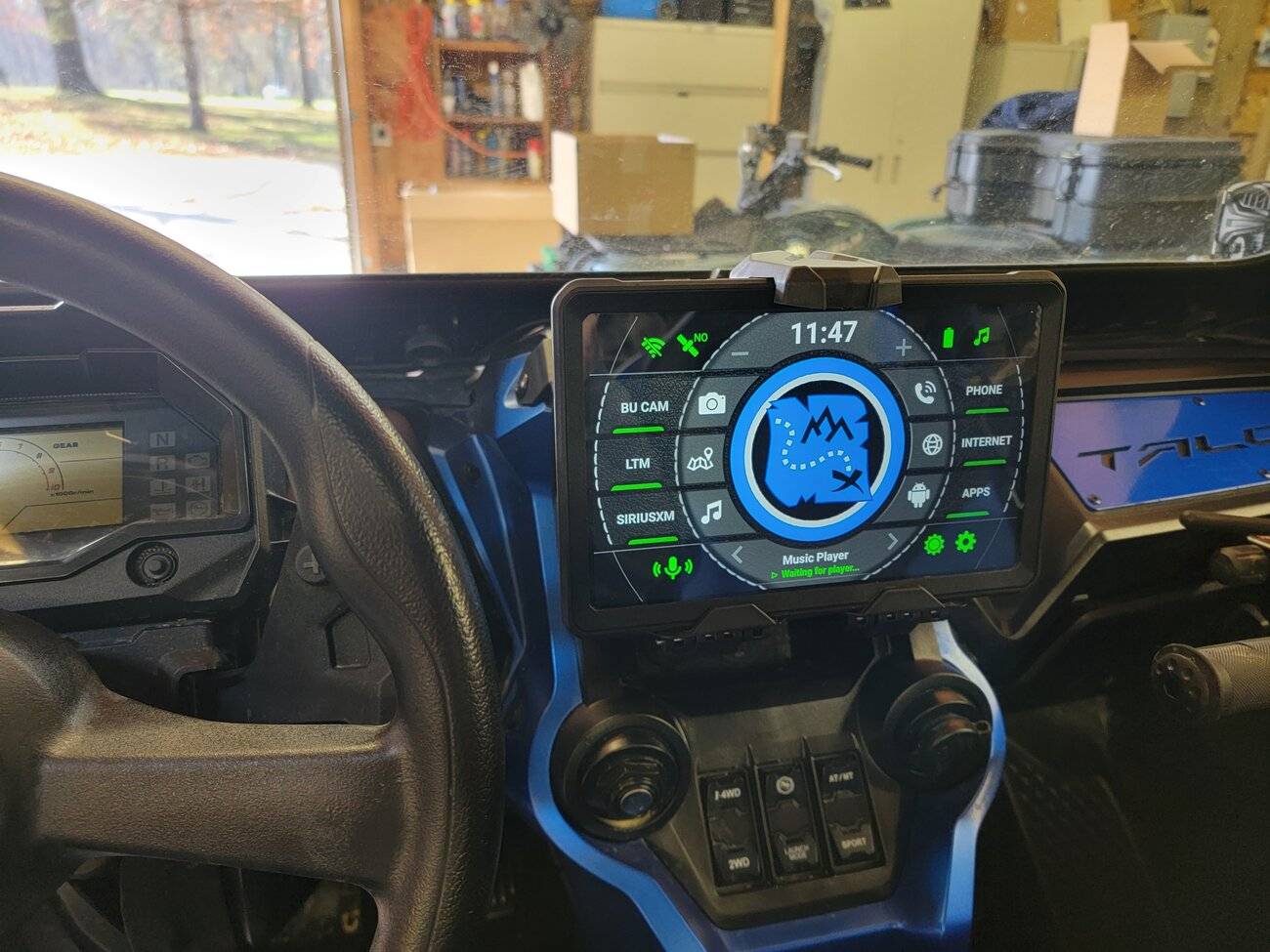

Agama launcher:
S650 Mustang Forward Facing Camera 2023-11-05_11.47.29
