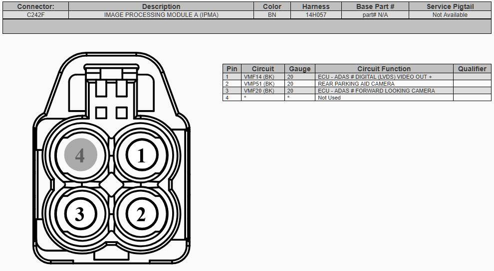

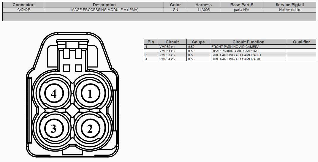

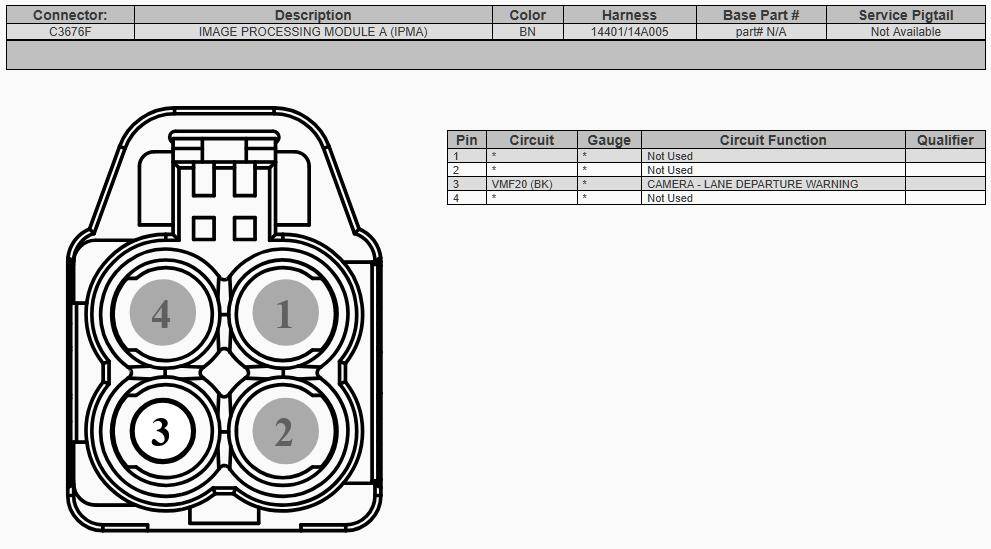

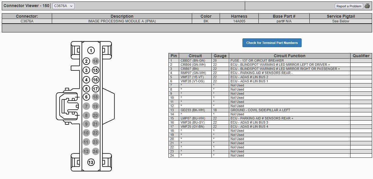

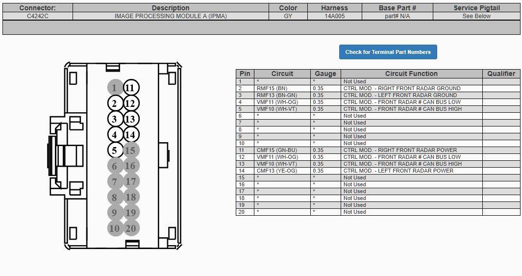

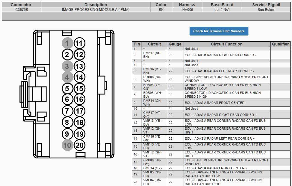

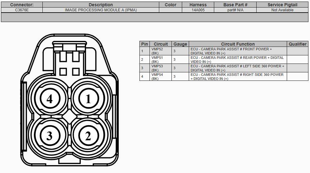

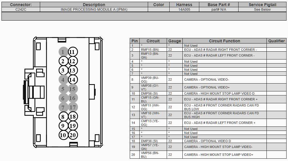

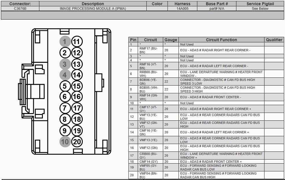

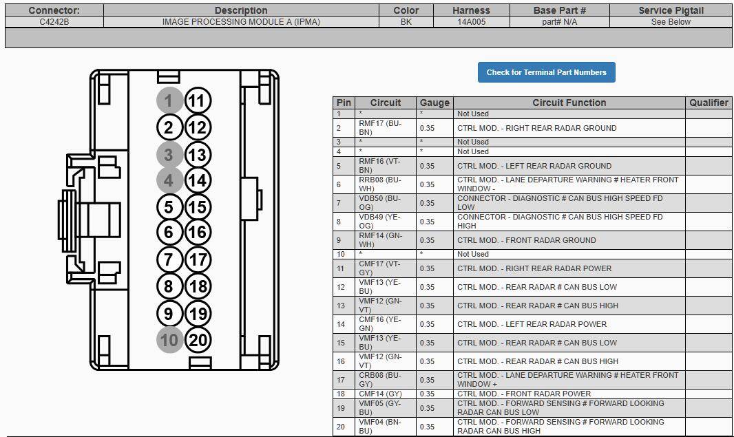

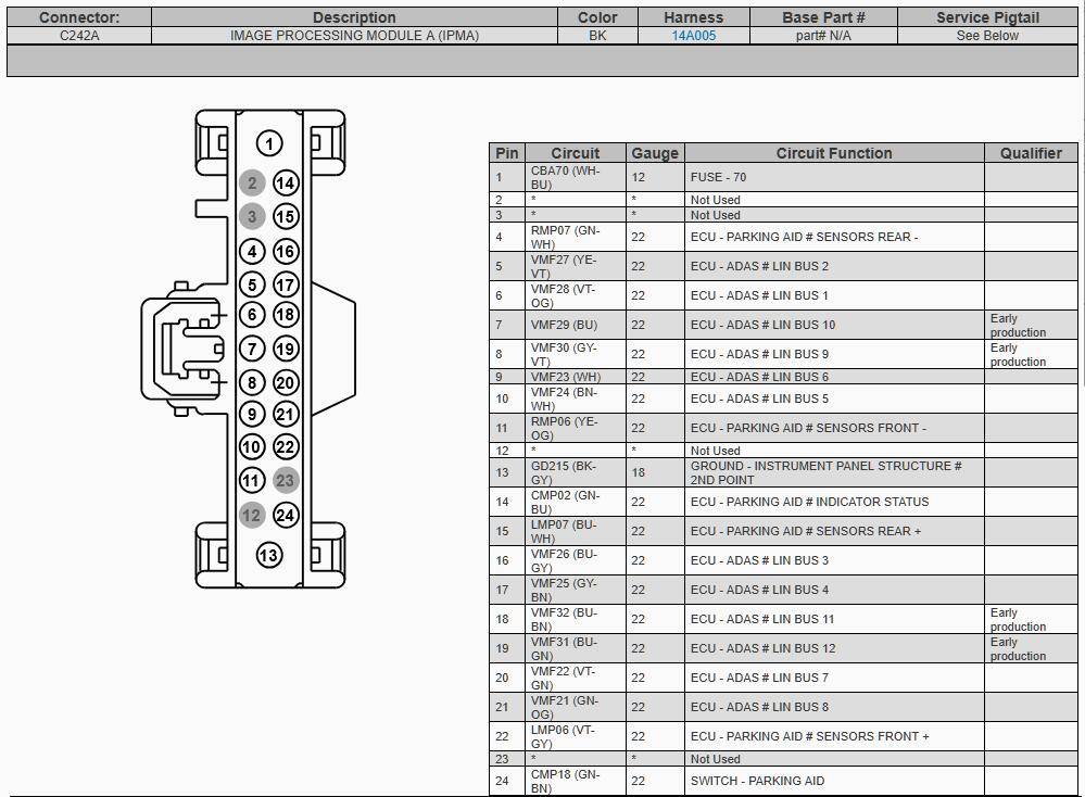

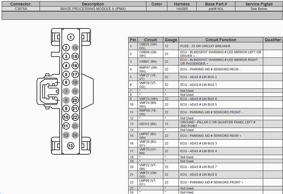

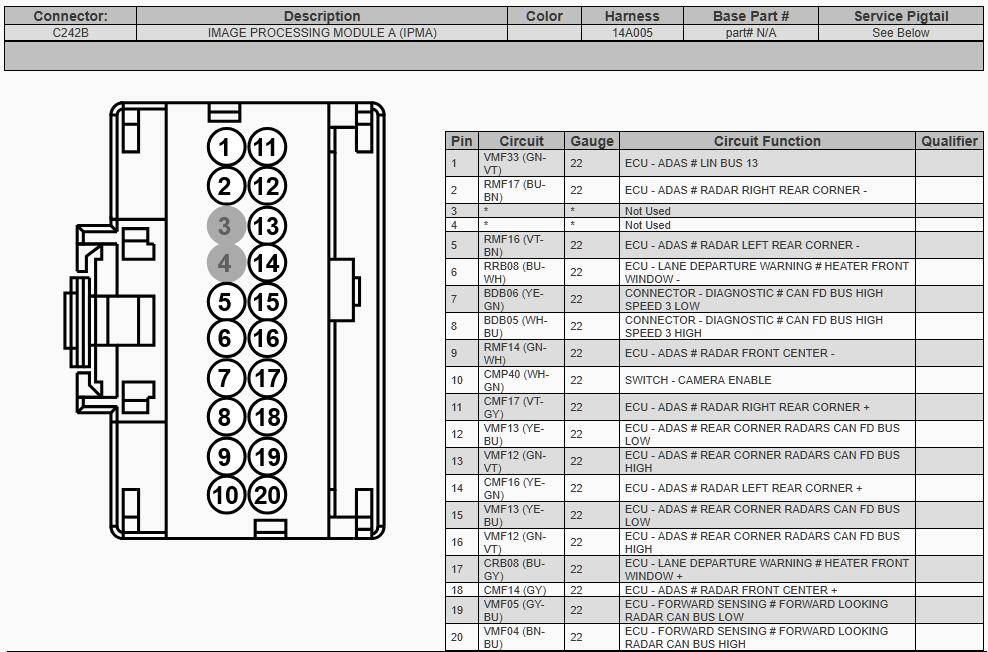

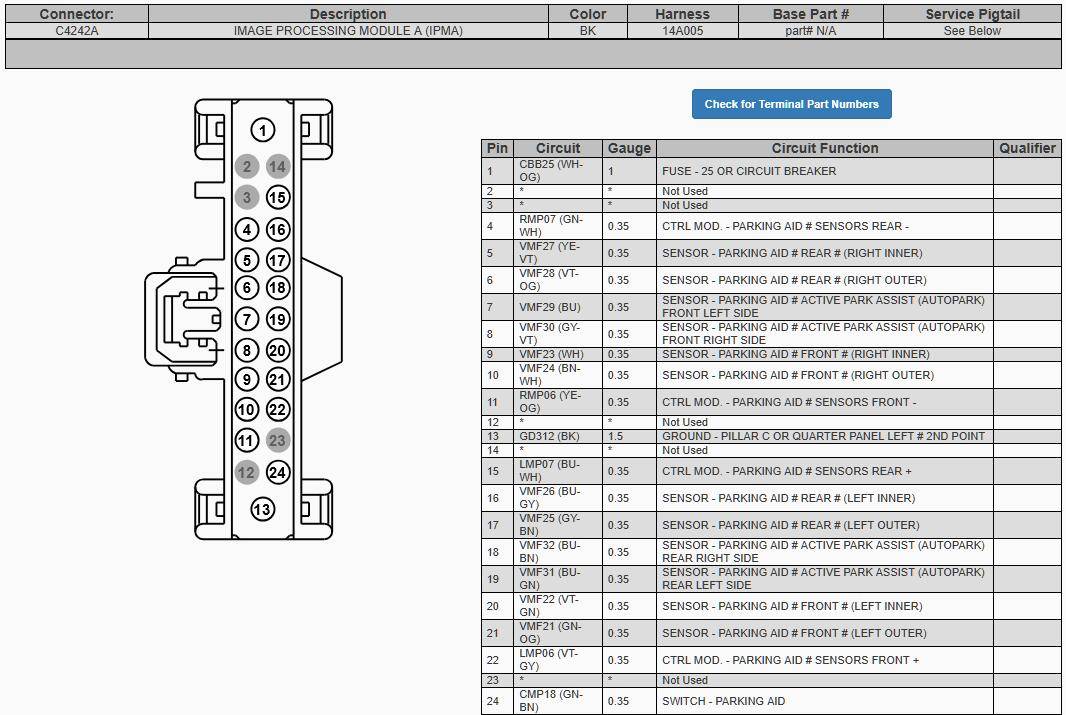

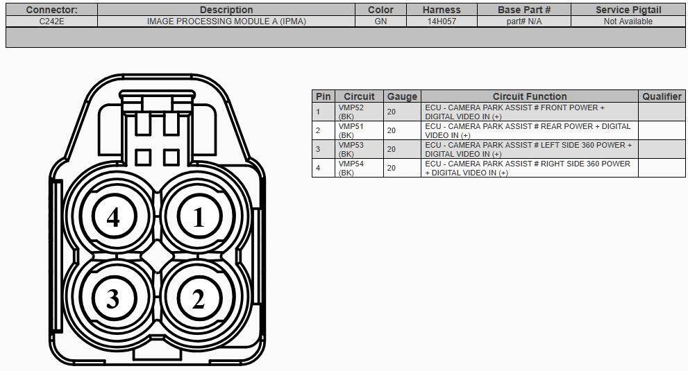

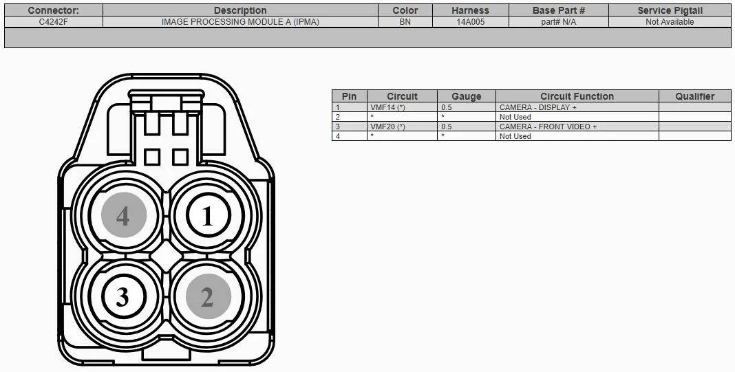

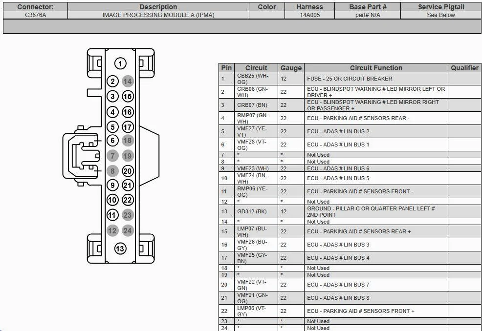

here are the pinouts for each connector
ColorF-150MustangMach-EMaverickConnector that plugs into it
Beige
S650 Mustang 360 Camera Addition 1751355998426-z
S650 Mustang 360 Camera Addition 1751356010099-8g
S650 Mustang 360 Camera Addition 1751356555162-3u
S650 Mustang 360 Camera Addition 1751384109873-tc
Yazaki 7287-2047-30
Black
S650 Mustang 360 Camera Addition 1751356143819-y
S650 Mustang 360 Camera Addition 1751356098318-5i
S650 Mustang 360 Camera Addition 1751356581292-n7
S650 Mustang 360 Camera Addition 1751384135733-wq
TE Connectivity 2288276-1
Light Grey
S650 Mustang 360 Camera Addition 1751356232690-0q
Missing
S650 Mustang 360 Camera Addition 1751356603281-7v
Present but unusedTE Connectivity 2288276-2
Brown
S650 Mustang 360 Camera Addition 1751356470258-40
S650 Mustang 360 Camera Addition 1751356274242-rv
S650 Mustang 360 Camera Addition 1751356688016-s5
S650 Mustang 360 Camera Addition 1751384192528-89
Rosenberger AMZW25-000-F
Green (360 Cam)
S650 Mustang 360 Camera Addition 1751356418664-7c
Missing
S650 Mustang 360 Camera Addition 1751356631515-i5
S650 Mustang 360 Camera Addition 1751384170495-qv
Rosenberger AMZW25-000-E

This is great info.
Not too surprised the video connections are different between 360 and non-360 models.
The missing plug is the hardest part. Not being there can easily mean the components, on the board itself, are also missing. And mostly like at a minimum, there are pull-up (or pull-down) resistors on some or all of the lines.
And with the pin on the other connectors being jumbled means the internals are different.
Based on this, the IPMA module needs to be swapped. And the wiring harnesses re-pinned.
What is interesting is the MachE and F150 have some pins different. I wonder if comparing to an Escape or ‘25 Maverick (which have 360) might be worth it. Maybe those would be an easy IPMA to worth with? I’m thinking this because those are the same size screen as the Mustang. And the MachE, I believe is Sync 4a, while the Mustang/Escape/Maverick are Sync 4; not sure what Sync version F150 was.
Looks like pin 10 on the black connector is the camera button. MachE is all touch screen, so that pin is not populated on it.

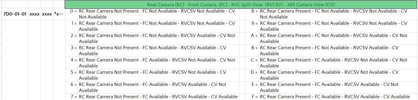

On the F150, 360 views are enabled in the APIM here. Just pulled the ab data from a random 2024 Mustang and it shows an 8 in the field below which makes sense for rear camera only vehicles.

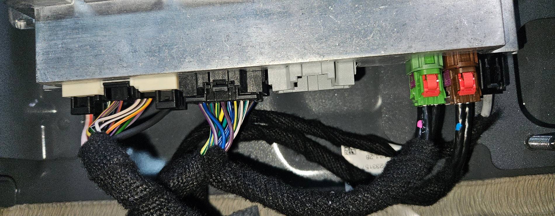

i did some looking on some stock units at work and found this very interesting thing
S650 Mustang 360 Camera Addition 1751383235297-db
IPMA in the back of a 2025 Maverick, and they just left the grey connector empty entirely

the pins are not jumbled, but its just the wording is different but usage is the same, but some are not used. for example, the beige connector pins 2 and 3 are unused on the F-150 and Mach-E because they light up the BLIS indicator via communication over CAN network. the Mustang and Maverick lights them up directly, though through those pins. this is also an option you can enable and disable in FORScan. the F-150 uses SYNC 4 as well. the general shape and mounting of the module appears to also be the same across all vehicles that use it. i also added the Maverick's connectors to the first reply too
Well look at, nice! Ford said they wanted to get to fewer screens, maybe they also went to fewer IPMAs; that would be good.

This bit in the IPMA looks like an important piece of the puzzle:
S650 Mustang 360 Camera Addition 1751388416539-7l
My truck with OEM 360 cams shows FF there:
S650 Mustang 360 Camera Addition 1751388453970-pu
