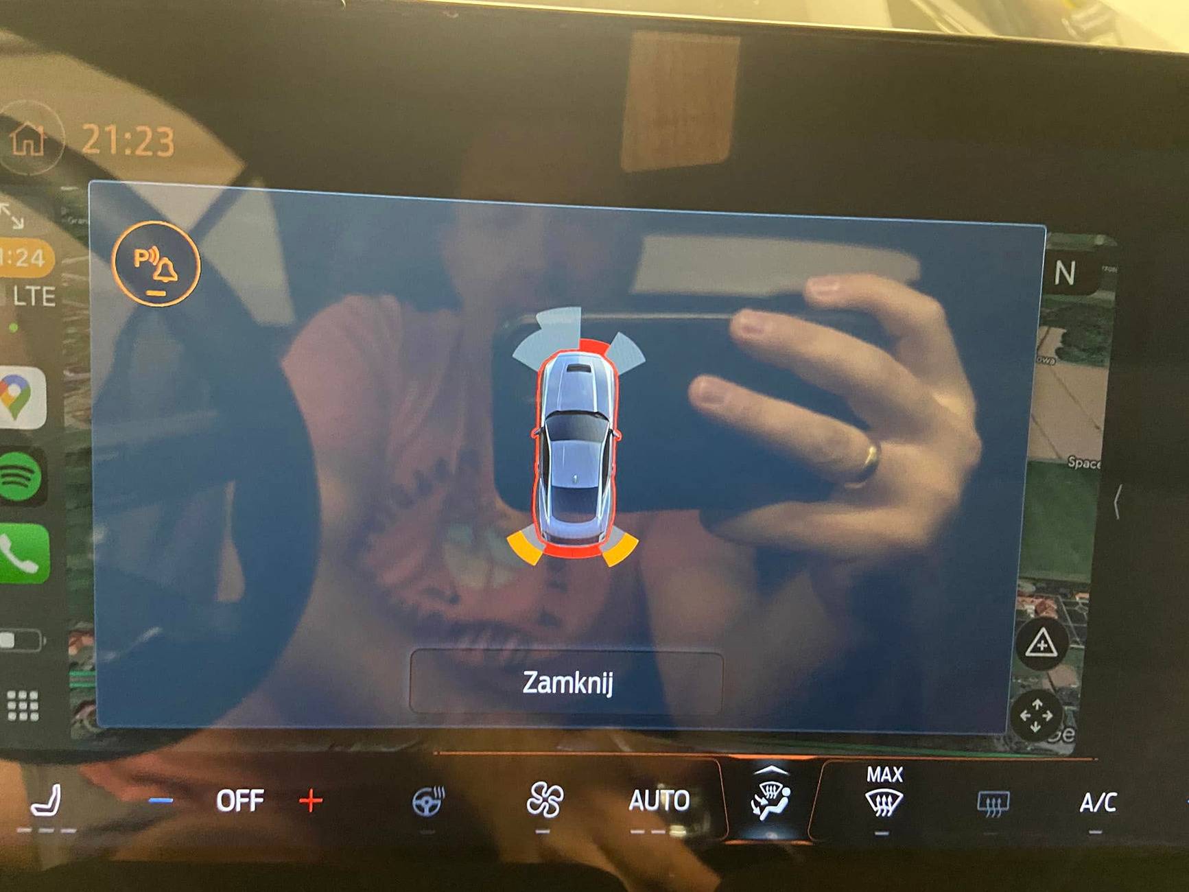

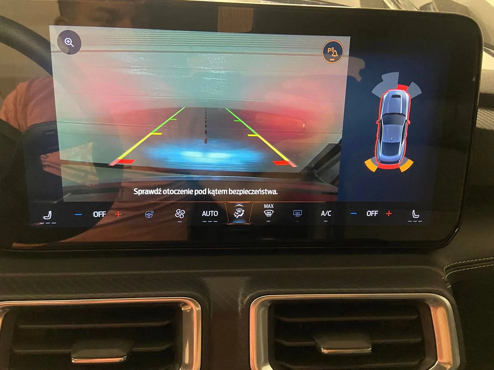

what even happens if a mismatched TRON module gets plugged in? just a code?
GrabThatBlue
Jan 13, 2025
2,480
2,745
Between Canada and Europe
I only miss sound from front sensors. I assume that ACM or IPMA FW miss some strategy.
I'm going to do a roadtrip to Poland I think to visit this Mustang wizard to get this working haha.
