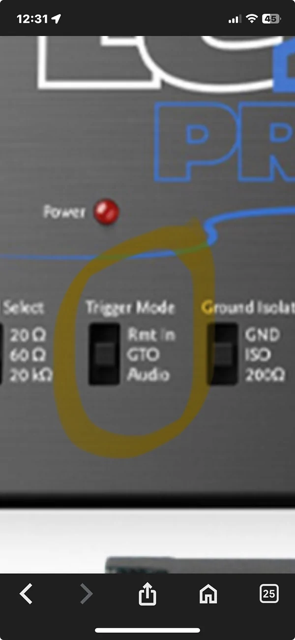

Just get the audio control LCI2 , it has remote sensening turn on built into it, an eliminating the need to connect to a fused turn on source. YouTube it it’s called GTO ( great turn on) tech built into it.

Ya, I
Here’s a pic
thanks… ya I am all good with getting that LC2i, I think my biggest concern is not wanting to splice into mu factory wiring ti my speakers. Do you know if they sell some kind of plug and play harness to connect to rear speakers to then connect to the LC2i ?

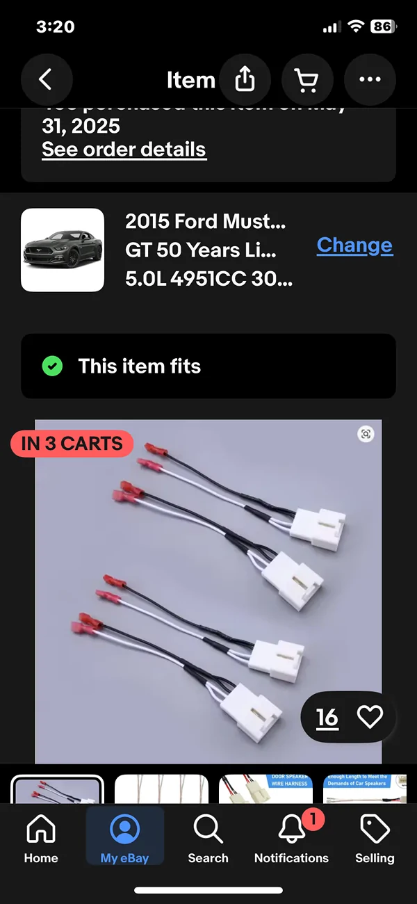

I bought these off eBay
Do you have a link to this? Also wouldn't I need a “T” harness to keep the speakers in play??
From what I can see, what you sent me is to replace the speaker's to aftermarket speakers. I need speaker input to the LC2i to convert to aux for subwoofer amp.
I am Not changing speakers, i am adding a subwoofer only powered by an amp.
