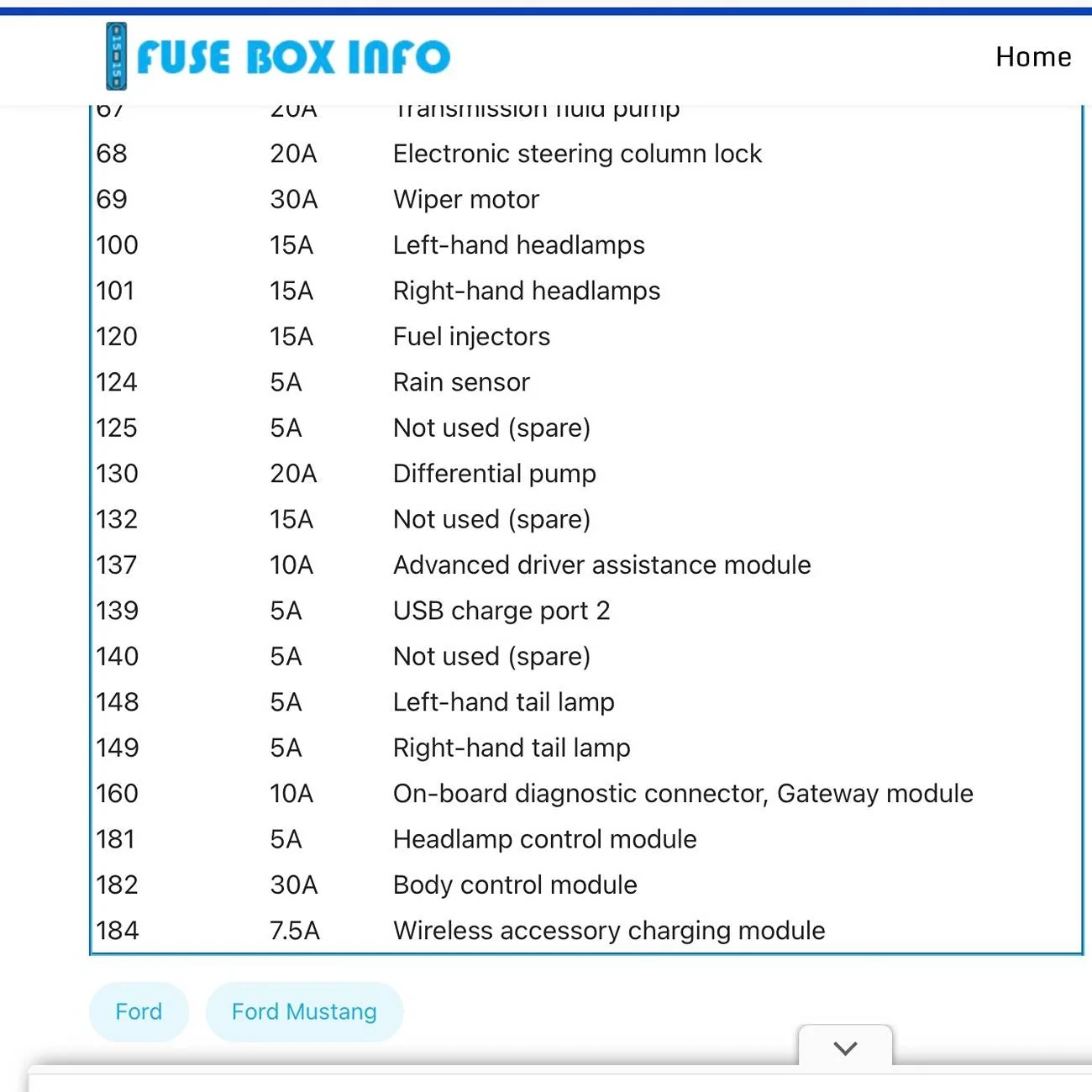

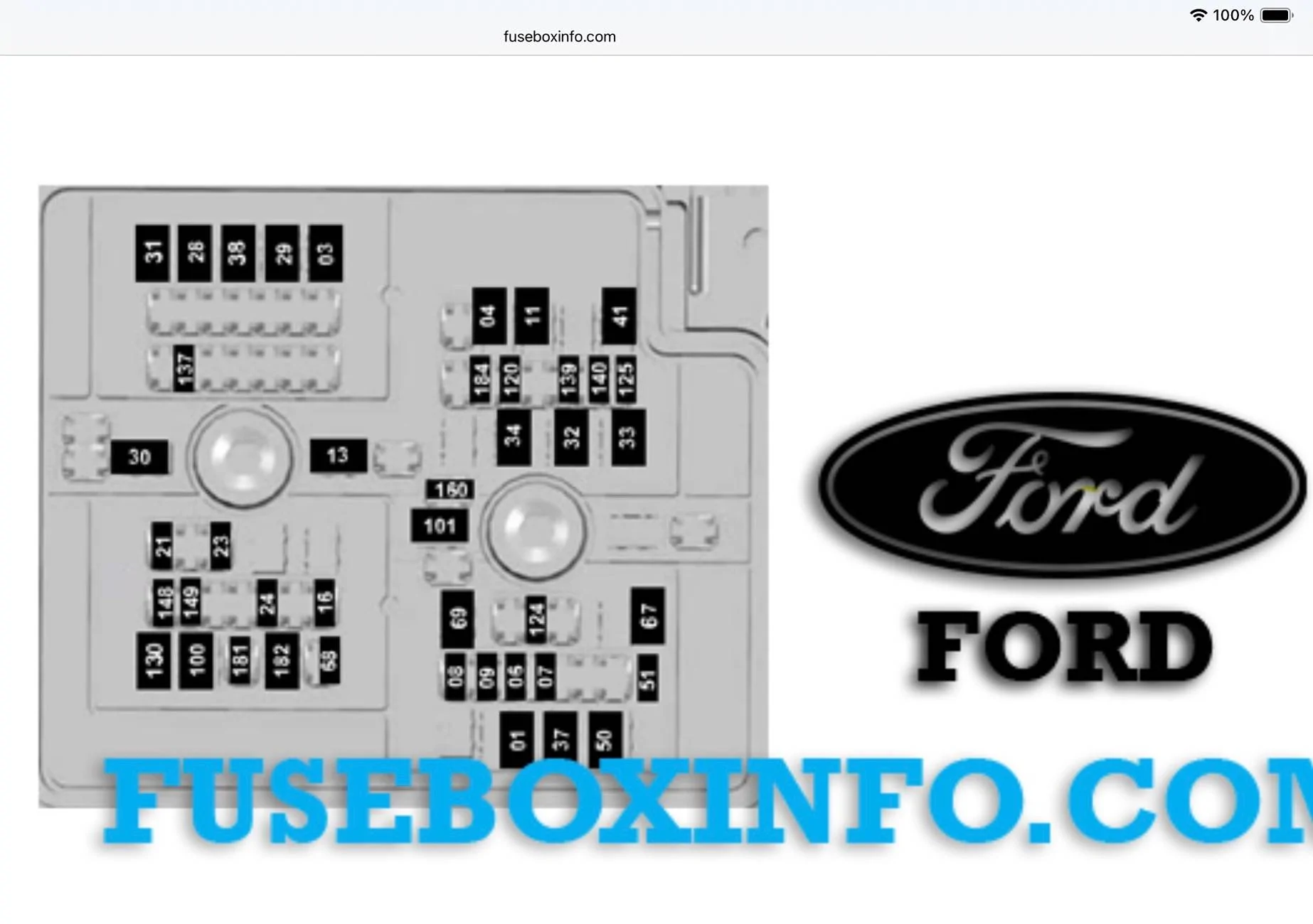

Pull fuse #184
heck yeah! Thank you! First thing in the morning. Appreciate the assistance.
