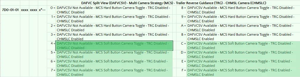

Well, if you or anyone wants to try, I would enable MCS soft button here:
S650 Mustang Turn on backup camera? 1778867943642-xc

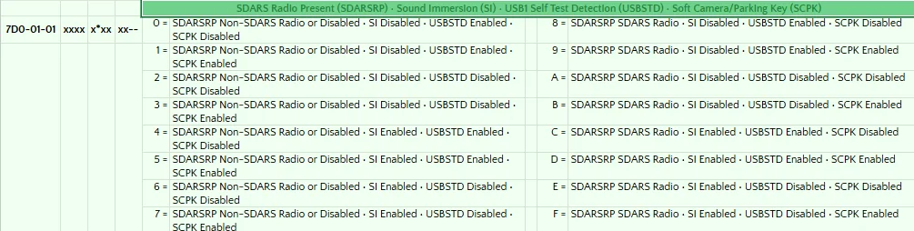

This setting for SCPK may or may not be relevant, but worth noting. My truck has SCPK disabled, but I have both a hard camera button and a button on the touchscreen to access the multicamera menu bar.
S650 Mustang Turn on backup camera? 1778868010056-70

Well, if you or anyone wants ….
..I have both a hard camera button and a button on the touchscreen to access the multicamera menu bar.
Any chance you have a pic of the touchscreen button, wouldn’t mind having that but like you indicated, our truck has a physical button so wasn’t sure where the touchscreen button would appear, assuming the bottom row but you know how assumptions grow….
I have no idea what it would look like on this vehicle if it could be added. Sometimes these things work and sometimes, they don't. To someone comfy/cozy with FORScan, they would just need to try and see what happens.

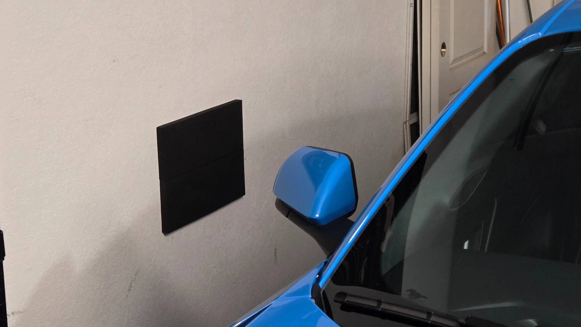

There is no way to switch on the camera that im aware of. Maybe put it in reverse and back in?
In all seriousness, I pull into my garage to a certian point. Then I'll put it in reverse and check with my back-up camera if im lined up to a mark on the floor that tells me im in far enough, and then roll back as needed. Its really not a difficult thing.
I have put padding on the wall beside the drivers door. I pull up until it's right beside me then I stop knowing I'm in far enough . Also if I open my door to far it won't damage the paint.
3,876
5,464
Yep. Got one of those too. Its more so I dont have to worry about opening the door.

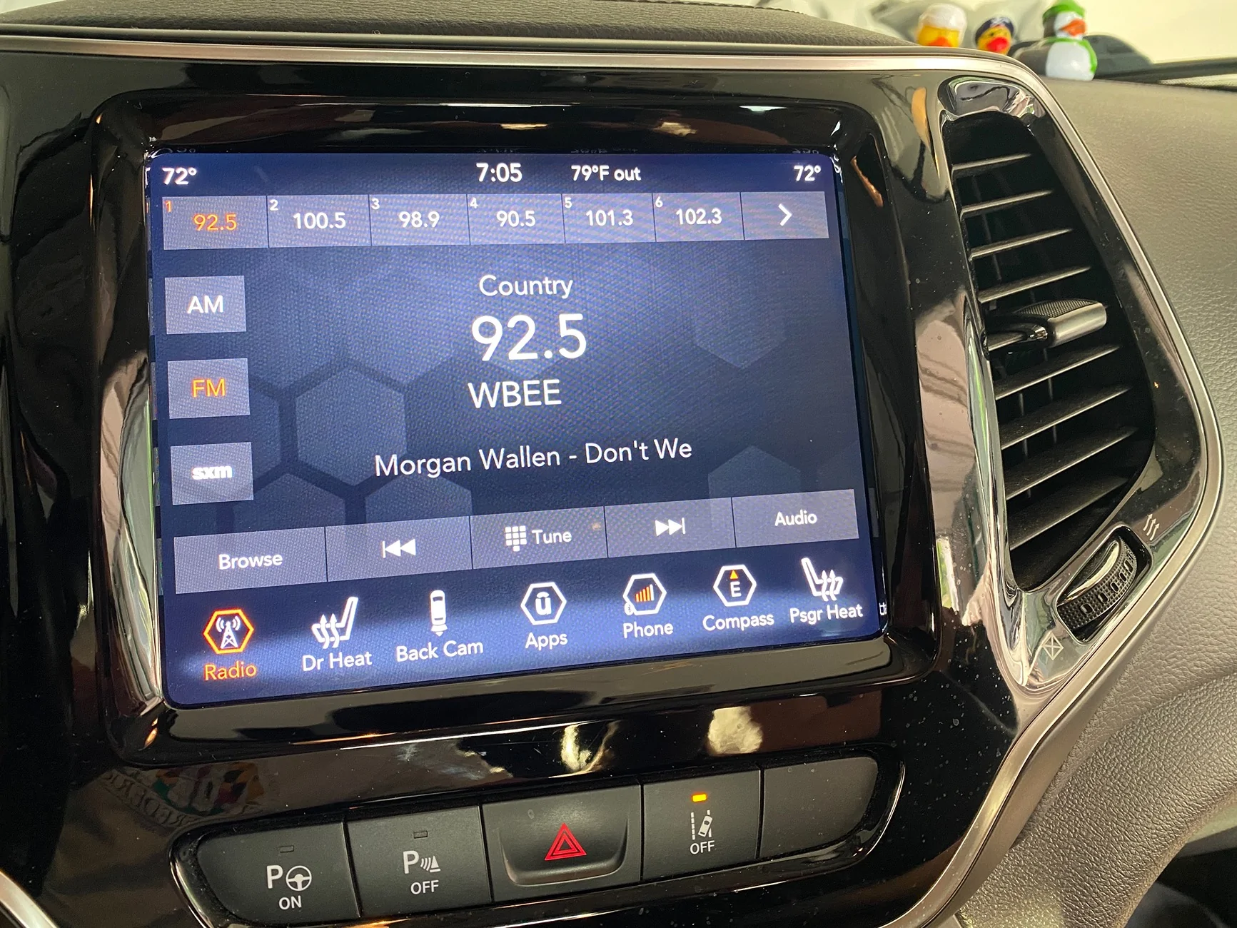

Here’s a picture of my button to turn on my backup camera in my 2019 Jeep Cherokee as a reference
S650 Mustang Turn on backup camera? IMG_9031
