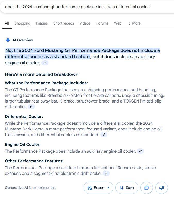

I just did a google search on the differential cooler, as I had not previously, and here is what Google AI gave me:
When asking artificial interaction it all depends on how the question is asked

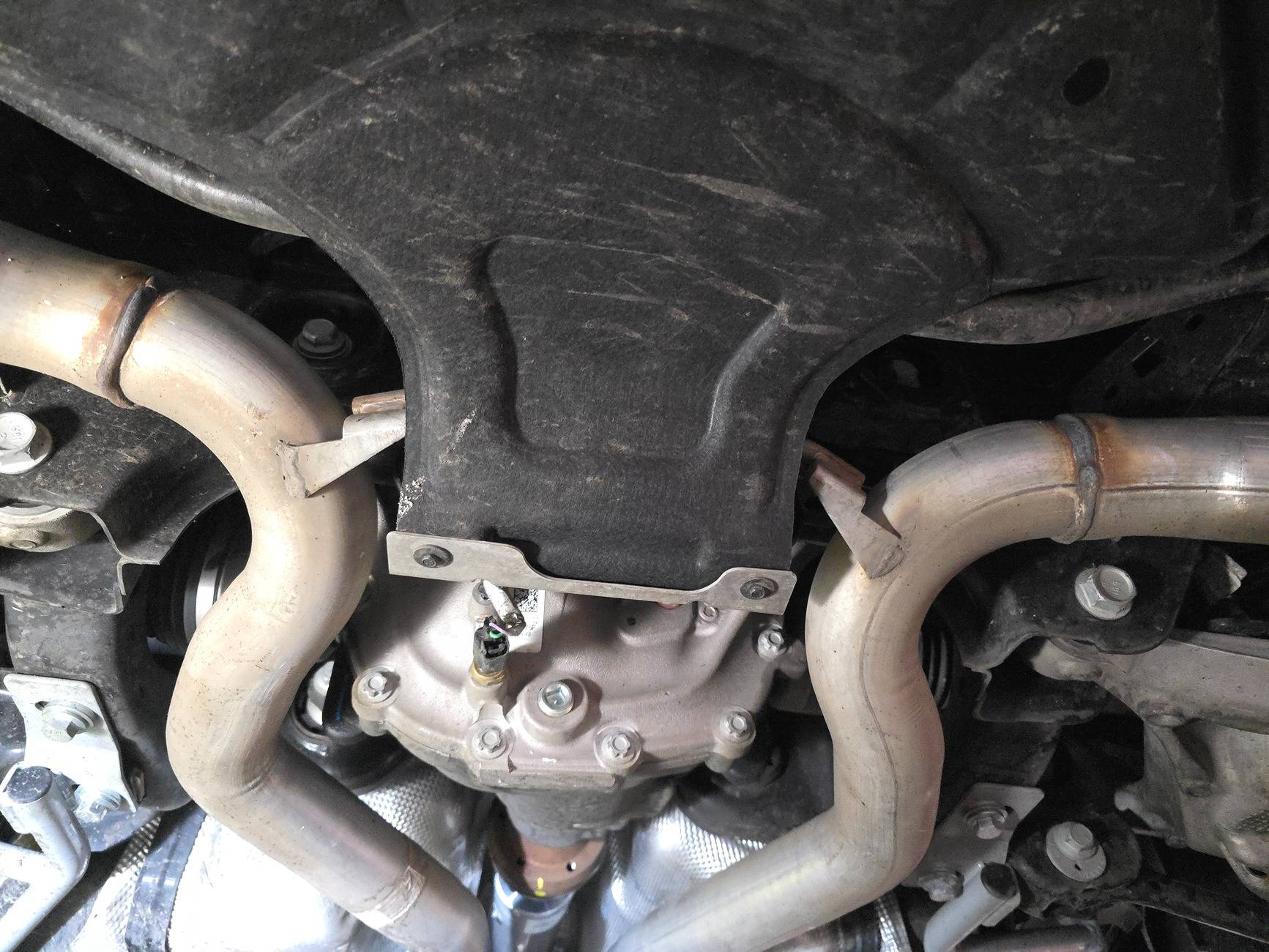

Alright, KRISK, I got under the car but didn't remove the rear air damn. No reason to bc I can see enough. You are right, the car does not have a differential cooler. It is only wired with a sensor to monitor temps and no cooler is attached to the unit.
I read information on Google and believed what I read. I seem to remember seeing this a couple of times online. After seeing the diff temp gauge - and seeing that the car has an oil cooler and extra engine cooling at the front driver side - I didn't think to question it.
Just goes to show that a person cannot believe everything they read online, even when it weems like it is a reputable source. I even made the decision to purchase the GT over the Darkhorse or Mach 1 on that information.
Here's the easy part: I apologize for insisting that the car has a diff cooler based on the information I was getting. Now the hard part is gonna be upgrading my diff! lol
I'm glad we have cleared this up. I'd hate to steer anyone else wrong. I have been researching more about the cars and it appears that there is a lot of misinformation about them online.
Nothing to apologize for. You were stating what you had read and you weren’t rude or a jerk. I did a write up on the MMR differential cooler install which you may want to check out. It’s somewhat of a pain to install, but works great and keeps the temps down on the track.
