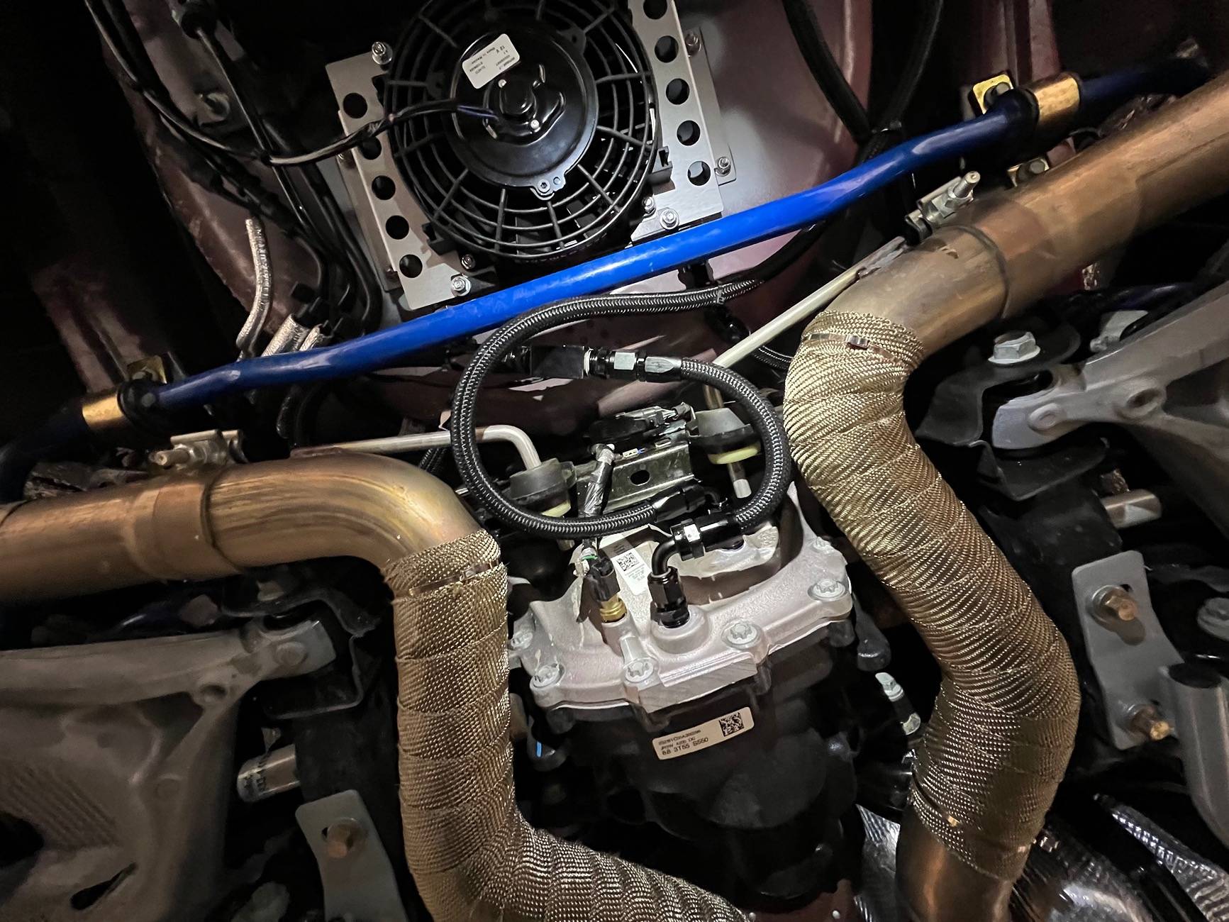

I’m guessing they forgot to install the differential cooler on my PP then. I had to install one myself. Could you post a photo of the OEM PP differential cooler? I’m interested to see it.
S650 Mustang S650 with PP for Track Days IMG_4743

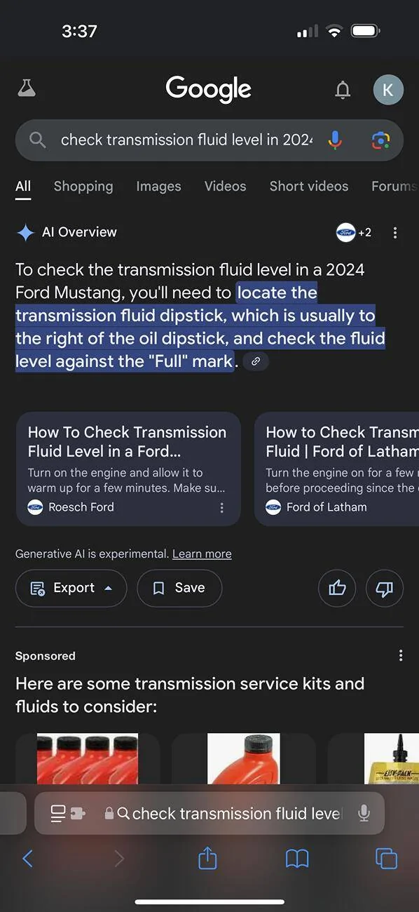

Google AI isn’t something I would rely upon for accurate information. Here is what it just gave me when I was looking up the transmission fluid level check procedures, which is completely incorrect.
S650 Mustang S650 with PP for Track Days IMG_5368

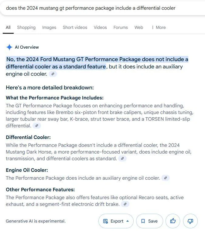

I just did a google search on the differential cooler, as I had not previously, and here is what Google AI gave me:
S650 Mustang S650 with PP for Track Days Screenshot 2025-03-29 050251
