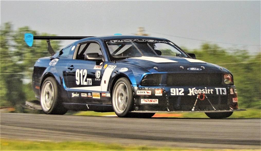

I road raced a Roush 427R with a RoushCharger (Eaton M90) supercharger, with a 9# pulley all over the Midwest for 12 years in NASA. The only time I had an overheating issue was in 2012, when we found the electric water pump was failing.
A lot of camber there - you can see it in the picture!
Any tips for keeping it cool?
Camber, front was -3*, rears -1.5*. Car was race dedicated and ran distilled water along with WaterWetter or Royal Purple Ice products in radiator.
Make 400hp not 800 ;)
Agree, my car was dyno'd at 435 rwhp, far cry from 800.
