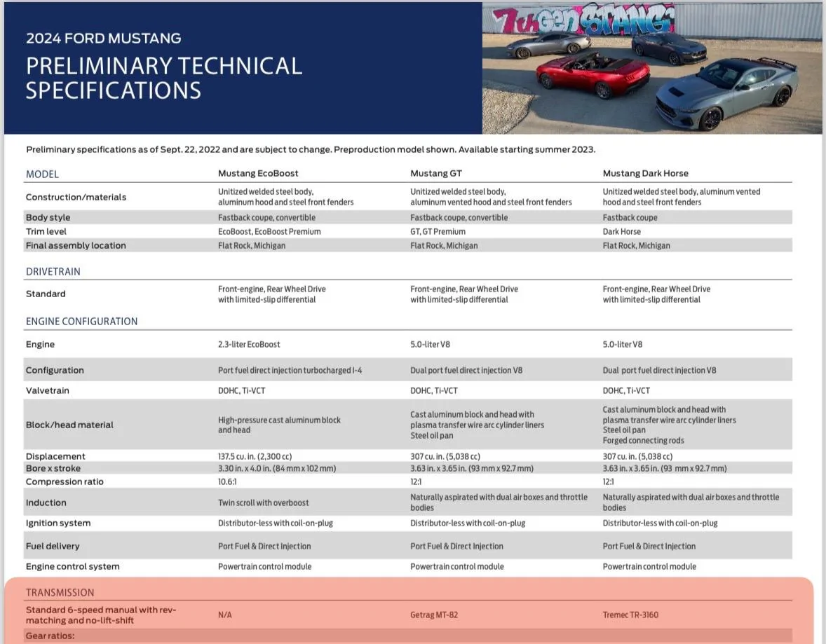

Apologies for the thread resurrection.
No Lift Shift is NOT the same as rev matching. No Lift Shift means exactly that. You press the acceleration pedal down 100% and shift up (i.e. 1->2->3->4->5->6) without letting off of the acceleration pedal. I see it is listed for the Dark Horse and the TREMEC, but I cannot find anything concrete for the GT with the MT-82.
4,701
2,563
S650 Mustang S650 No Lift Shift IMG_1861
Eurasianman
Jan 8, 2024
342
263
Alabama
I have seen that page. My only issue with that is the title, "Preliminary Technical Specifications".
I have seen no mention of it the owner's manual (keep in consideration, that this covers the EcoBoost, GT, and DH), not even for the Dark Horse model with the TREMEC.
4,701
2,563
Agreed re prelim however it does say tremec just to the right of getrag which is to the right of n/a
