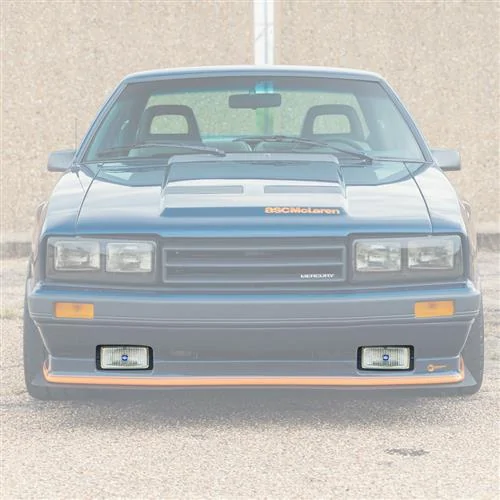

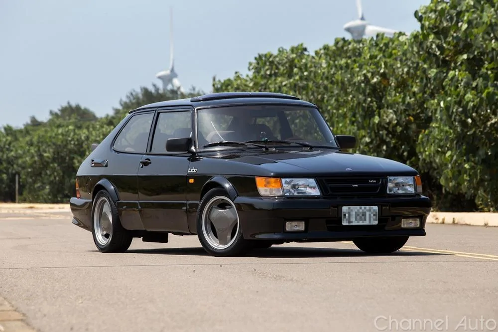

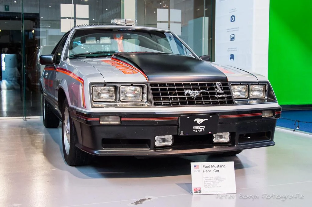

Fog lights that sit high on the the front of the vehicle are not for fog at all. They should not been turned on in fog conditions. Their beam will reflect off the fog and distract the driver further.
Functional fog lights should sit low, be angled towards the road, have a wide bar range and if possible not beam up. That’s why their encasing is typically a couple of inches deep.
The eighties had it right.
