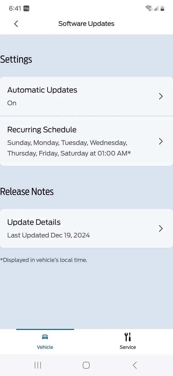

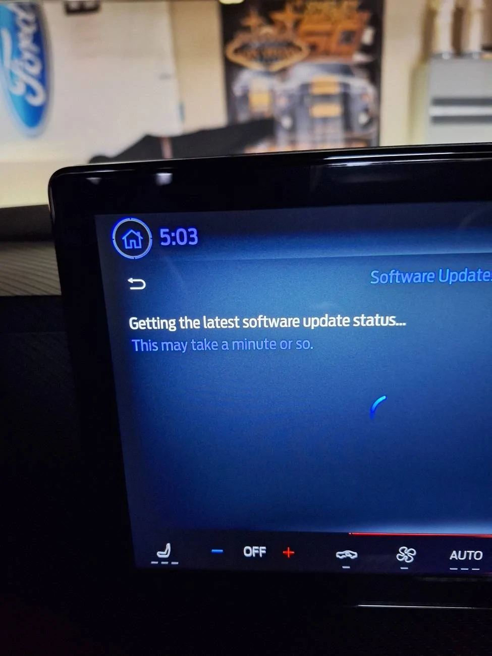

My car has been sitting for a month and my Ford pass said I needed to start the car for it to work. So I did 2 weeks ago. Ford pass then worked like it did when I first bought the car. When I sit in the car and start it and let if run for 15 minutes and it would not get updates 2 weeks ago. Today I drove the car 6 miles and it still says checking for updates and it could take a few minutes. Still no change at all. Spin cycle all over again. Should I pull the negative battery cable and let it set 20 minutes to reboot it ? It updated Dec. 19th 2024 to the 10.1

Yes, pull the negative cable for 20 minutes to get the spin cycle to go away when you check for updates. I can't say for sure that will prevent updates from going through, but I know that's the way to clear that out and I would do it if it was my vehicle. If you have forscan you can try to reboot the GWM and TCU. If that doesn't work, then the battery.

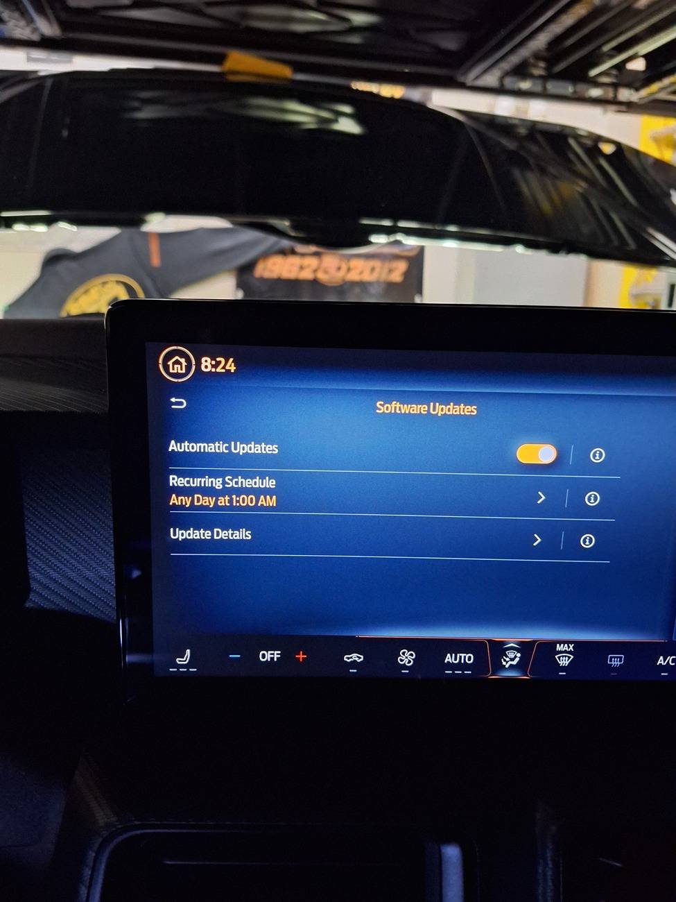

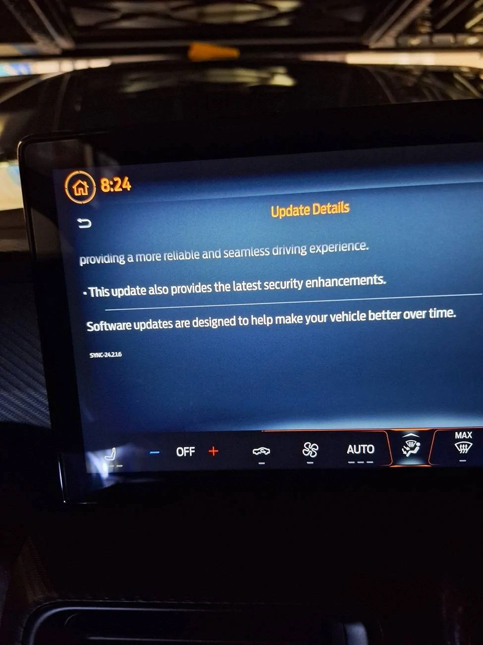

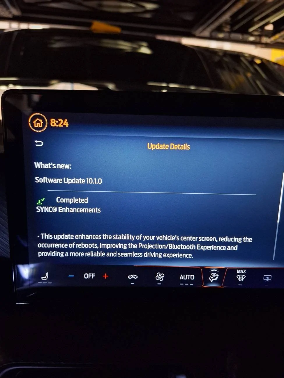

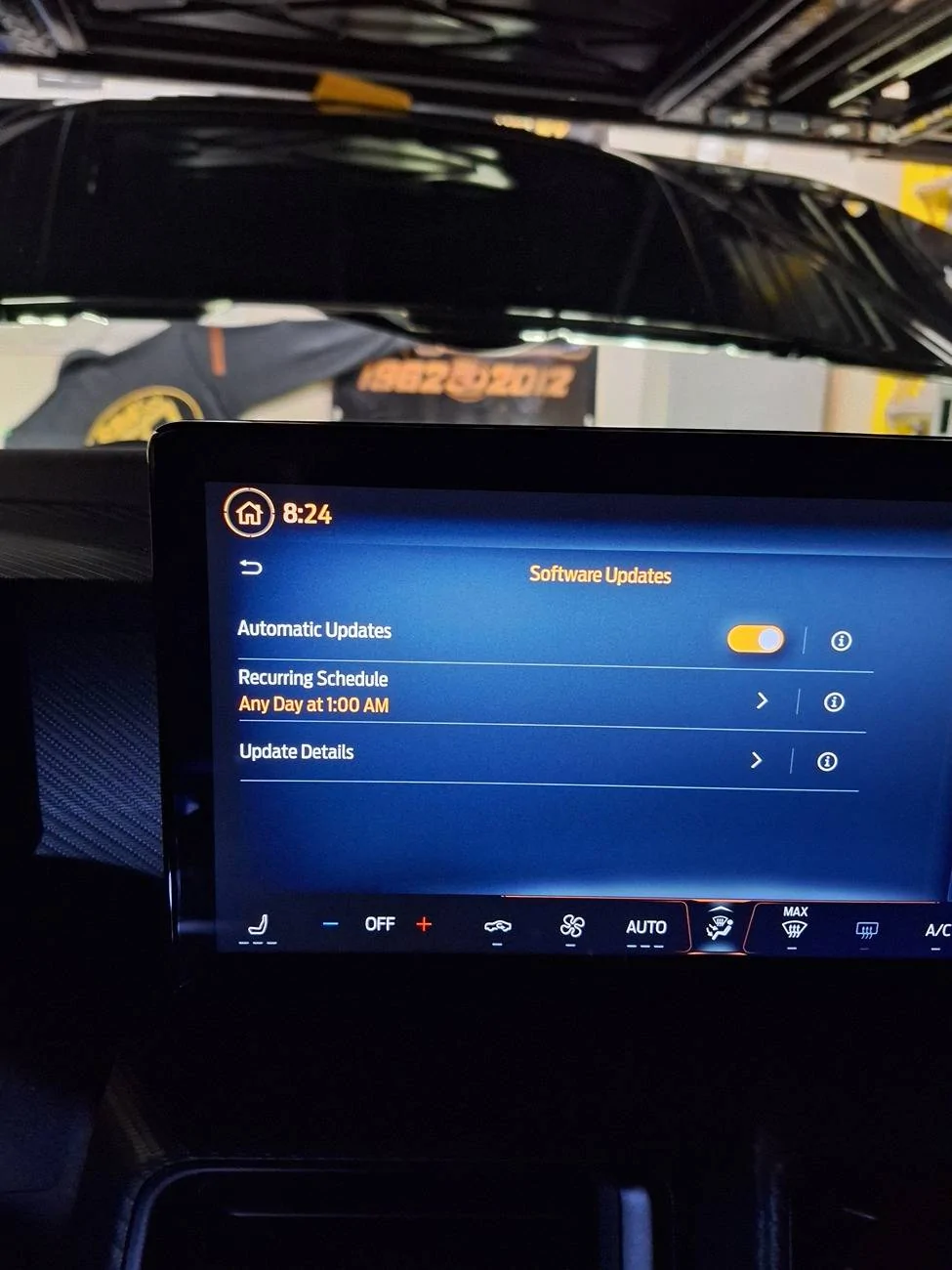

Ok it worked. I pulled the Neg. cable off the battery for 20 minutes. The spin cycle I have had for a month is now cleared. My updates are set to happen everyday at 1am so we will see. I got the 10.1.0 on Dec. 19th on my 2024 GT. Thank you for your help.
