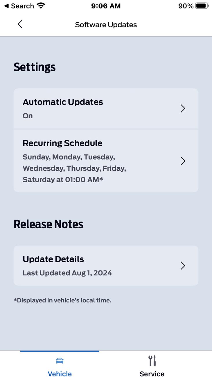

How do we know when/what the most recent OTA update was ?
Newbie says thanks
Neggytive
Mar 17, 2024
851
1,053
If you have the FordPass app it has it in SETTINGS, then SOFTWARE UPDATES
