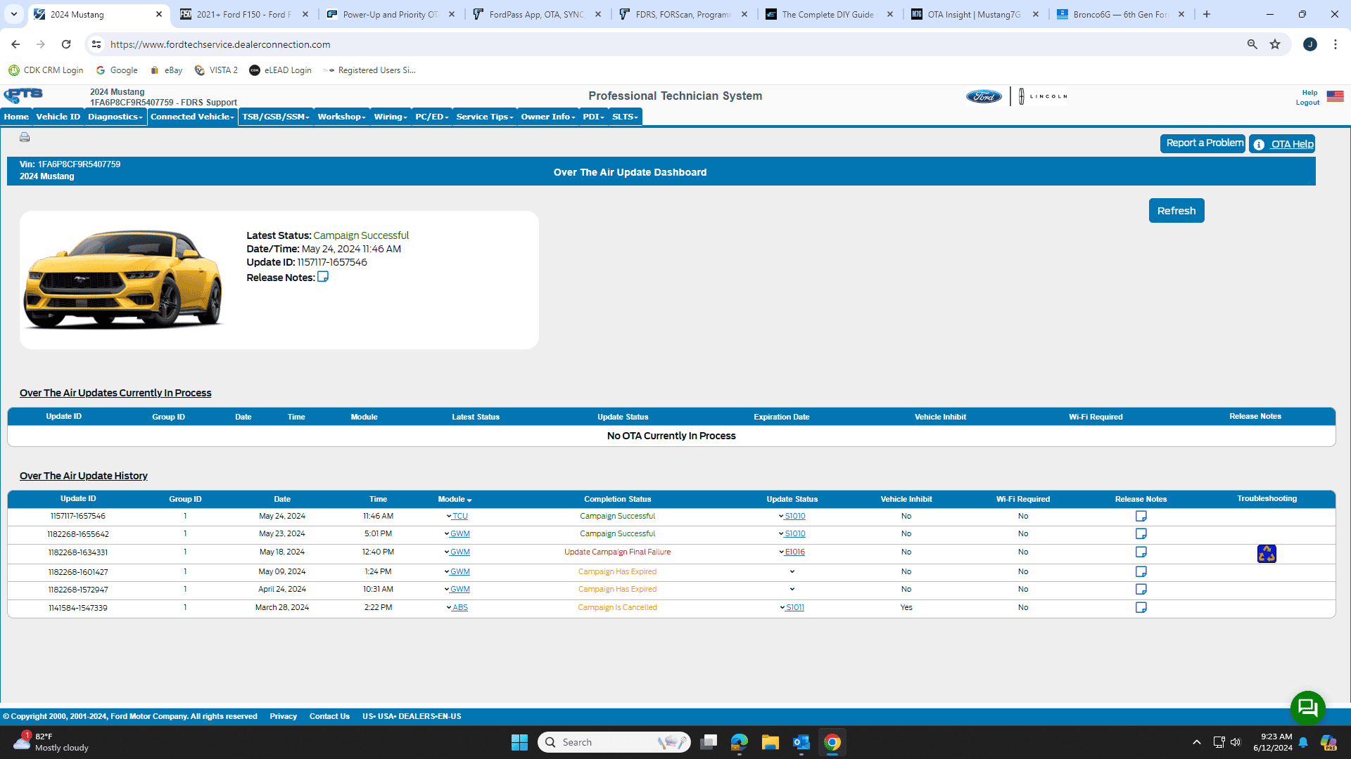

@evant8950 OTA history is below. 6.1.0 was sent to you a few times before it went through, but 6.2.0 went through the first time. No other active OTA trigger for you at this time. There is no way to force an OTA to be sent to you and it is impossible to predict when it will be sent. There is nothing you can do but wait when it comes to the OTA process.

Since Sync 4 was first introduced in 2020 with the 2021 F150 and Mach E's, only two OTA's have required wifi to install. In the screenshot I sent you, you'll notice there is a column illustrating if wifi is required or not. 99% of updates will come in through cellular even if you're connect to wifi.
