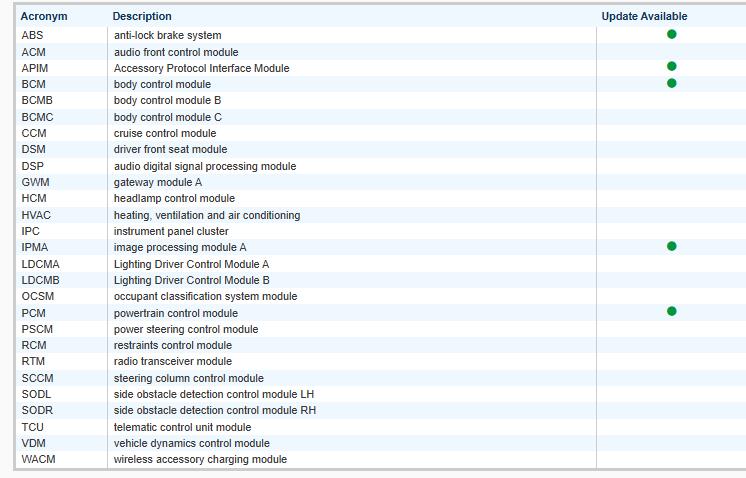

I have yet to receive a single update since I picked my car up from the dealer. My car has not even received the 60s style gauge option. The whole system is very buggy and loses connection to AA and car play regularly. If any one can look my vin up to see if something is going on I would appreciate it. I have had a Lethal Performance edition whiple on since it had 1000 miles so not sure if that would effect the otas.
Thanks for any help.

Gladly, but please remove your VIN from the post.
Modules pending updates are below, and the gauges come with that APIM update you see pending. The modem in your car is provisioned properly and your car is talking to the servers just fine. Looks like just some crappy luck with the unpredictable OTA process. Your car seems fine and I do not see anything that would prevent you from getting updates.
