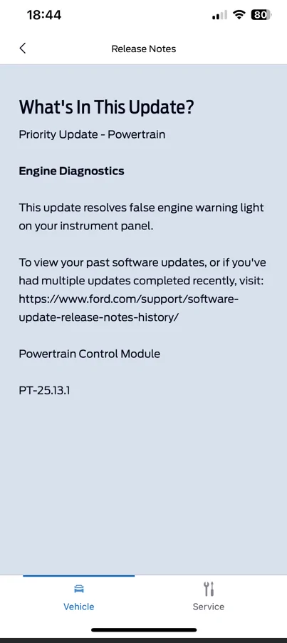

Added OTA 24-PU0201-DGB-FX for the BCM to the spreadsheet. If anyone has received any OTA's not listed, let me know and I will add it.
Edit: Also added PCM update PT-25.1.3.1 first reported in August AFAIK.
