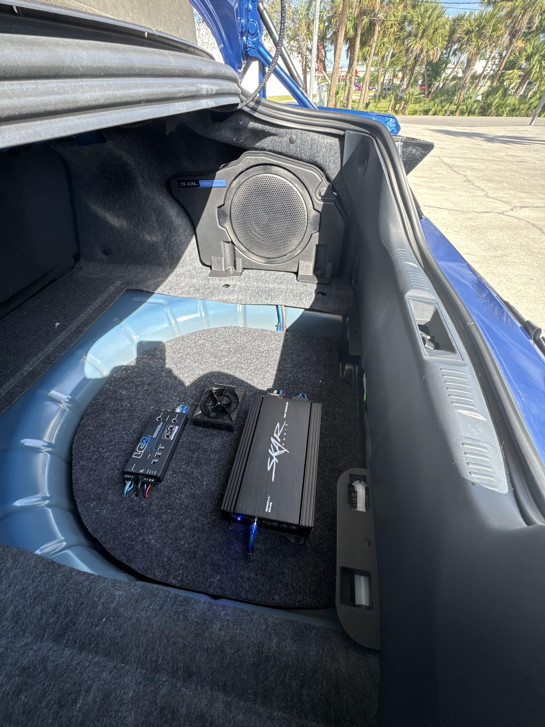

Just finished my sub upgrade and it sounds 100% better. The worst part is running the power supply. I kept the factory enclosure, added a Pioneer sub, LC2i Pro and SKAR amp. For under $350 you can’t go wrong.
