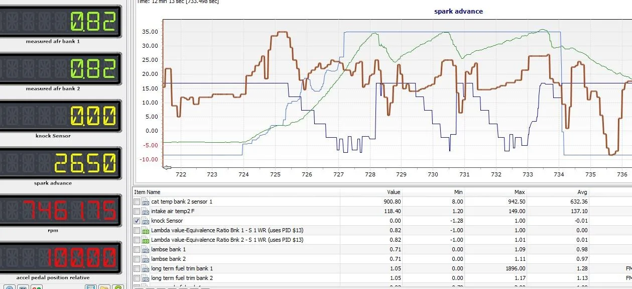

I captured that happening on a data log last week, In my case It feels like it's hitting a soft limiter, Just get a milli-second power cut at the shift., Not a full-on nose over like you hit the hard limiter.
Log shows timing going negative and fuel pump is also being cut.
I presume it's some kinda torque management kicking in.
I was testing an E40 mix and it was a balmy 65 at 4am when I made that run.
I've logged Ethanol Free 89 and had no issues with it, but it was in the low 90's when I made that run.
That video looks like they have something else going on.
