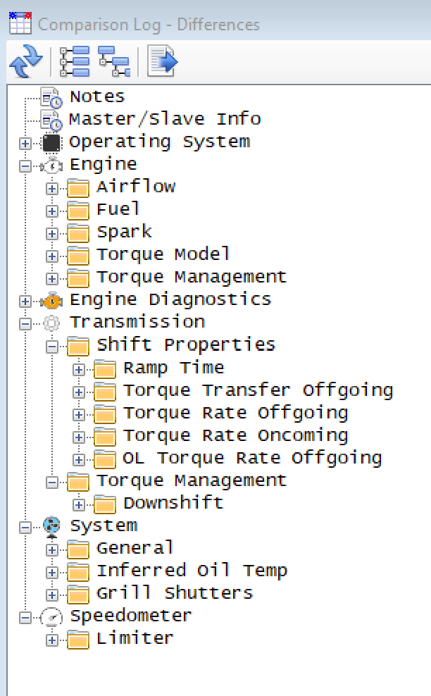

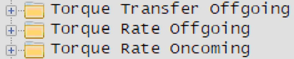

The over the air updates do not incorporate the newer settings?
Depends on the update. I've seen these old setting on several of the early 24's. Not since those though.
These are all the differences between the early 24 and a 26. All of them have hundreds of sub folders and parameters and tables under them.
