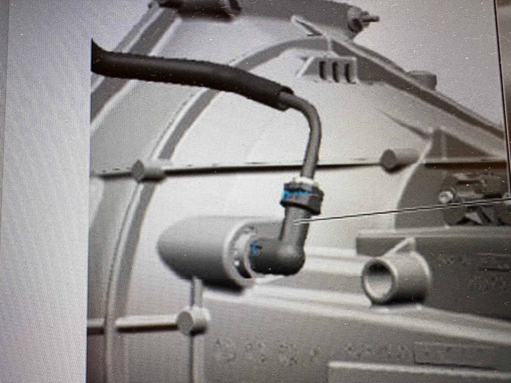

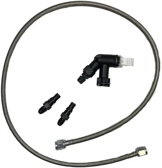

McLeod's clutch line kit includes a new elbow fitting with a bleeder. Why would Ford's OEM peak-torque-limiter fitting or any other aftermarket fitting want a restriction anywhere in that circuit?

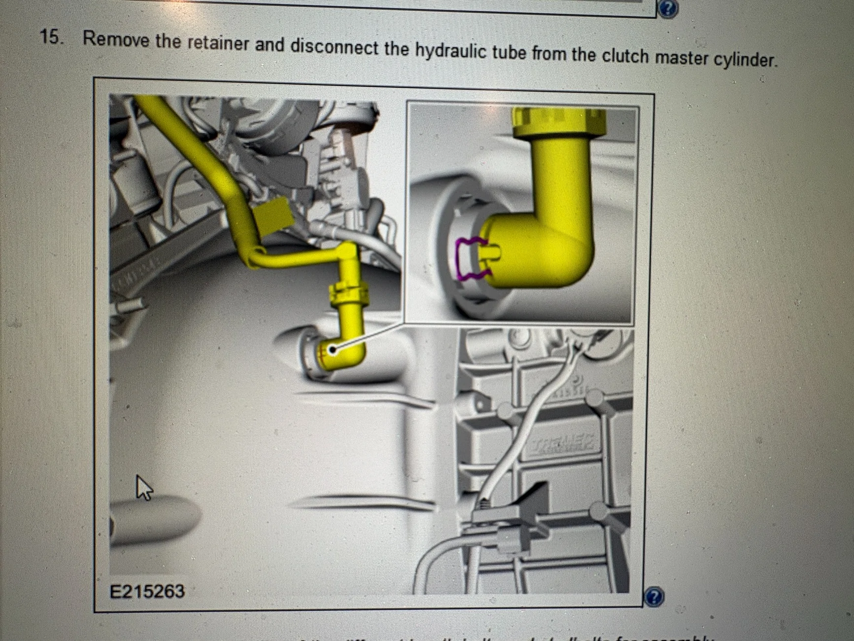

Attached is the 2022 shop manual illustration for the TR3160 clutch line. I didn't realize Ford had the recall referenced in the opening message but the hydraulic system seems the same as the MT82. Why would Ford change any of this on the 2024+ applications, It would be nice to hear from an expert what's unique about this circuit and the 90 degree fitting?

I purchased the Mcleod clutch line and bleeder elbow kit but haven't installed it yet. Will follow up once I do to note what I find as far as what's inside the stock elbow and any differences/improvements/issues with the Mcleod kit.
