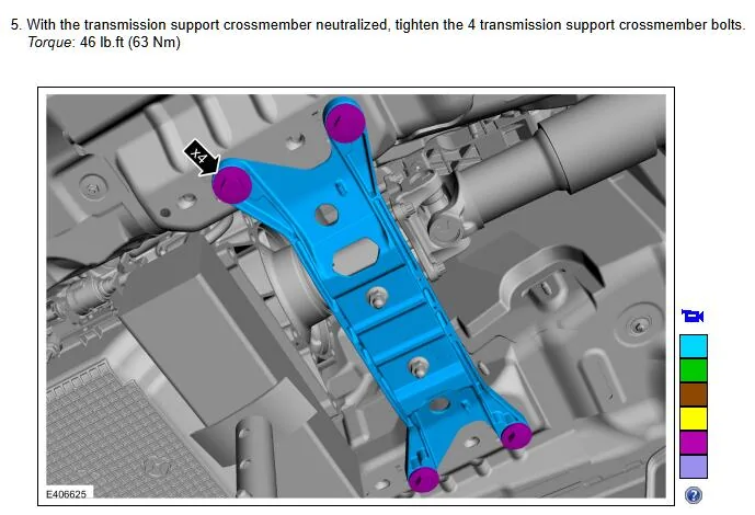

Four bolt cross member and two nut torque specs, such conflicting info....what's the torque? Ford manual seems light and a misprint, to me. Lighter torque on the cross member bolts, heavier on the nuts???? I'm not removing the isolator bolts just the nuts to the cross member and the nuts from the cross member to the transmission.

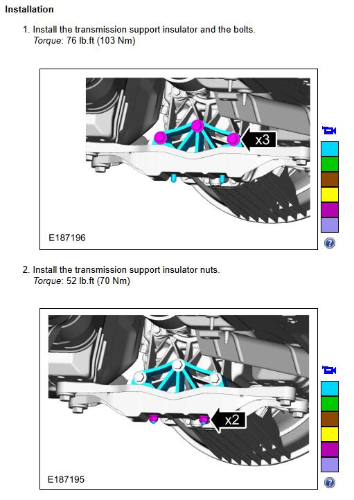

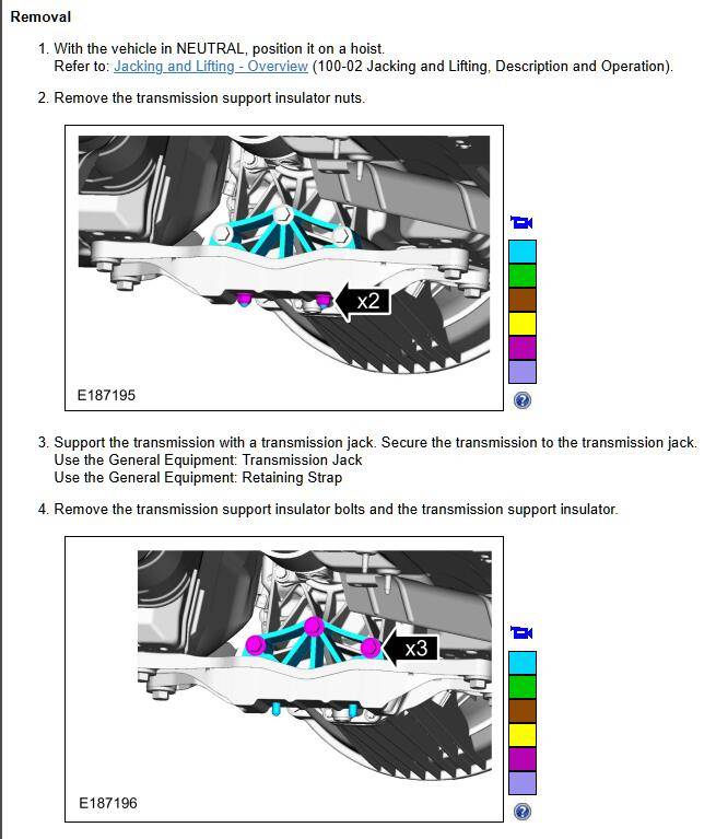

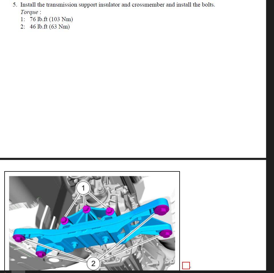

the bolts in the diagram are labeled. it's saying that the torque spec of the bolts that secure the transmission support to the vehicle is 46lb-ft/63Nm, and the bolts that secure the support to the transmission itself are 76lb-ft/103Nm. also, that piece is technically two parts, the insulator and crossmember. here are some instructions i found in the workshop manual

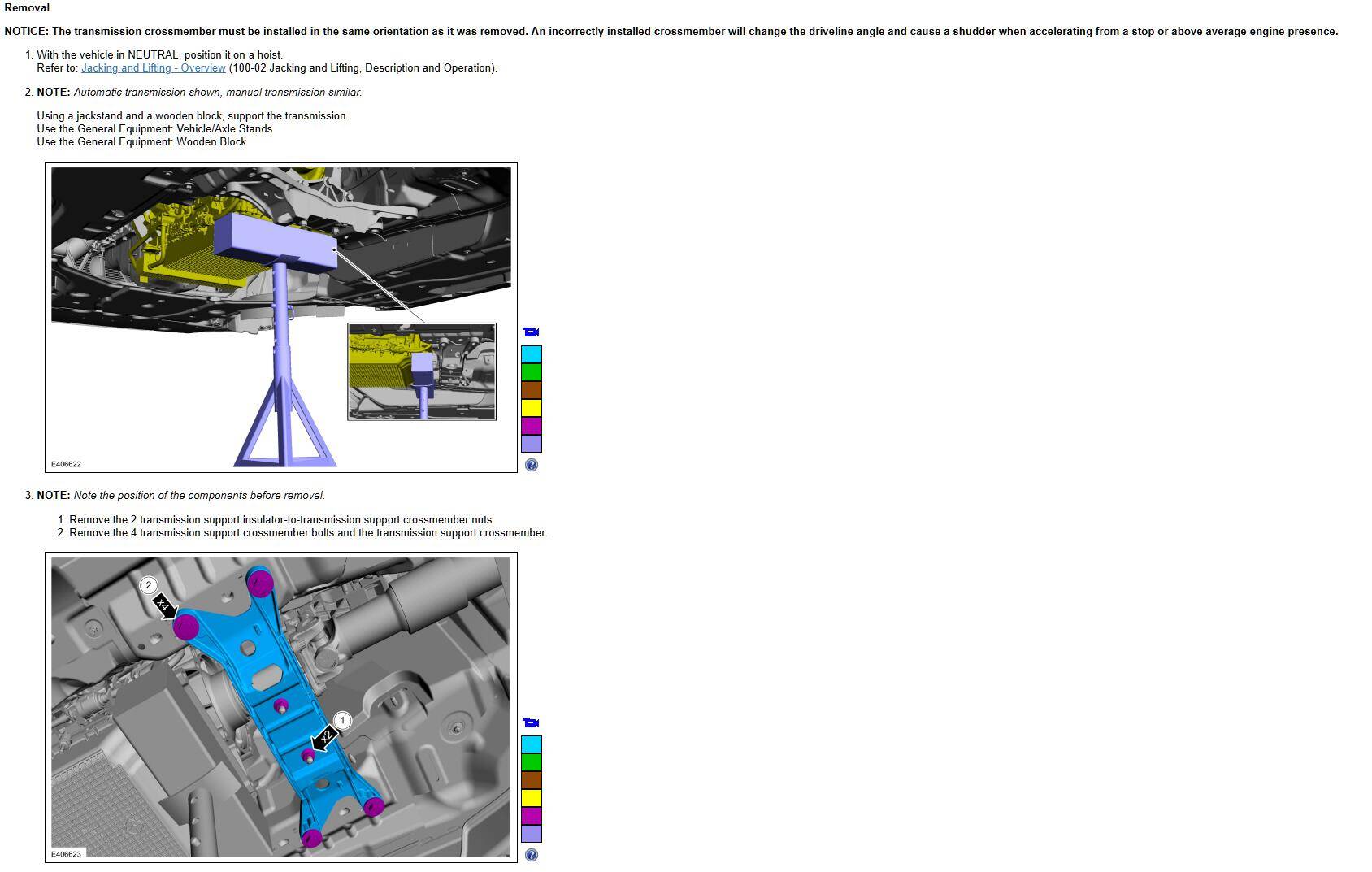

removal:
S650 Mustang Trans bushing install and torque specs 1747466534965-fh
S650 Mustang Trans bushing install and torque specs 1747466587983-b9

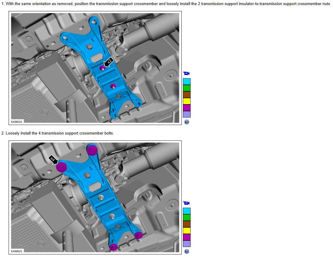

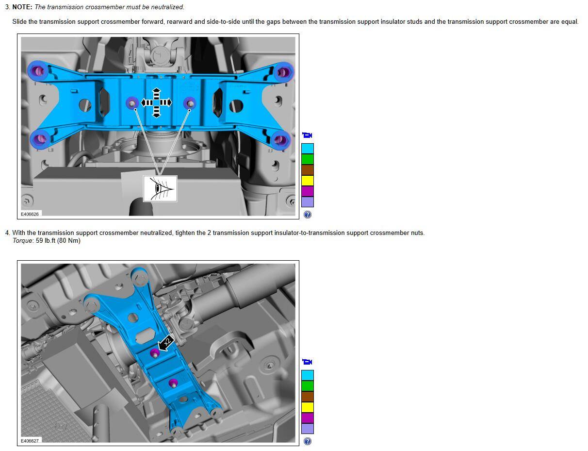

installation:
S650 Mustang Trans bushing install and torque specs 1747466651417-sm
S650 Mustang Trans bushing install and torque specs 1747466676602-th
S650 Mustang Trans bushing install and torque specs 1747466711440-e0
S650 Mustang Trans bushing install and torque specs 1747466769485-zy
