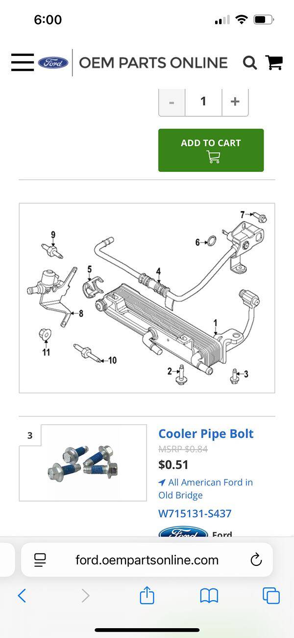

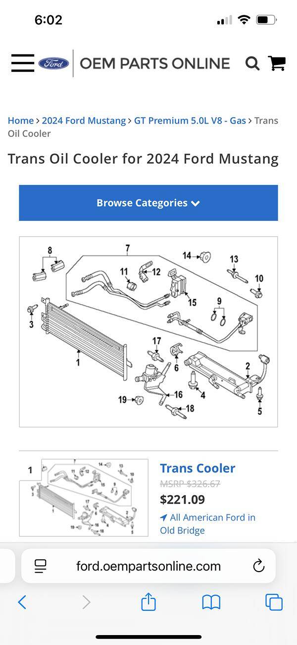

I haven’t been able to find any specific kits made for it. That’s why I was thinking maybe I would just be able to order the additional parts from ford and install it. There just isn’t much information on anyone doing it.

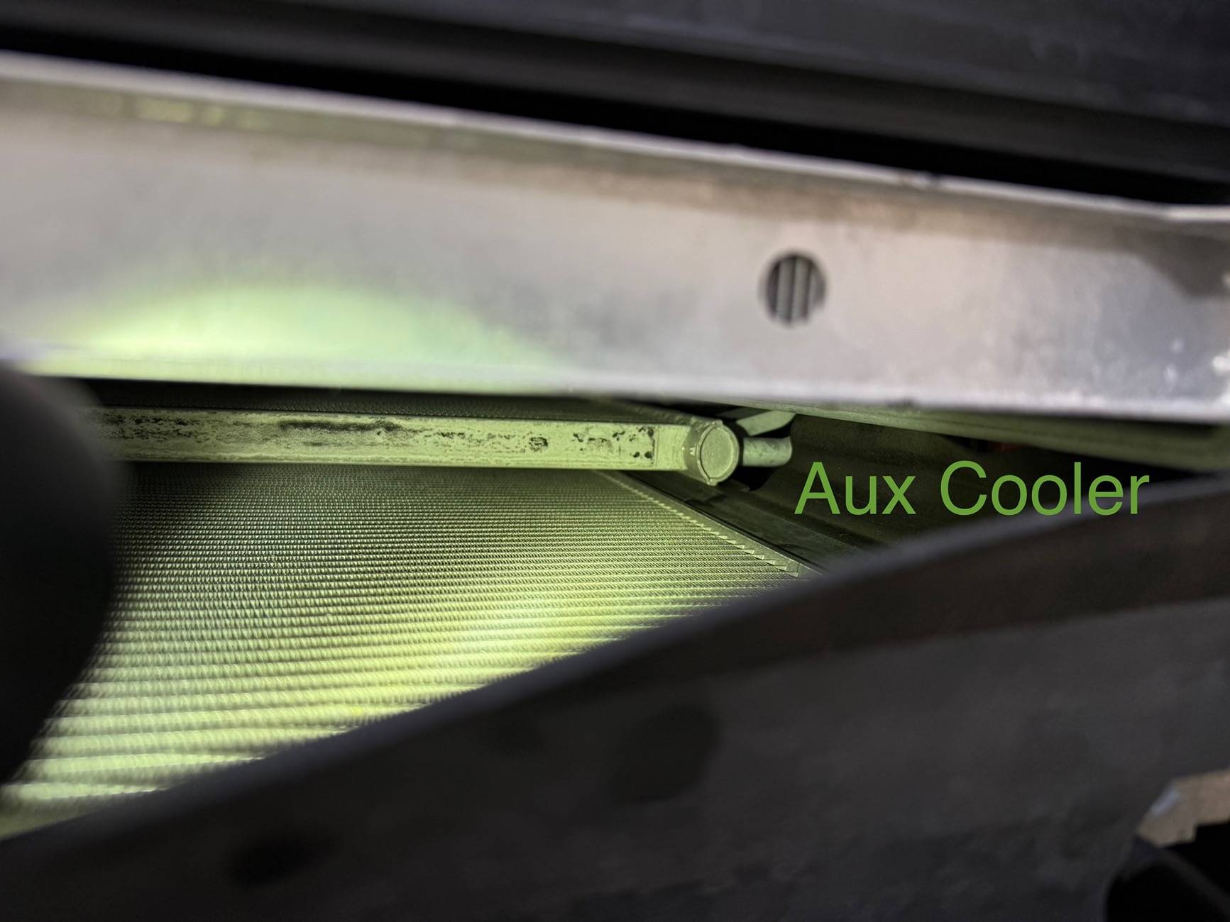

It’s in between the radiator and condenser, so I imagine it would be tough to get it mounted in the factory location. Plus, I’m assuming you would have to swap the radiator over to the PP version for it to fit, but I don’t know that for certain.

Ok I see what you are saying. Wasn’t expecting to be that close. I think when I plan on doing it I will try it and also get a new radiator. It’s already in my plans to change the radiator anyways. Appreciate the help.
I've been planning to add the trans cooler as well recently, I just ordered the cooler and mounting bolt only to check fitment, I did check the area between my radiator and AC condenser and I did see mount locations for one, I think there is just enough space there to put the mounting bolt on, I made a thread talking about this as well as a doc including most of the part numbers and digrams I was able to find. Doc Here
