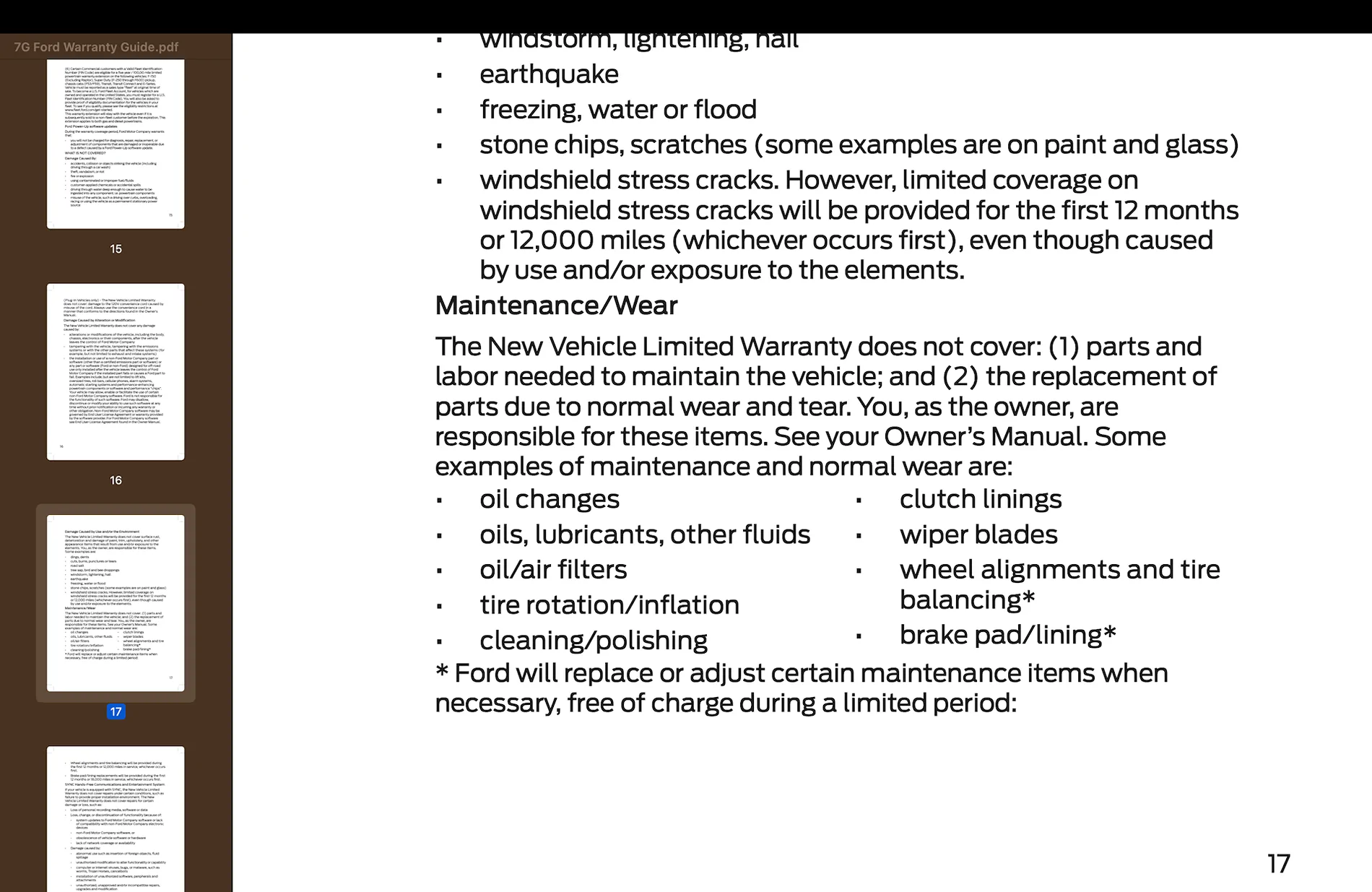

Clutches are considered wear items. If Ford determines the piece failed due to a part defect, incorrect factory installation or by another component acting on it incorrectly, yes. A dealer replacing one post-Whipple...difficult seeing that happen.
Manufacturers cannot define a standard for such items due to so many uncontrolled variables.
It's something any boosted owner would need to consider. Maybe as part of the project budget, set some money aside for a new clutch assembly, then replace once it fails. Depending on the level of boost, add more still for pieces such as axle half shafts and cat/exhaust upgrades.
