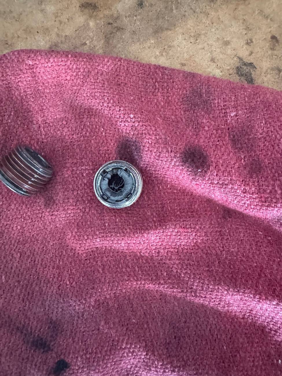

S650 Mustang Replaced my differential fluid at 15k miles, definitely think it is good practice to do so. IMG_7007
So recently I decided it would be good to replace the differential and transmission fluid in my car just to get all of the break in stuff out of them. A little bit excessive? Maybe, but I like taking care of my cars. I replaced with BG ultra guard LS from op mustang. Great kit with very detailed instructions. The magnet pictured above is on the fill plug and the drain plug on the bottom had about 2x as much. As you can see, a lot of debris for only 15k. The fluid was also black.
This was a very easy job. The only thing I’d say it would be good to pay attention to is to ensure that the car is as close to level as possible so that you get the fill level right. Capacity is 1.6qts but the kit comes with a little fill indicator as the spec is about 9mm below the fill port.

Great practice to keep up with maintenance. Since normal maintenance interval is at 150,000 miles for differential fluid and you did at 15,000, I assume you drive the car hard as in truck racing. You did not mentioned if you used the friction modifier additive. Does the BG ultra guard already come with it?

Yes I tend to drive the car pretty hard. The friction modifier is already added in since it's the "LS" version of the fluid so no need to add the stuff from Ford.

172,000 miles on my 07 GT with no differential fluid change. Have never done that on any car and never had a problem.
Doesn’t mean the effectiveness of the limited slip hasn’t decreased due to lack of fluid changes.
