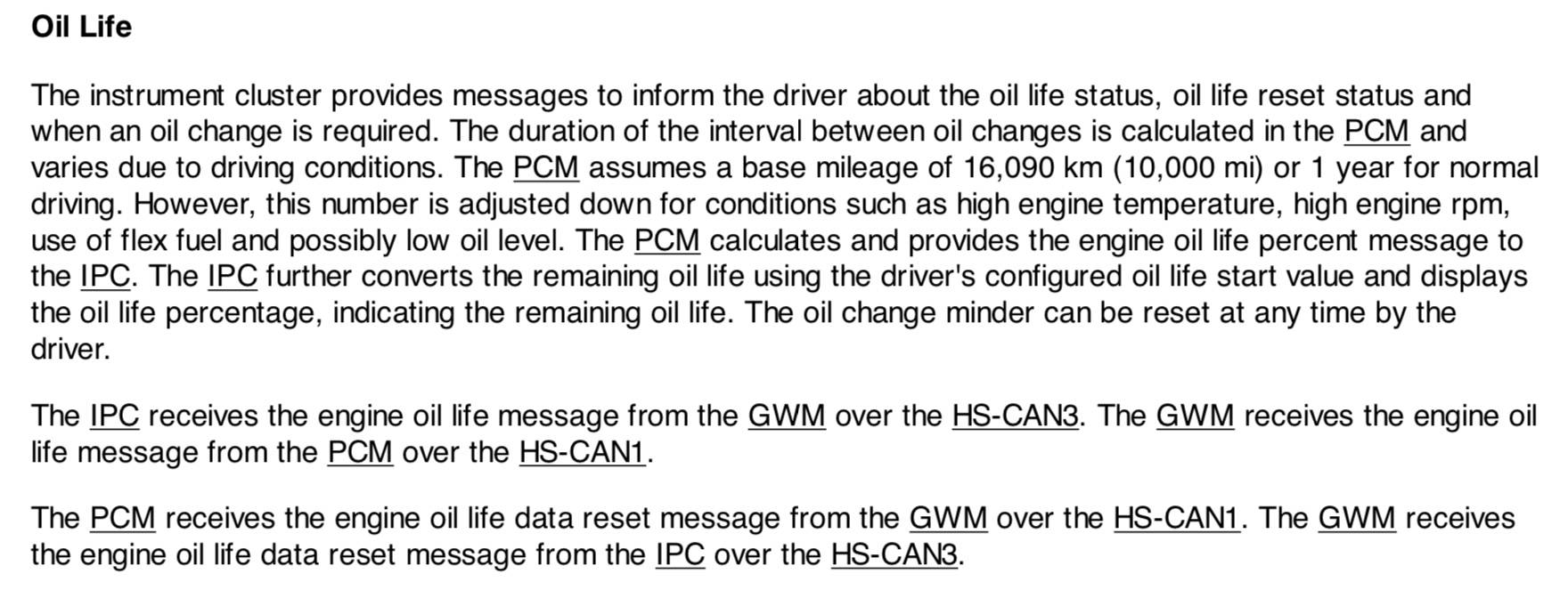

The OLM watches a variety of variables to determine how quickly to countdown. Time, RPMs, how long driven each drive, temperatures, mileage, etc.
At one end of the spectrum, if you change the oil today, reset the monitor, park it and not drive it, the counter will reach 0% in one year. -1.923% a week. At the other extreme, for those that track often, the counter will tick down much faster.
Attached is an technical explanation, by Ford.
GWM - Gateway Module. A switch, linking the different networks, internal to the car.
HS-CAN - High-Speed Controller Area Network. The Mustang has four, linked by the GWM.
IPC - Instrument Panel Cluster.
PCM - Powertrain Control Module. Monitors and controls the engine, transmission and accessories.
