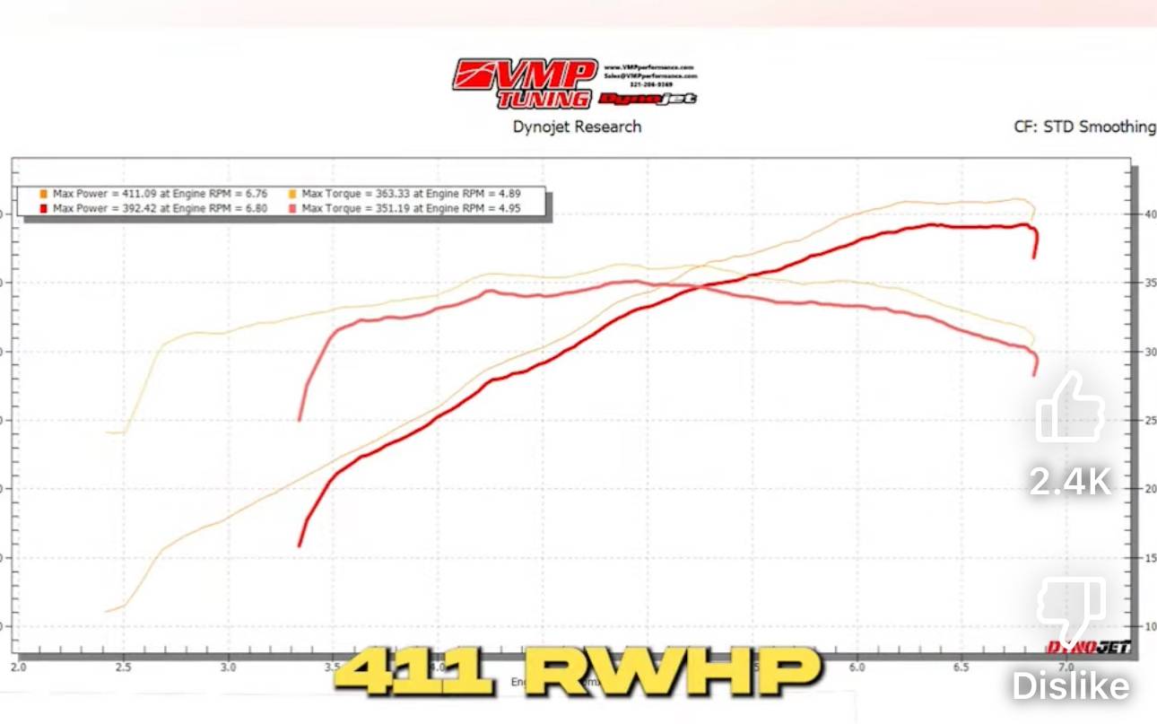

3,020
3,011
There were some people that dynoed the 24's when they first came out, full of 87 from the dyno
VMP added some Boostane to make "93" and gained like 20hp
S650 Mustang PREMIUM-VS-REGULAR GAS FOR 2024 GT?? IMG_7419
So hardly noticeable daily driving? What's that 2 tenths in a 1/4 mile or something?
