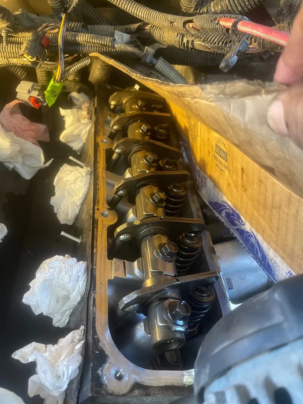

@robvas .... agreed. We tore down many engines in my youth at my grandfather's shop. You could easily see who ran their engines with longer oil change intervals. The minute you turn the key after an oil change acids, water vapors and contaminants build. With a FULL synthetic and good oil filter in our Mustangs I would change at absolute max. 5K.
Here’s inside the engine of my 2008 wrangler (had to replace intake gasket) with 100k miles always on full synth changed every 6 months.

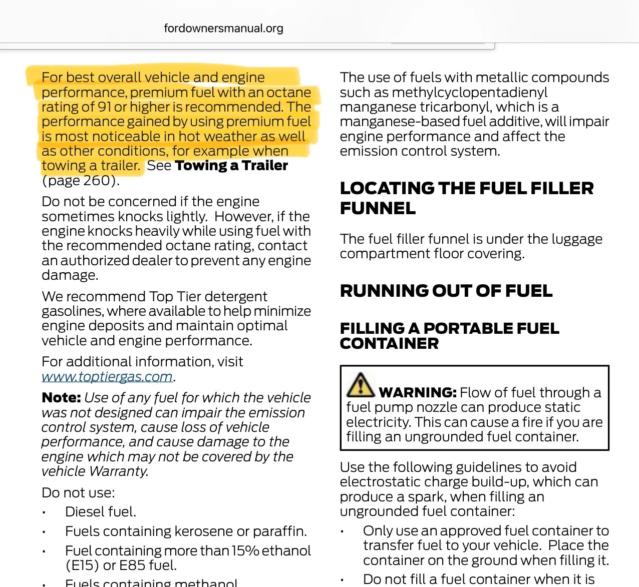

Regular vs premium which is better for an engine? Both use the same base with more or less octane additive. Premium gives more hp. By goosing up the hp, cylinder pressures are increased and consequently bearing, rings and every component in the drive system. You decide which is better for your car.
Octane is primarily an anti-knock rating, the secondary benefit is more hp as the timing can advance with higher octane.
Ford says do not run lower than 87 octane, so yes, 87 is the bare minimum. But guess what they also say?
Seems Ford has already decided what is better for your car…
