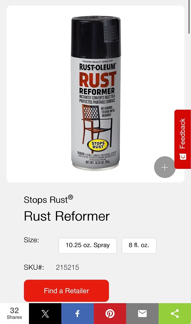

I was looking into https://www.rustoleum.com/product-catalog/consumer-brands/stops-rust/rust-reformer would this accomplish the same goal?

All you will need to do is remove any loose rust and paint, the product will encapsulate the rest.
TheGrabberBlueGT2024
Jan 27, 2019
351
159
Remove how? Did you catch the rust oleum product I posted?
SSuperDave
Nov 5, 2023
525
718
Friendswood TX
Yes, this is what it says...
For Best Results
  • Before applying Rust Reformer, remove any loose rust and dirt, then clean the surface with soap and water.
  • Shake spray can well before and during use.
Jan 27, 2019
351
159
For Best Results

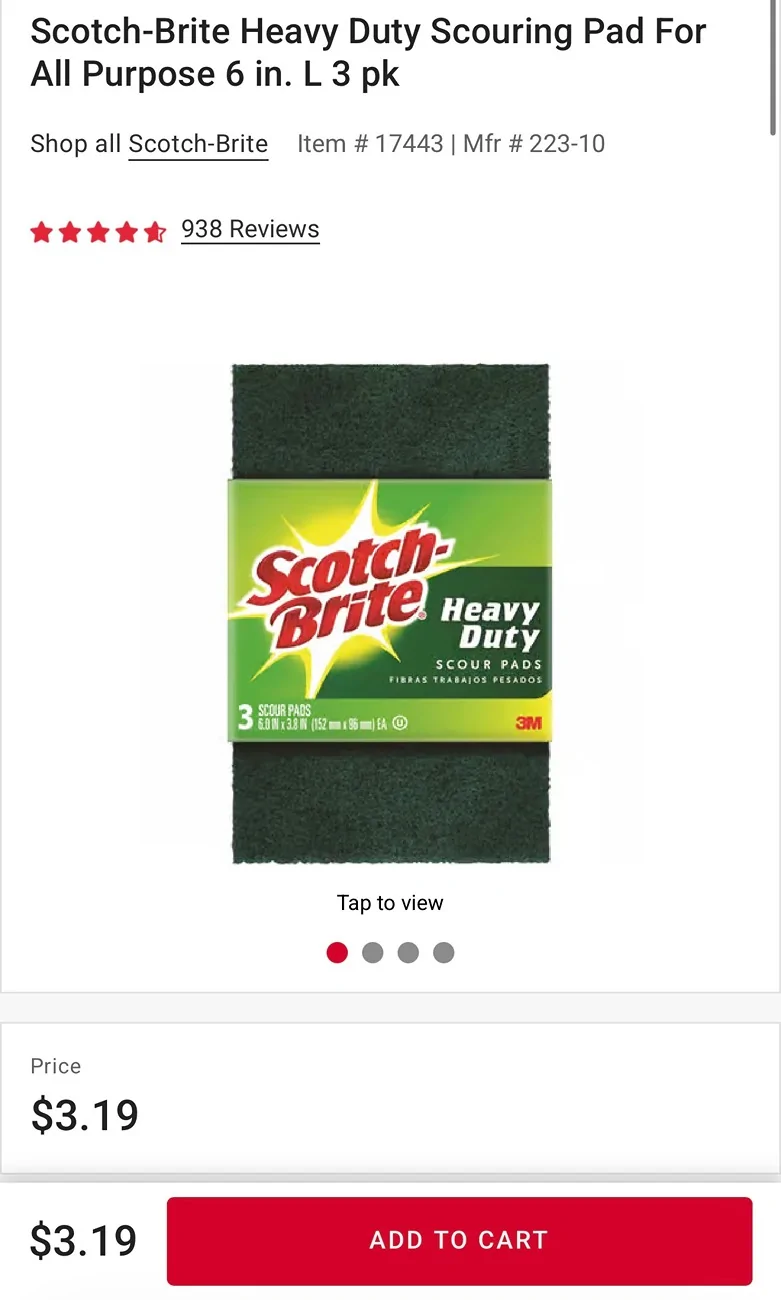

Yeah I just don’t know what they mean when they say remove it. Am I taking sandpaper to it? The product alone is supposed to turn the rust into a paintable surface. That’s what threw me off.
SSuperDave
Nov 5, 2023
525
718
Friendswood TX
A scotchbrite pad will work, any flaky stuff has to go. Sanding is not necessary. I've used similar products before with success. They turn the rust black and the finish is very hard.
Jan 27, 2019
351
159
With such a small area it looks like I will be doing this with a paint brush.
Jan 27, 2019
351
159

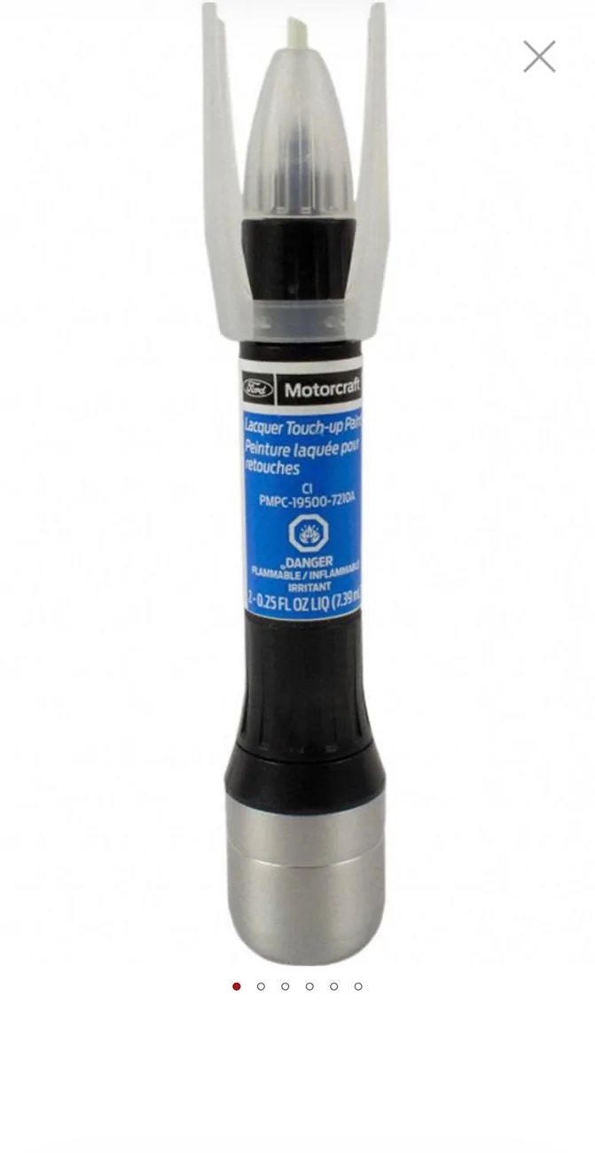

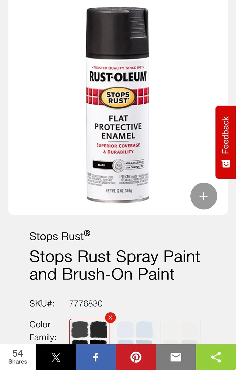

For anyone wondering it looks like the best route will be a scotchbrite pad for gentle agitation as @SSuperDave suggested then rust reformer. The product label states that oil based paint can be used to go over it within 4 hours and 3 days for lacquer paint. I have a brand new genuine ford paint pen which is lacquer. My plan of attack will be pad then rust reformer then I found rust oleum oil based enamel flat black paint. That will provide protection until I put on body color paint and hopefully by then franks solution will be close in the mail and I can put this nightmare behind me.
