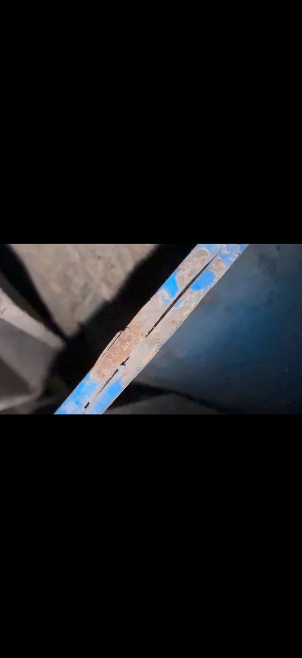

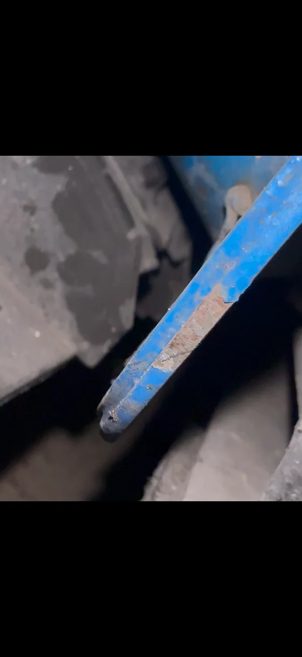

Got with frank and purchased his solution. I am sadly a year too late this issue should be highlighted for all to see. I can’t make out if this is rust or lots of dirt and what steps I need to do to fix this correctly. Thanks for your feedback. What a letdown to start the new year.
The paint has chipped off and there is a small amount of surface rust. Treat with a rust converter such as Kurust and then underseal over the top. Fit a patch if you want to but it isn't essential once the underseal protection is in place as it will no longer chip off.
Hammerite Kurust - Paint | Hammerite
I was ridiculed on here by some people last year when I said I had treated my car in this way but 12 months later it is still completely fine with no rust or chipping on that metal, and my car is a daily driver that gets salt and spray all over it.
