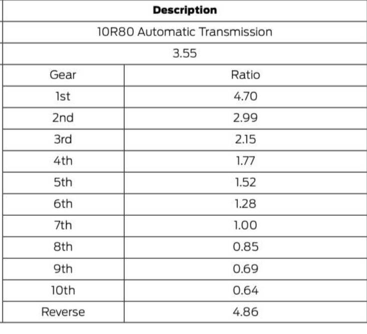

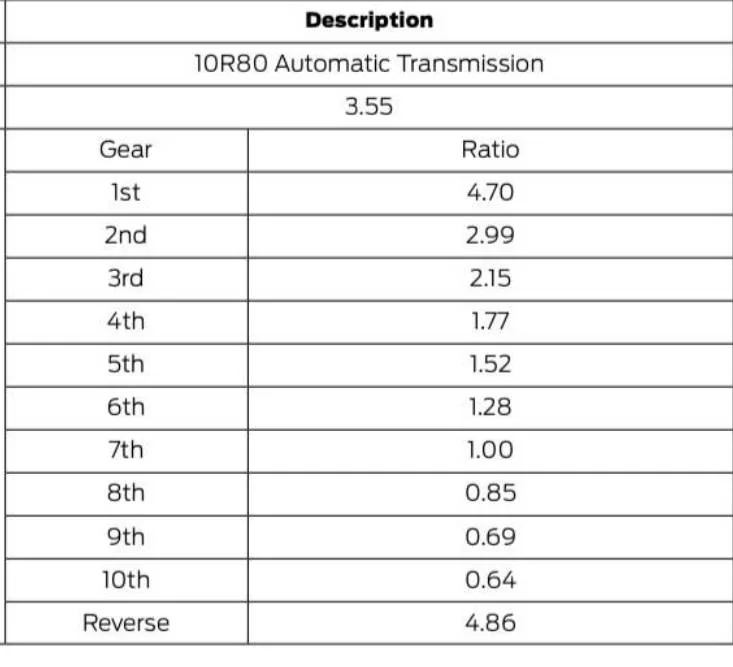

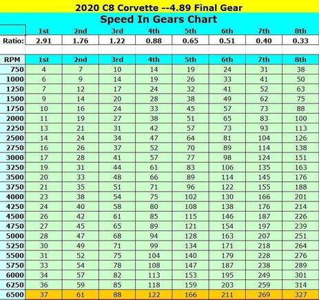

I'd say the big problem with base mustang vs base c8 is more the difference in tire size and axle ratio vs engine power.
255/40 on 8.5" wide rims and 3.15 final drive vs 305/30 on 11" wide rims and 4.89 final drive.
Now compare the trans ratios in the C8 to the 10R80
