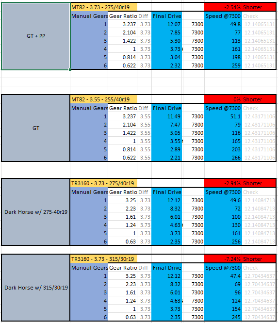

I actually did some math and I think the 3.73 is there to correct wheel size...
The baseline is the regular GT, 3.55, with 255 tires. That's the "long gear" mustang.
Followed by GT + PP with 2.54% shorter final corrected by wheel size.... I don't think it's noticeable. Any 1/4 mile improvement should be because of better grip caused by the 275's and maybe the torsen.
Then Dark Horse w/275 only 3% shorter. 0.4% apart from GT+PP.
Last the most expensive DH with 315's 7.24% shorter. (Caused by wheel + tire).
<a href="https://ibb.co/kQfGhHQ">
S650 Mustang Went to test drive a GT 6spd.... Is low end torque improved in the S650? image
I calculated this using 1st gear as a baseline. Since MT and TR have different ratios, this might affect but its 0.1% ATM when comparted to 1:1 ratios.
Wheel Diameters:
275/40/19
702.6​
mm
255/40/19
686.6​
mm
315/30/19
671.6​
mm

I like my chances.
3,030
3,020
Those tall GT gears are why 4.09's make sense
