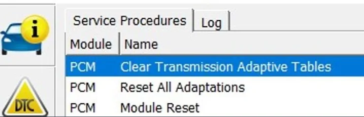

A10 shudder 4th to 5th gear is known and normal, I have it. Also the adaptive learning tables could be acting up. I cleared mine in FORScan and it helped smooth out shifts and no more hunting for gears.
Have you had the trans fluid levels checked? These have been known to be a little low and cause shifting issues.
How’d you clear it in forscan?

Interesting. What changed after? How often must this be done?
Much smoother shifts and no more hunting for gears in Normal Mode, a bit more responsive in Sport and Track. Only cleared it twice, been 6 months now and still feels good, though I have learned where the sweet spots are for the car now. 4K - 5K RPM is where the car wakes up, unfortunately for street 100mph+ happens real quick.
