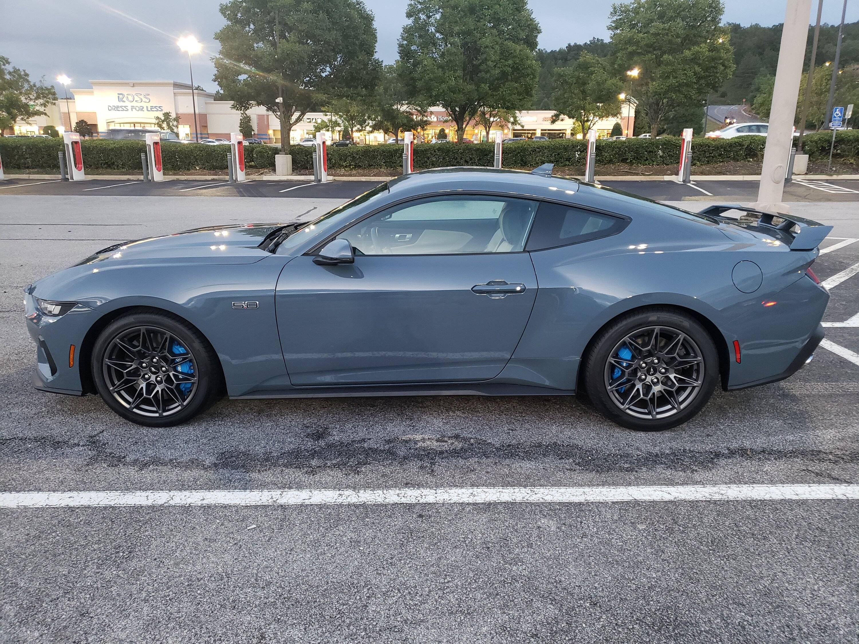

S650 performance GT in for 3rd oil change at 8811k miles. Engine was 1.5 qts low. Transmission, 10 speed auto, also shudders during normal driving. Anybody have any predictions? Ford wats me to leave it with them for at least a week.
