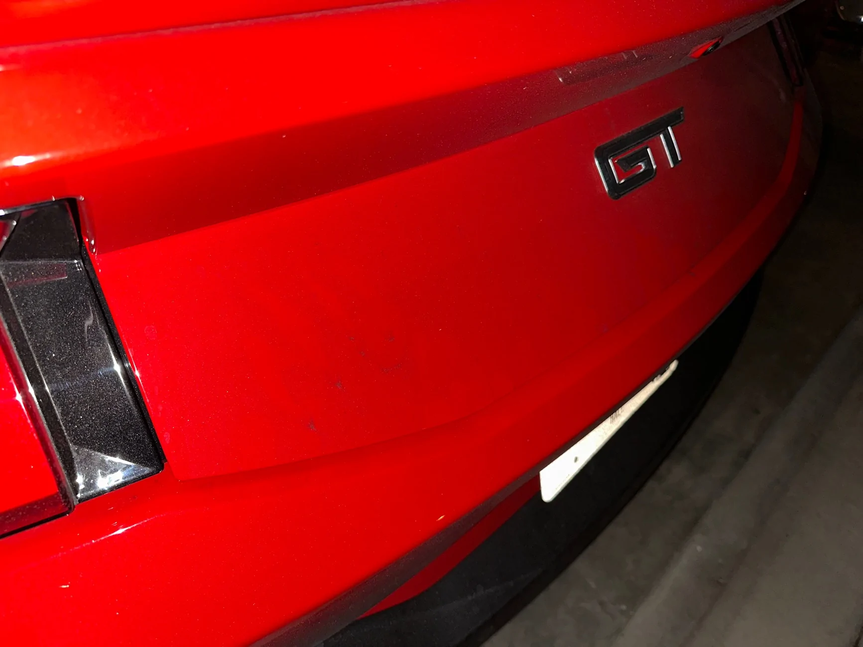

I bought a 2025 Mustang GT late last year and I am also experiencing oil consumption issues. I first checked at around 600 miles and I was at about 40% of the hash marks. I went ahead and scheduled an appointment with the dealer I purchased it at. By the time my appointment came up, I had gotten to around 815 miles, and the oil level had further lowered to about the 20-25% on the hash marks.
They kept it for about a week and said it wasn’t leaking and topped the oil off. They overfilled it, but nothing crazy. Oddly, they put a mark on the dipstick, but the mark was nowhere near where they filled it to.
The whole reason I checked in the first place was because I was seeing oil residue all over the rear end. It’s continued to accumulate, letting me know it’s still sucking down oil, but I know they won’t take it seriously until I am past the 3000 mile mark. Service advisor claims this is all normal, but if that were the case, they should have sent me home with 5 quart container of oil, because at this rate I’m going to need to add a quart every 1000 miles or so.

Your catalytic converters must be soaked/coated if oil is seeping out the rear.

Oil Residue - it’s powder by the time it exits the tail pipes
