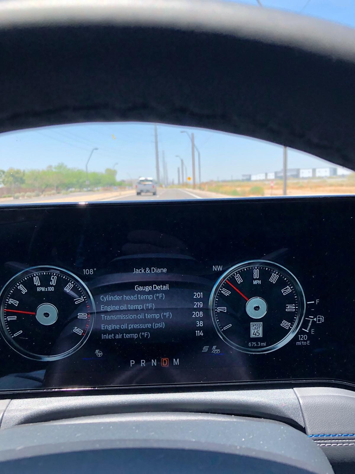

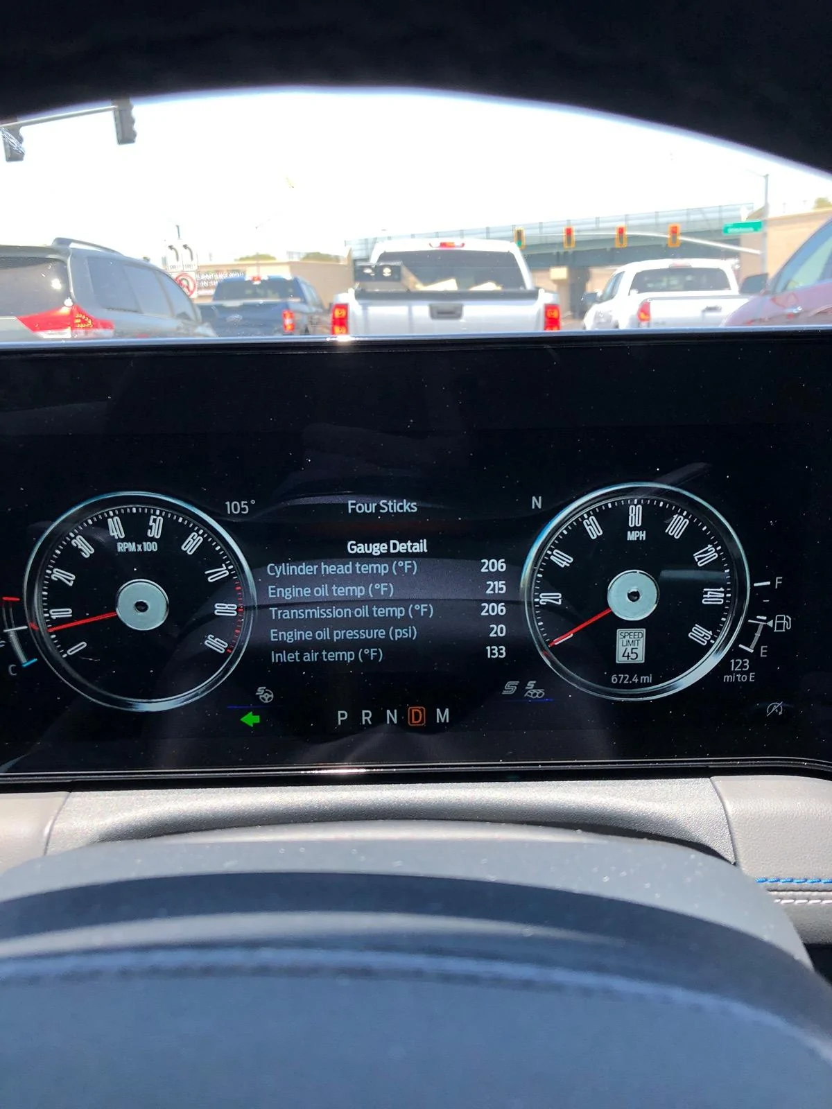

S650 Mustang Normal Oil Temperature for 5.0? IMG_5621
S650 Mustang Normal Oil Temperature for 5.0? IMG_5624
This was this afternoon. As you can see ambient temp 108. Humidity was around 10%. Surface street driving. Never got down to ambient temp.I think it’s probably due radiating heat from asphalt roadway. I never got on freeway to get higher airflow through radiator.

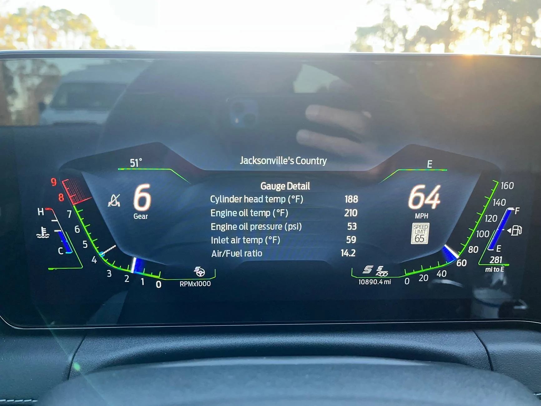

Just seeing this thread. Recently install the OEM oil cooler on my non-PP S650. Oil temps have not dropped as I would have expected them. I am going to install the PP radiator as it is 17mm thicker and should have better cooling capacity which would impact the inferred oil temps. The picture is from earlier today. Hoping to install the rear diff temp sensor and harness later next week.
I was using forscan and passed a setting that can be changed for weather or not it has an oil cooler, you may need to have that changed.

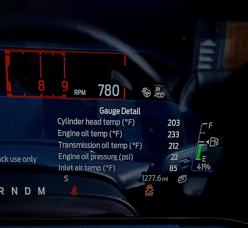

I have a s650 non pp at just over 16k, its temps hover at 235 while cruising with ambient temp of 78 on flat freeway at 75 mph. The temps have only been rising since i passed the 10k miles mark. I cant do a full canyon run anymore as temps regularly reach 280f. Ive complained to ford multiple times as it drops me into limp mode...
At 10k miles the average temp was roughly 210
Spirited it reached 230
At 13k miles it was 230
Spirited it reached 265
Now at 16k its 235
Spirited it reaches 287 (limp mode kicks at 280)
I think they need to recall them to get the oil coolers put on.
