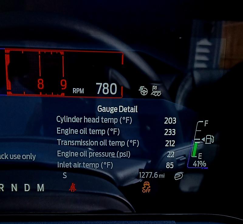

Stock GT A10, after a short spirited ride, idle, 75° outside.... I think my oil temp and A10 oil temp might be tad high?.... She seems to run hot, Parked in the garage, hour later pop the hood, everything is still hot to the touch.

5.0 performance pack with everything on it - highest I have seen is 202. Normally, I hover around 198 and that is when taking off hard every chance I get. I googled safe oil temperature a couple of weeks ago and found answers ranging from 225 - 260 to be safe.
@JAM486HP perhaps you aren't getting enough airflow while idling in the garage?

The screenshot was taken outside just before I garaged it. I shut it off, an hour later in the garage to check oil level, many components still hot to the touch. The garage is well ventilated and it's only 75 today. I even checked for any obstructions. Funny thing I was considering a K&N, though yesterdays post with dyno results wee not impressive.

DH in AZ, i normally see oil temps around 200-215F. if i put it in M and hold the gears, i can get it to 235 or 240, but the vehicle idles higher at a stop when the oil is at 240F or higher
Stock GT A10, warmed up, idle, 75° outside.... I think my oil temp and A10 oil temp might be tad high?.... She seems to run hot, Parked in the garage, hour later pop the hood, everything is still hot to the touch.
if those are the idle temps, then that is alarming. those temps are more along the lines of "i just got home from work and had fun in M mode", especially the transmission and engine oil temps
Apologies, I clarified my post, I did take it for a 10 minute ride, came home and sat idle when I took the screenshot

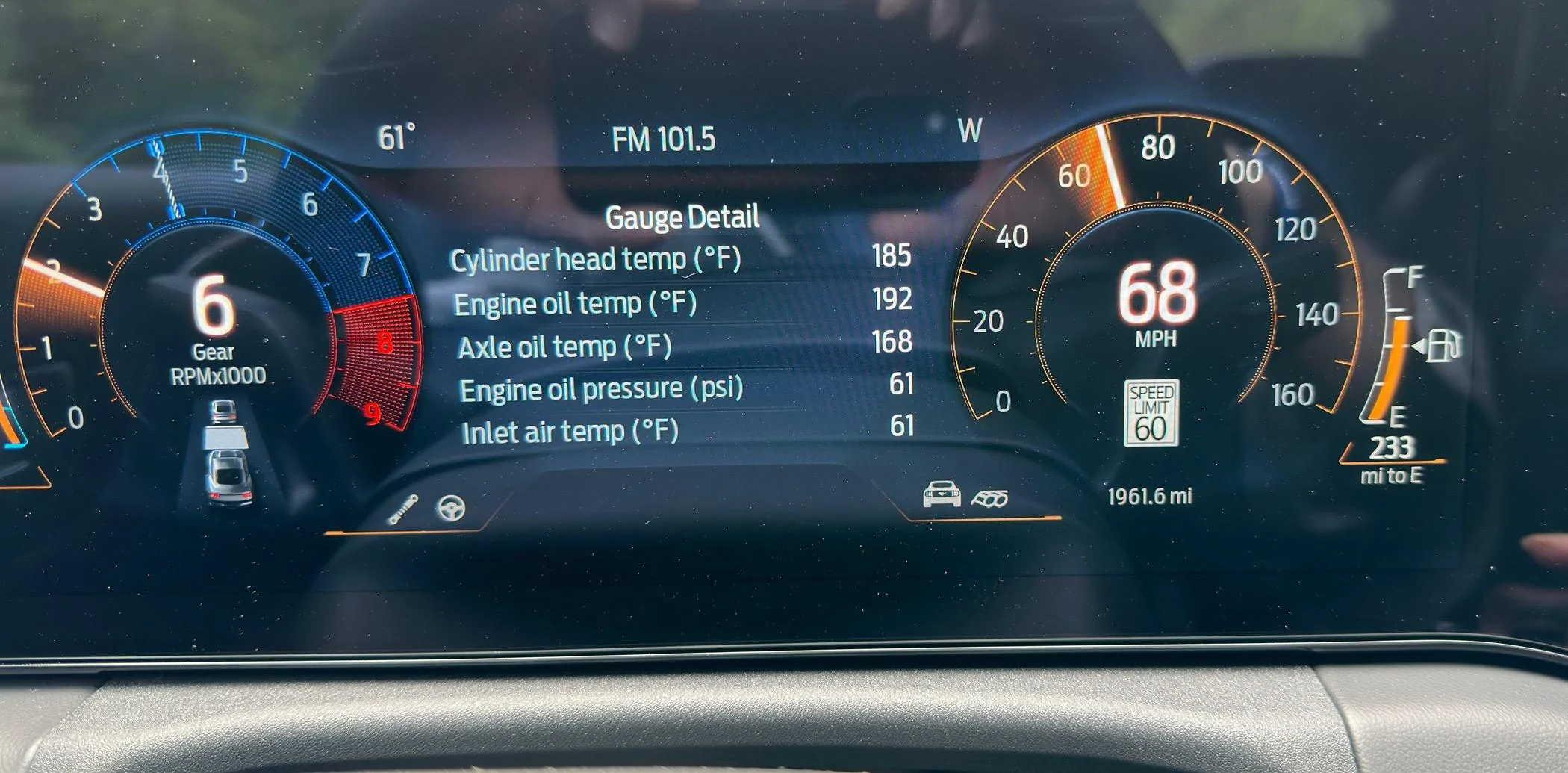

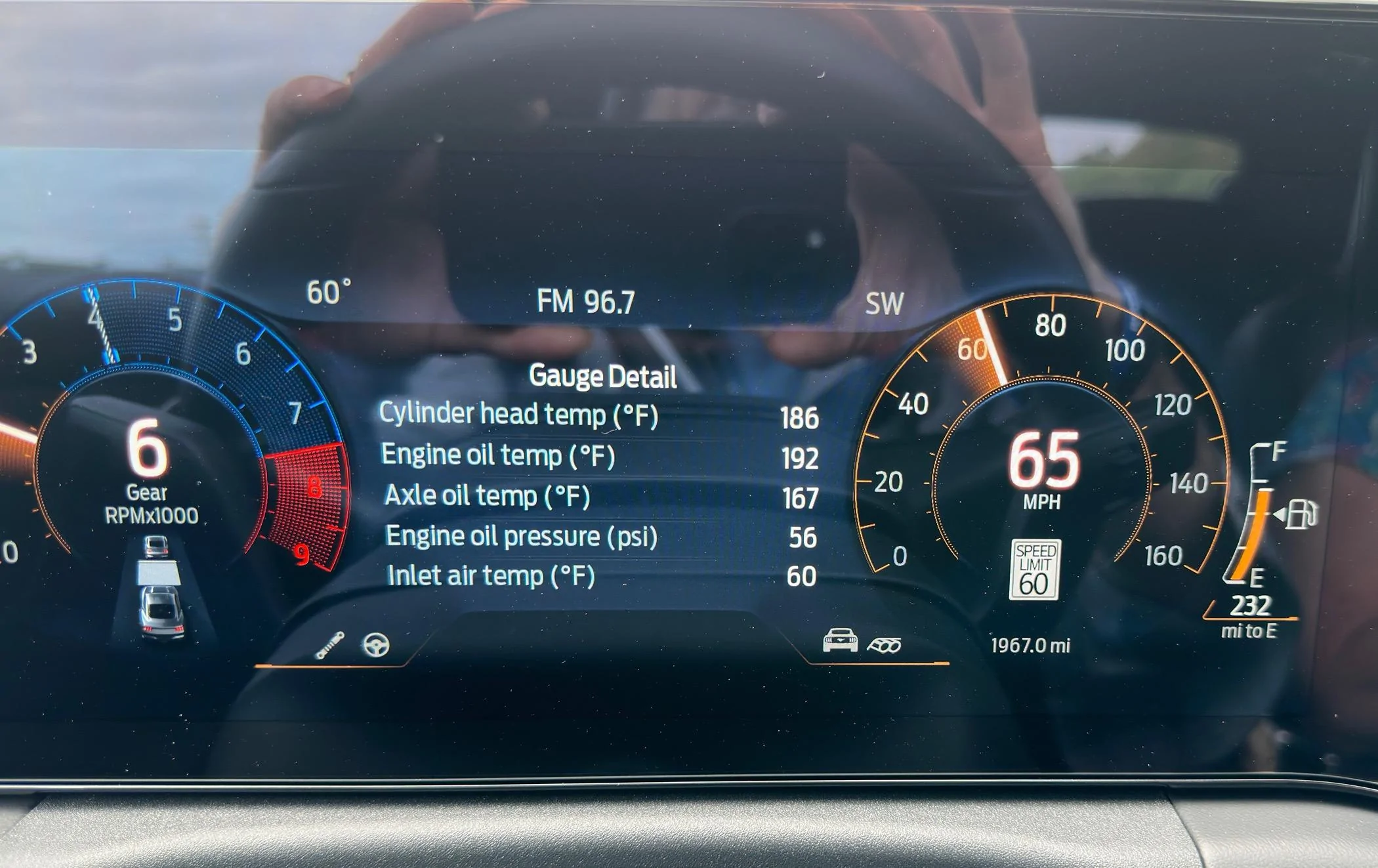

Around 6 miles apart on a 60 degree day:

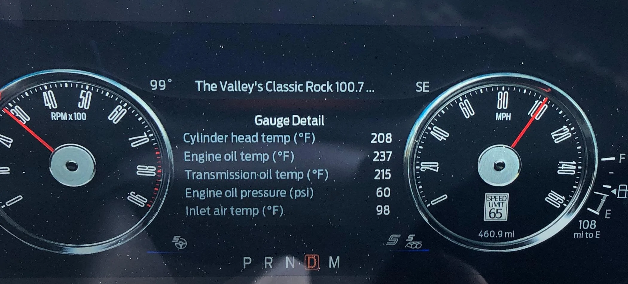

This was back in late April. Hope to go out for drive later this week and see what the temps look like when it’s around 110.
