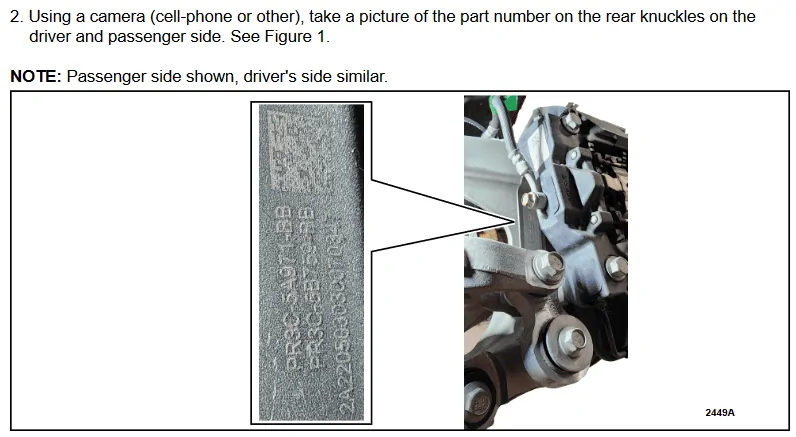

I checked my knuckles today and what a pain in the ass to see the serial numbers. To get a good look at the numbers with the cell phone, I had to take off the caliper. The caliper is held in with the longest caliper bolts I've ever seen, about 4"s long. Putting the caliper back on, I had to use the pad spreader tool to get the pads over the rotor. My serial numbers are good so far. I wonder why each knuckle is serialized?
^ in that case not looking forward to checking, there has to be a better way. Mirror or hold phone here type of thing?

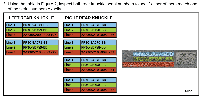

if the serial number matches, take it to your dealer so that they can replace one or both for free under warranty
Do all 3 Lines have to match?
I just checked my Left Side and Line1 and Line2 of the first Match but the 3rd Line doesn't.
2,681
4,068
I just checked my Left Side and Line1 of the first Match but the other 2 Lines don't.
all 3 lines
Deleted member 17846
Guest
all 3 lines
OK, I rechecked and edited my post, I have 1 & 2 Matching but not the 3rd. Going to check the right side now.
Looks like I'm good, luckily the last line on both don't match any.
I used a borescope to see the engravings and it was still challenging but a lot easier then pulling parts off.
I took it to mean the first two lines are the part numbers and the last is the serial.
How much of a pain and did you have to remove the caliper to check?
ah, just saw borescope … hhmm.

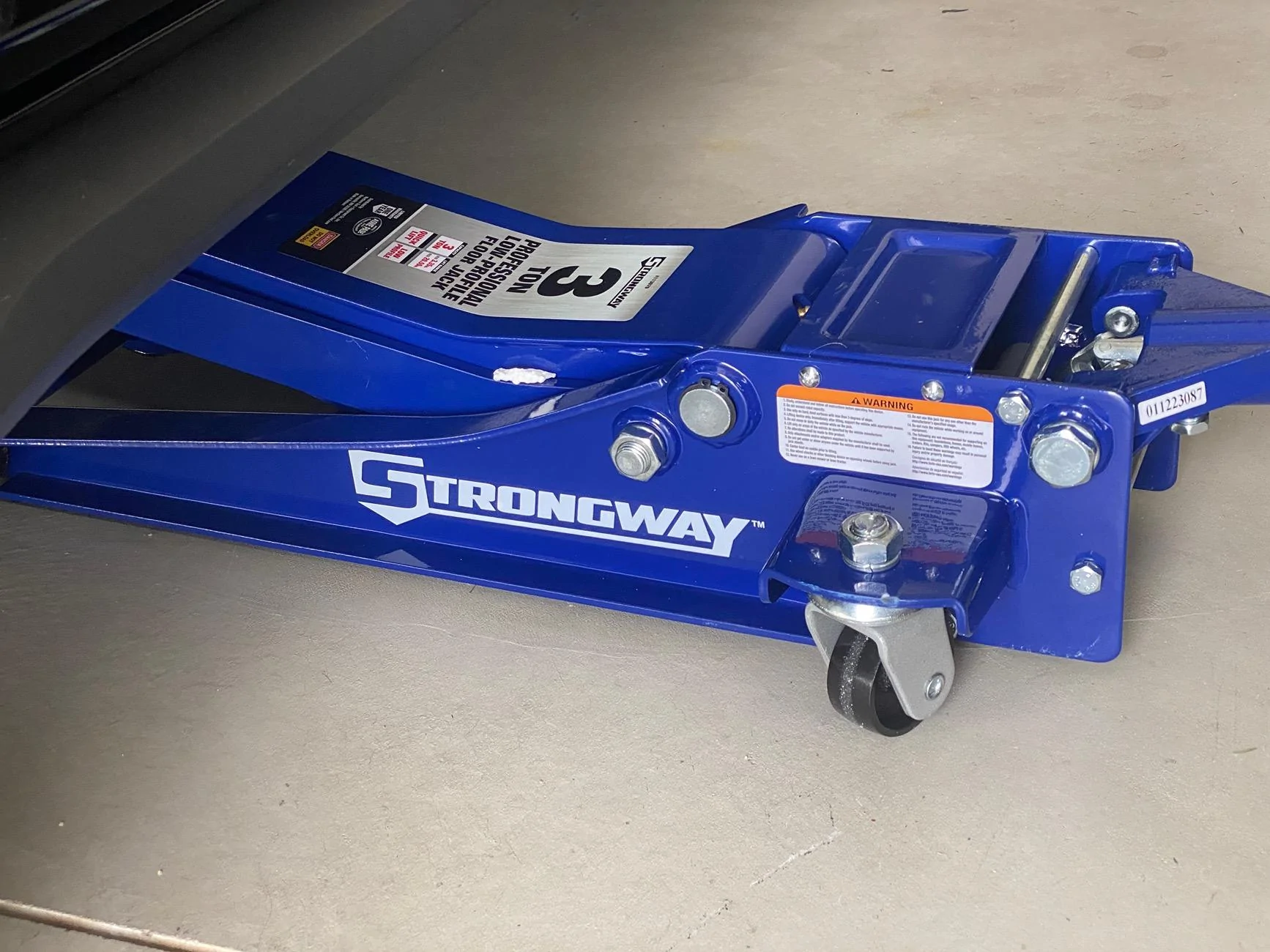

Fortunately I had Steeda’s jack bar put under my car and will be getting a new jack lift in the delivery so I can jack soon and take the wheels off to be able to check the the numbers! And hopefully I don’t get a notice from the Ford company but I will check just to make sure I didn’t miss the recall as well!
Finally got my jack yesterday!
S650 Mustang NHTSA 24S49 Safety Recall - Inspect Rear Knuckle IMG_2953
And also a hockey puck that only cost me $3.51 and put it on the lift spot of my jack under my car!

Just inspected my knuckles... all good. Got pics for dealer to mark off the recall.
I removed the tires... was able to get (phone) pics without removing brake calipers.

Someone correct me if I'm wrong, but I think the image above is of the driver's (left) side, although the "Note" says it is the passenger side. Even the second line of the serial numbers match up to the left rear knuckle. Am I looking at it incorrectly?
