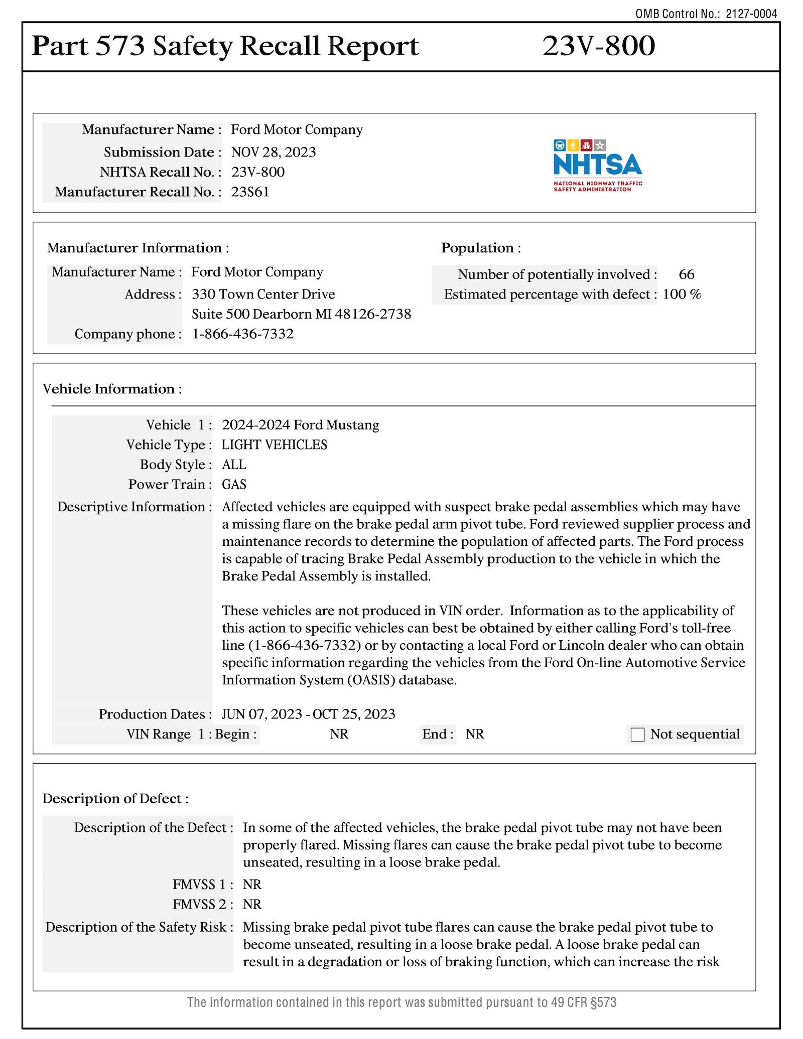

AFFECTED VEHICLES
Vehicle Model Year Assembly Plant Build Dates
Mustang 2024 Flat Rock June 7, 2023 through October 25, 2023
REASON FOR THIS SAFETY RECALL
In some of the affected vehicles, the brake pedal pivot tube may not have been properly flared. Missing flares can cause the brake pedal pivot tube to become unseated, resulting in a loose brake pedal. A loose brake pedal can result in a degradation or loss of braking function, which can increase the risk of a crash.
https://www.nhtsa.gov/vehicle/2024/FORD/MUSTANG/2%2520DR/RWD#recalls
https://static.nhtsa.gov/odi/rcl/2023/RCMN-23V800-3131.pdf
Number of potentially involved : 66

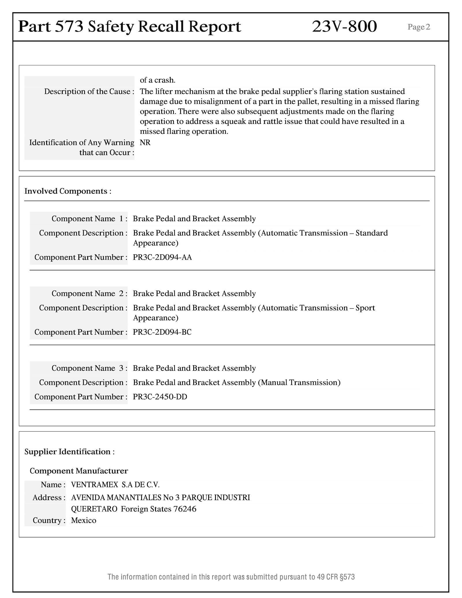

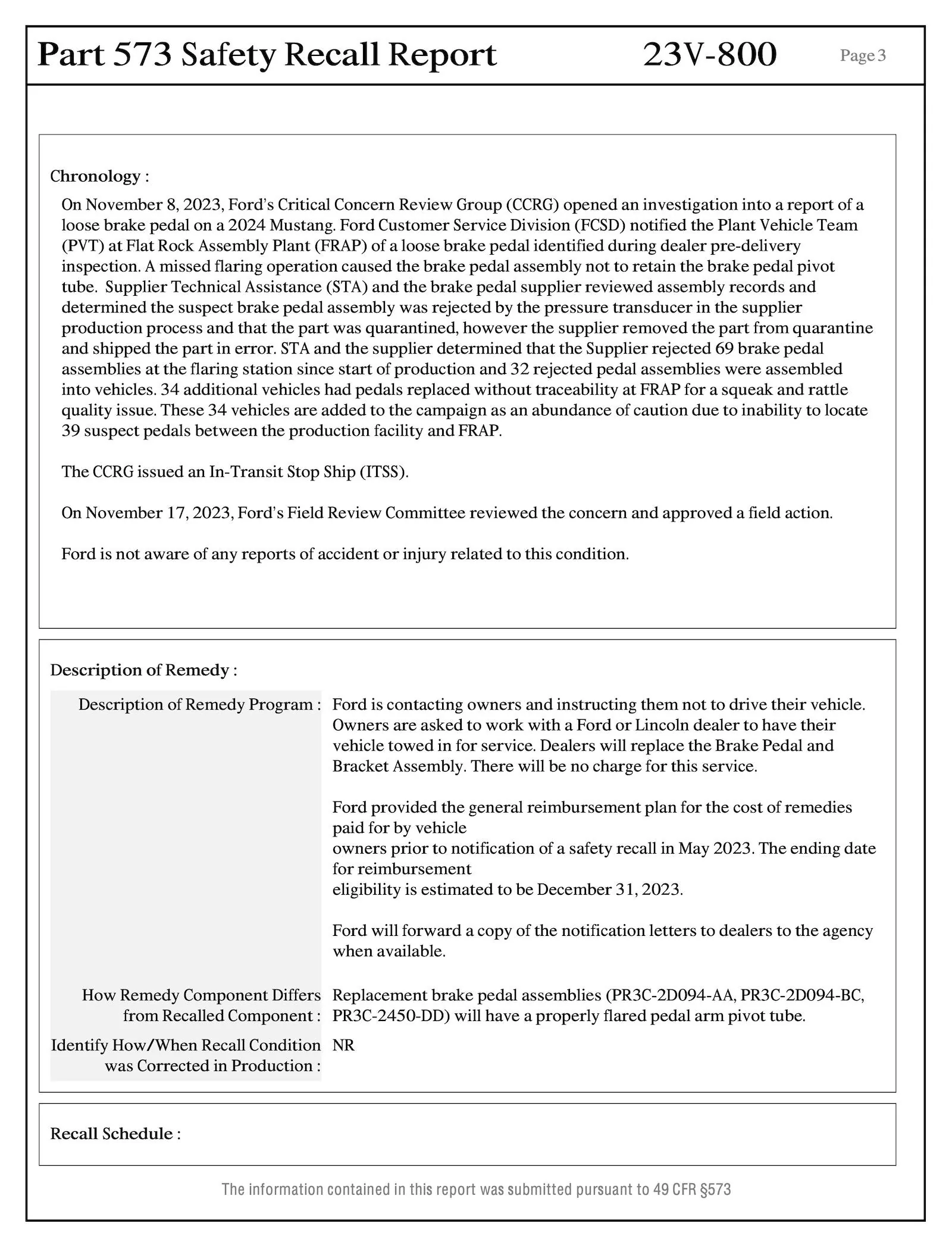

We have our first recall for a loose brake pedal. Build dates are from June 7 - Oct 25. Apparently Ford is advising owners not to drive their cars until the loose pedal is fixed. As hard as Ford tried to get this rollout right the suppliers made sure there would be at least one. I'm in this window, too, by 5 days.
