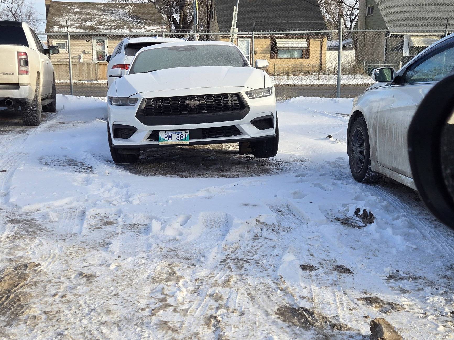

Giving this thread a bump.
Attached is a photo of a car whose knuckle failed.
This car had exited a touch-less car wash moments before. I suspect, speculate, the dramatic changes in temperature weakened an existing fracture point to failure. Maybe that broke it. 🤷‍♂️ Maybe it was going to break anyway. 🤷‍♀️
If you are not familiar with the recall, this bump will help with that. As to this person, everyone is OK. The car has a busted suspension and rotor damage; it's at the dealer.
There's an existing thread in the 6G forum, but no more details other than presented here.
S650 Mustang NHTSA 24S49 Safety Recall - Inspect Rear Knuckle knuckle failiure
