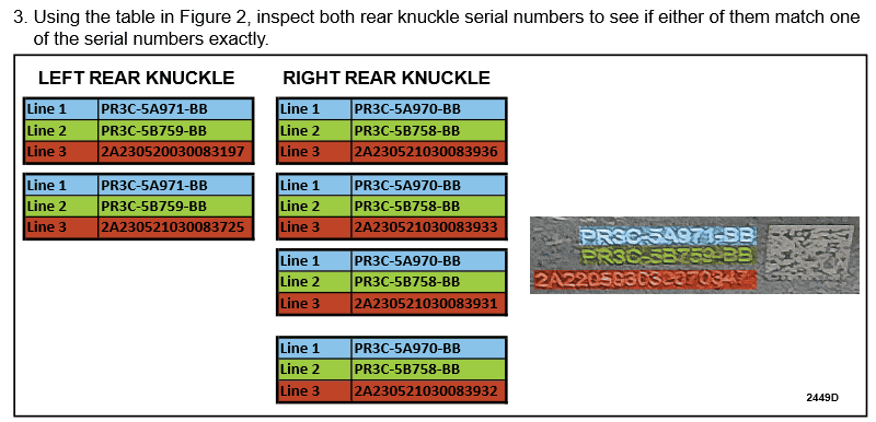

For those able to do so, Owners can confirm serial numbers themselves, with the information in Post # 16.

I checked my knuckles today and what a pain in the ass to see the serial numbers. To get a good look at the numbers with the cell phone, I had to take off the caliper. The caliper is held in with the longest caliper bolts I've ever seen, about 4"s long. Putting the caliper back on, I had to use the pad spreader tool to get the pads over the rotor. My serial numbers are good so far. I wonder why each knuckle is serialized?
