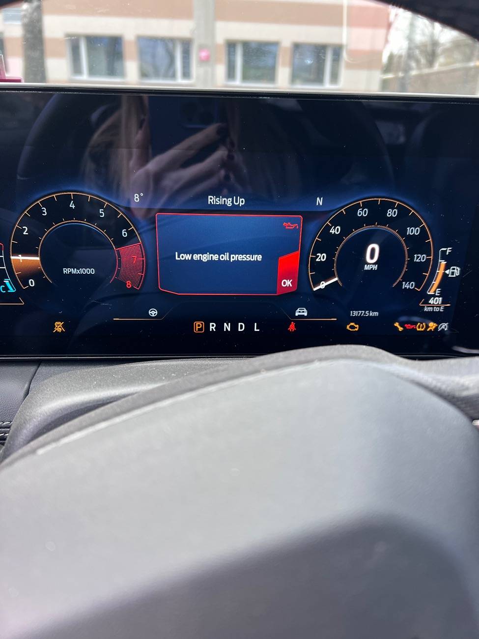

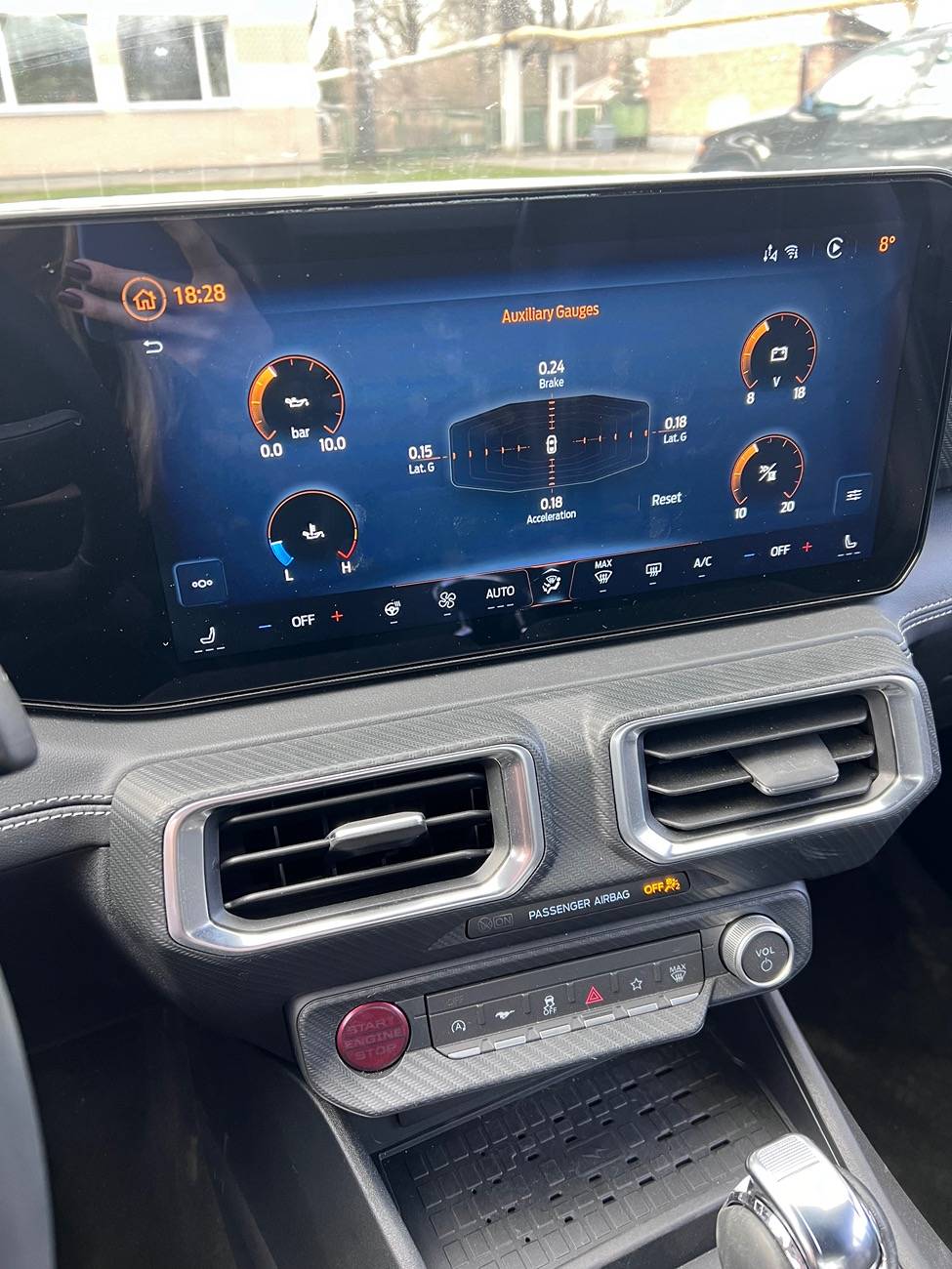

Maybe someone has encountered this problem. I am getting an “low engine oil pressure” error, although the pressure is 4 bar on a cold engine, I assume it’s ok. What can cause the error?

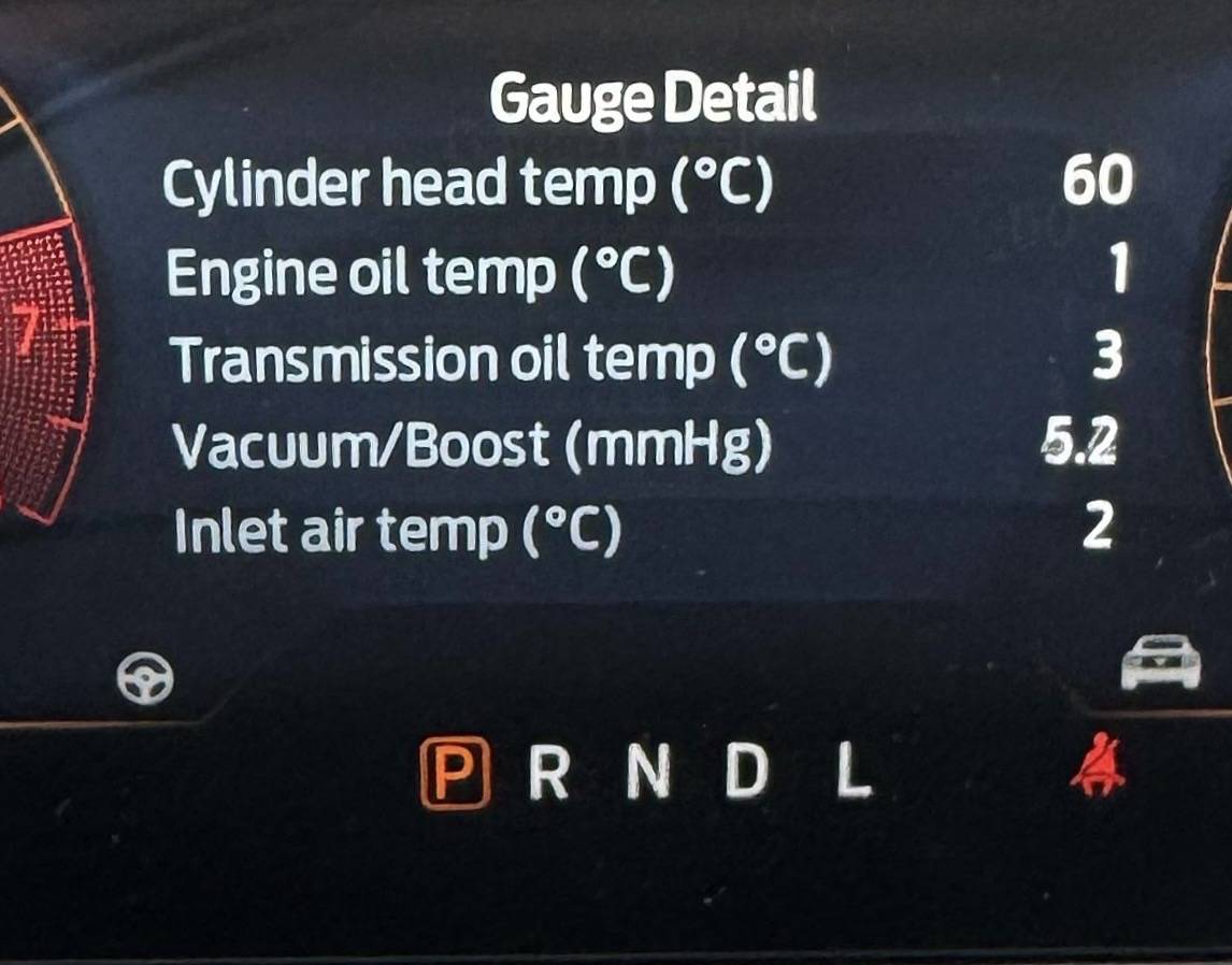

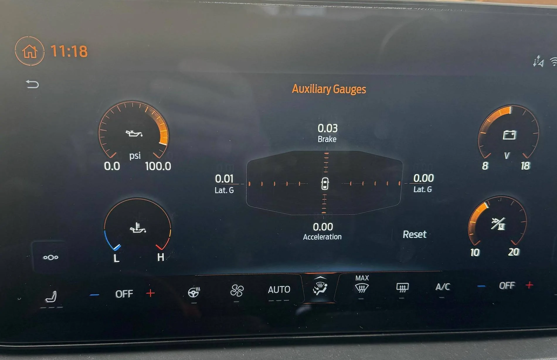

It seems that Ecoboost doesn’t show these numbers on the other dash in Gauge Detail 🙄 but I was managed to find them, it’s about 90psi on cold and the oil level is also ok. Not sure if it is a good idea to wait while engine warms up if there is smth wrong with it

For some reason Ford didn't enable the oil pressure readout in the guage details for Ecoboost models. I'm not sure why as its pretty important!
If you have Forscan you can activate it though. You need to change the following in IPC:
720-06-01: xxx* xxxx xx--
Changed from "D" to "F" to enable O.P. Display
720-06-01: xxxx xxxx *x--
Changed from "1" to "3" to enable O.P. sensor.

Wait until the engine warms up and check again. PSI is always high at start up and cold running.

I assumed your warning was coming on with the car warm, but you never specified. So when did it come on? Cold start or warm driving?
Yes, sorry, forgot to mention it. The warning appears on the cold engine.
One more important point, I didn’t use this car for several months.
