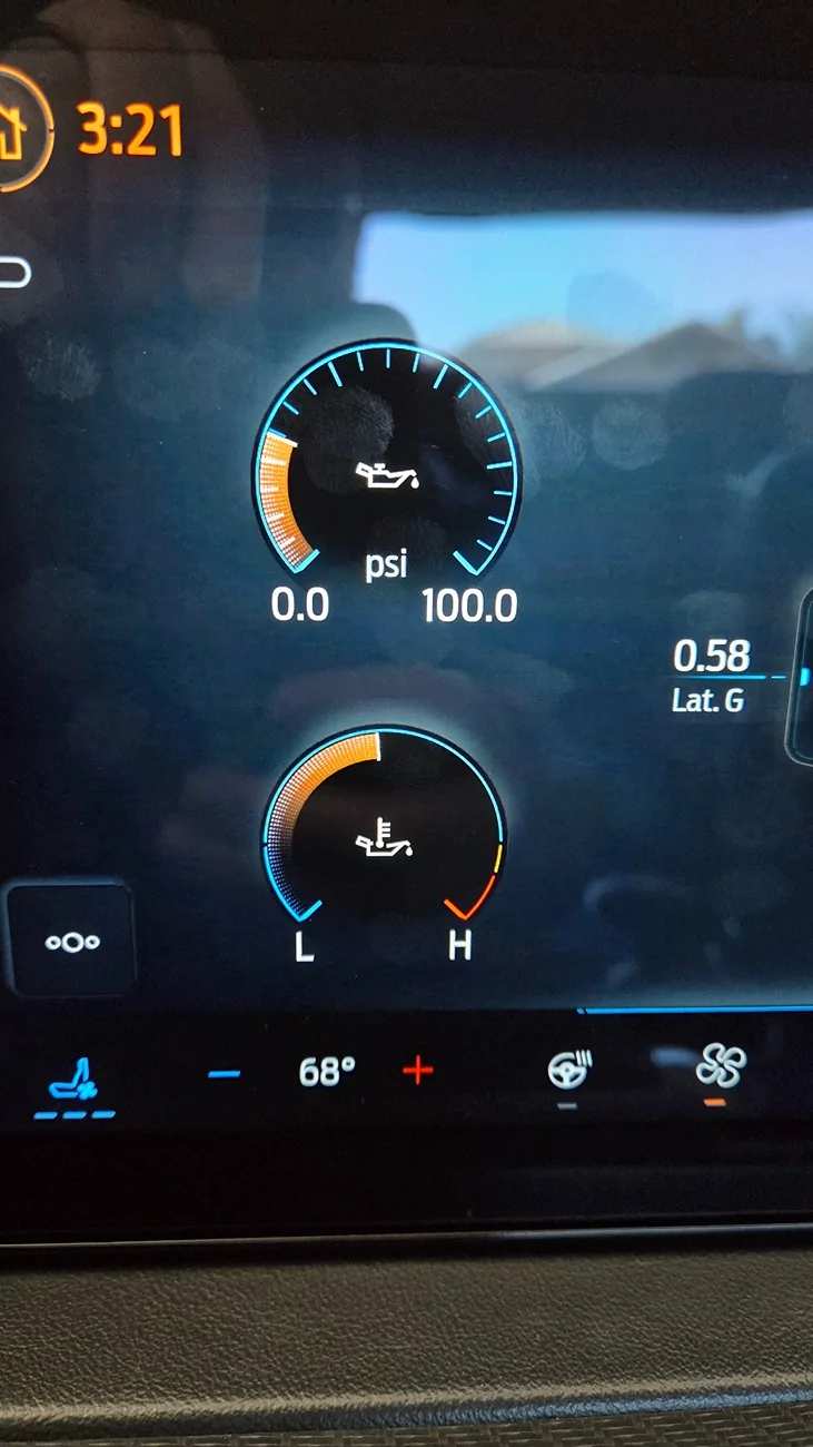

Yes they have the same numbers. But you have to look at the guage to infer the limits. This is the oil temp gauge on my track app. It doesnt have numbers but I've e been able to figure out that the yellow mark is 280⁰. This was at a temp of 210⁰.
I have been paying attention to that, too, matching the number to the auxiliary gauge, but I have not been over 224° of inferred oil temperature, so I have to get on a track or something to push it higher. I was already a candidate for the cuffs running it up to 224°

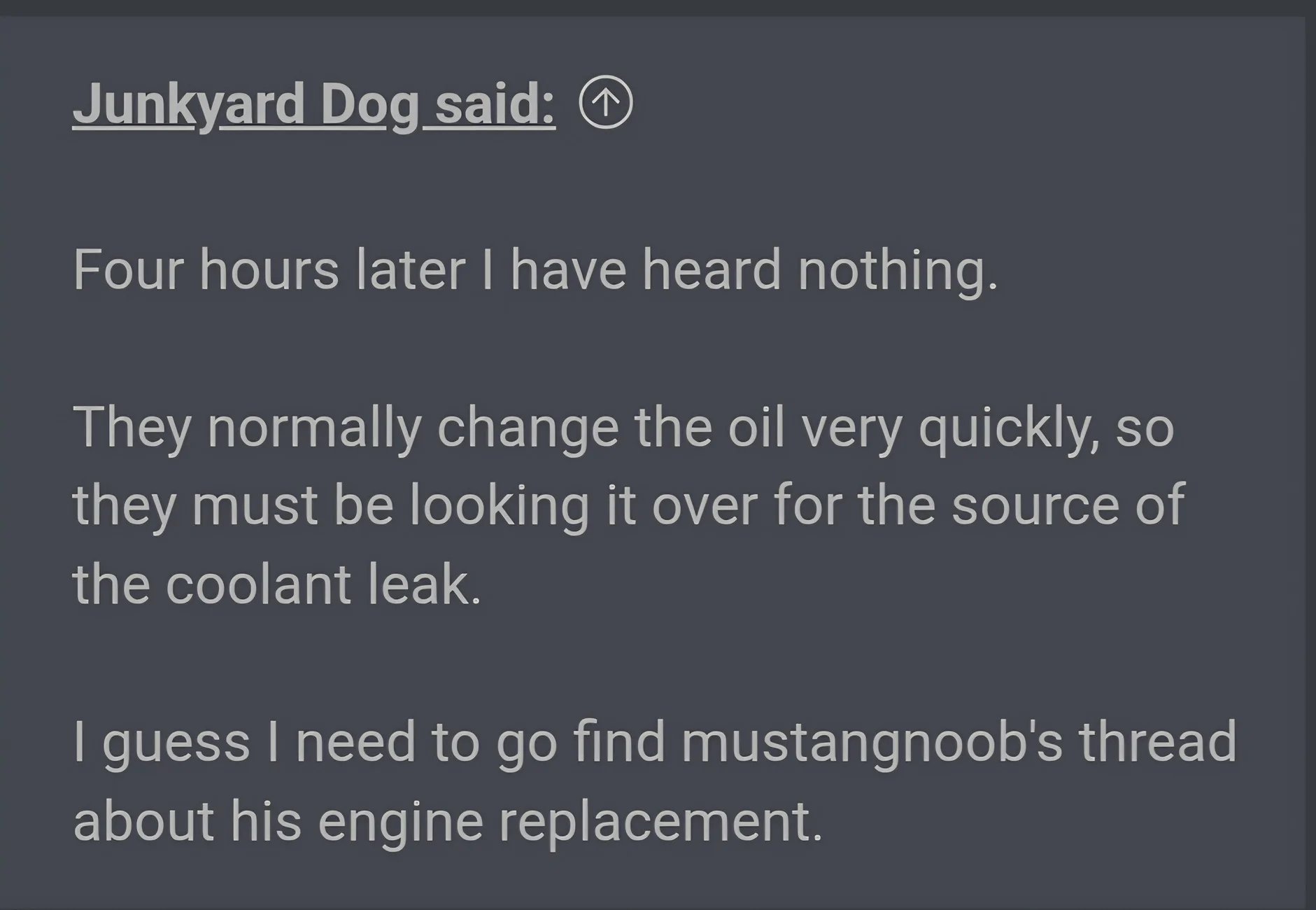

Well your the same guy who thinks he needs a new engine because you've filled up your coolant a couple of times lol. 224⁰ is nothing to worry about. Again, I really think these guages and a general lack of understanding are turning people into car hypochondriacs.
WTF are you talking about? Nowhere did I write that I need a new engine. Stop being so unnecessarily hostile and go back and read. I posted that I wanted to look for MustangNoob's thread on that subject. Seriously, WTF?
Ok. You posted on the topic in like 4 treads and I was having trouble keeping up.
S650 Mustang 2025 GT engine oil temp runs hot 17947
I took this post as you linking the coolant problem to mustangnoobs engine replacement. My bad for misunderstanding. Take a breath. Were good. 👍🏻

I managed to get it to 235° on the way home today, but it required a lot of hauling down on the brakes followed by full throttle in Track or Drag mode followed by more hauling down on the brakes followed by more full throttle followed by . . . and so on. I'll really need a race track to push it higher.
