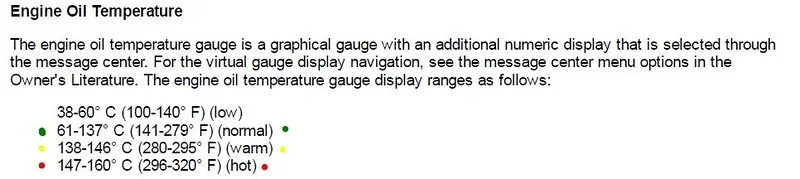

There are documented cases of S550 cars going into limp mode because of oil temperatures that go "into the red" on the gauge.
What does "limp mode" mean? RPM limit of 6,000
What temperature is 'the red'? See below.
Can someone reproduce this on an S650?
How to fix this? Add an oil cooler of course.

krisk tracks his car.
krisk recorded his oil temperature as displayed on the dash.
The temperature was higher than 280.
His car was not in limp mode.
He posted about it in this thread, complete with the inferred oil temperature reading.
Is there some limp mode tied to oil temperature (inferred) in the S650 at some higher inferred oil temperature than even krisk ran his car up to? I don't know. It is, however, false to say that it is 280, and we have a forum member here who personally did it and posted here about it. That puts it to bed.
Also, if somebody has a car go into limp mode, you need some evidence of what caused it. The limp mode may not be tied to inferred oil temperature at all.

Yes they have the same numbers. But you have to look at the guage to infer the limits. This is the oil temp gauge on my track app. It doesnt have numbers but I've e been able to figure out that the yellow mark is 280⁰. This was at a temp of 210⁰.
