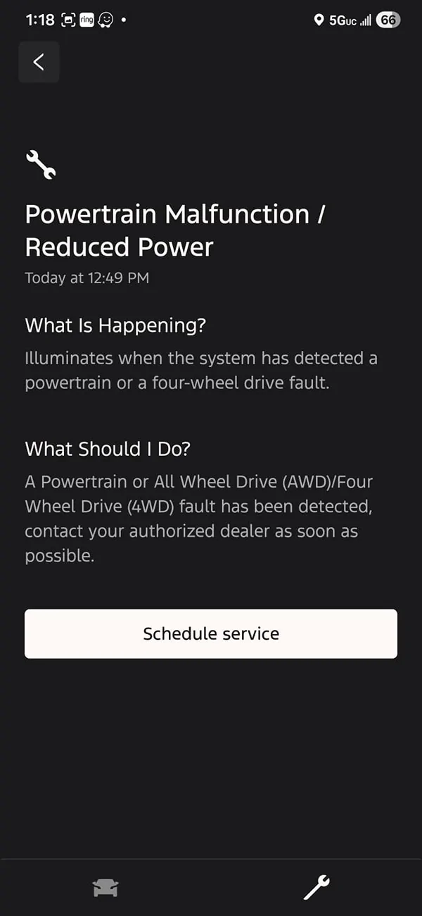

Today i try WOT for the first time after whipple installation and got a Wrench light after around 110+ mph i believe shifting from 5th to 6th im not sure because everything happens so quick i was not really looking down to the screen .
This is how i did the pull , SPORT mode Manual mode ( 10 speed btw ) from 3rd gear then i put it back to Drive to let the transmission do its thing .
and like i mention after 110+ mph it fell in it's face and threw a Wrench light .
Car runs great no codes where detected , i turn it off then back on and the wrench light was gone . What could be doing that ?
i didn't hit the rev limiter because again the transmission was shifting by it self .
Car still has the stock CAT's with just an H pipe and Active Exhaust .
I try again just to confirm and it did it again . So it was not a one time problem .
Could the Ford Performance stage 1 be limited to 130 mph ? im not sure im new to the Mustang eco system .
Feels like it fall's in is face around 130mph .

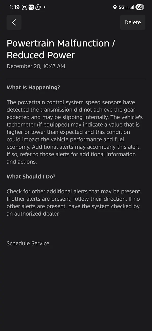

seems like it does , ive try it and only close to 140mph more like 135 mph throws the wrench light no stored codes or anything . Only in Ford app says something about the transmission not reaching desired gear .

tooner
2025 ESS G3 Mustang GT
sounds like IPC tq error. Common if the tq tables arent right for the power level. Easy tune fix. Just have to tell whipple and see if they have an updated rev for you.
